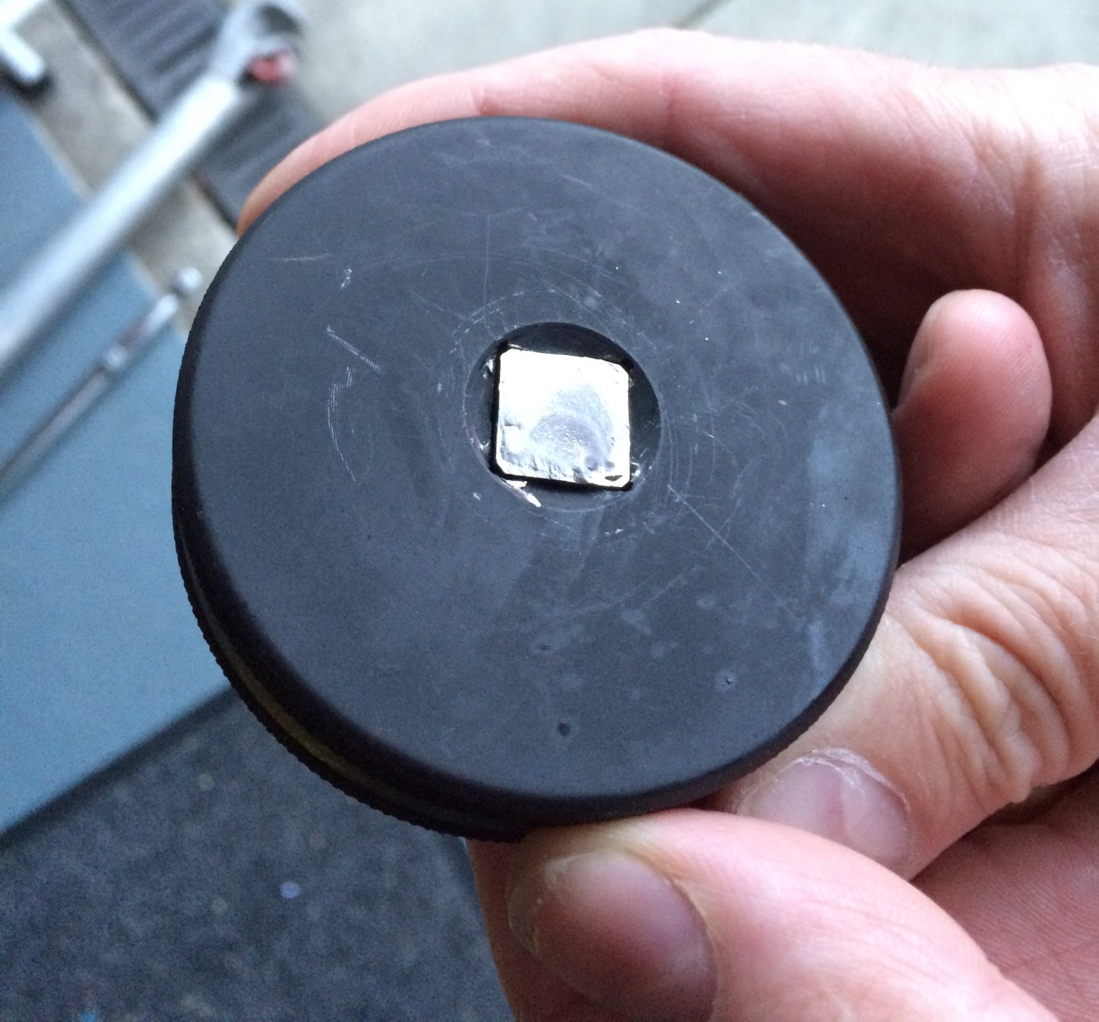

  12. I'm currently attempting to remove the XDiavel rear wheel. The 1199 is easy in comparison. Yesterday I broke a 3/4 knuckle on a breaker bar and today I broke a 3/4 to 1/2 inch socket. Used all the techniques described here but it won't budge.
  13. Double Wow! I've got the Clarke impact driver, and it zipped the nut off my M12R in a couple of seconds. Yours must be welded on!! Perhaps try some heat on the nut as this seems to work in most cases... good luck with it, and let us know when/how you get it off
  14. You bust the 3/4-1/2" using the impact wrench? Maybe use the Clarke with an 1/2" impact socket and no adapter?
  15. The 3/4 to 1/2 adapter was bust by hand as was the 3/4 knuckle. I went through the same rigmarole with the 1199 first time round however when using the same tools / tricks as now I was able to get the 1199 nut off.
    I've used the laser tool linked earlier in this thread and the socket to that has started to distort as has a cut down draper chrome 3/4 55mm socket.
    I'm going to try another 3/4 socket tomorrow but I'm reaching the point where I'm not comfortable with the force required. I'm using a 3/4 39 inch breaker bar with a scaffold pole just under 2m in length over the top of it.
