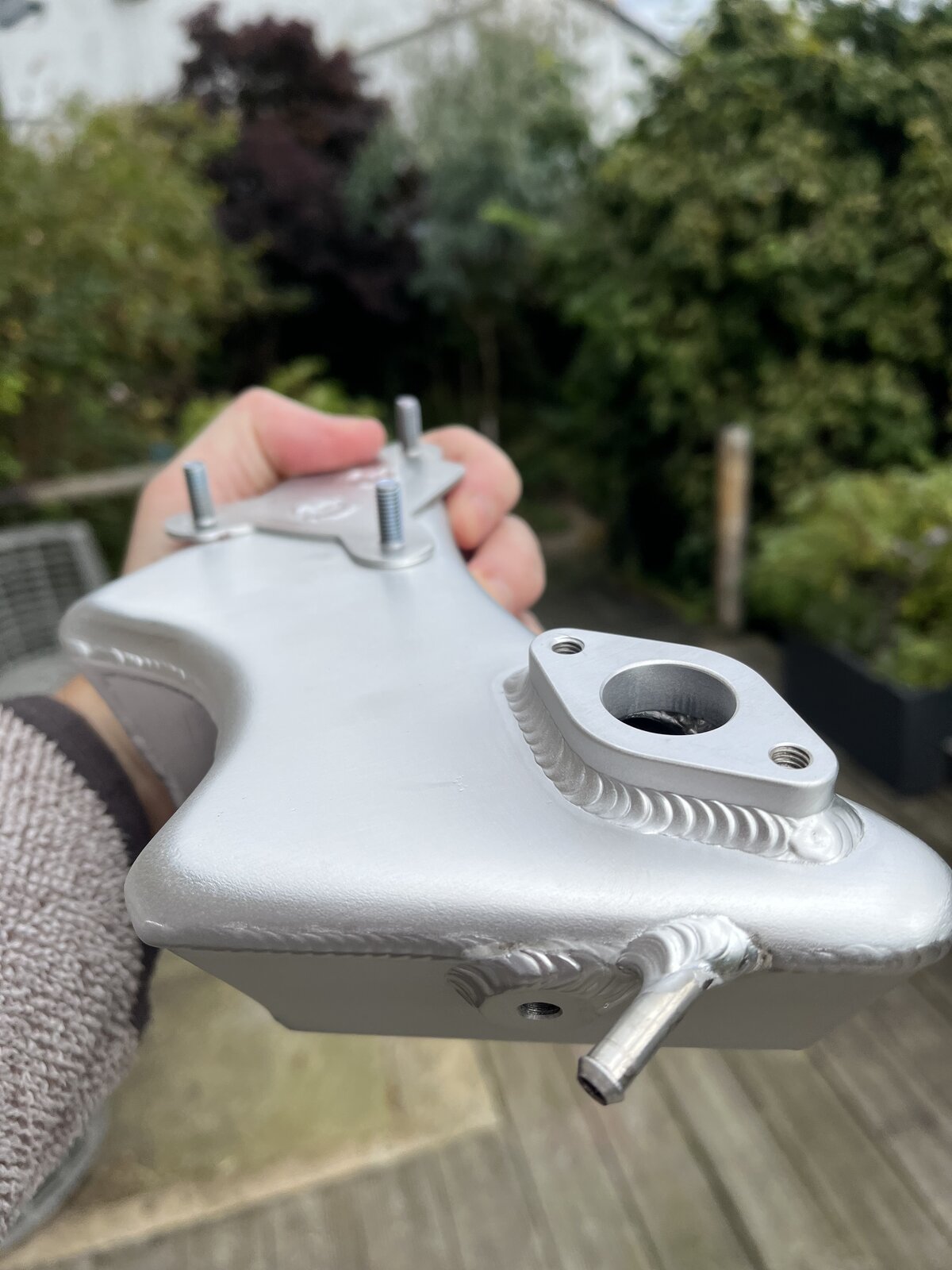

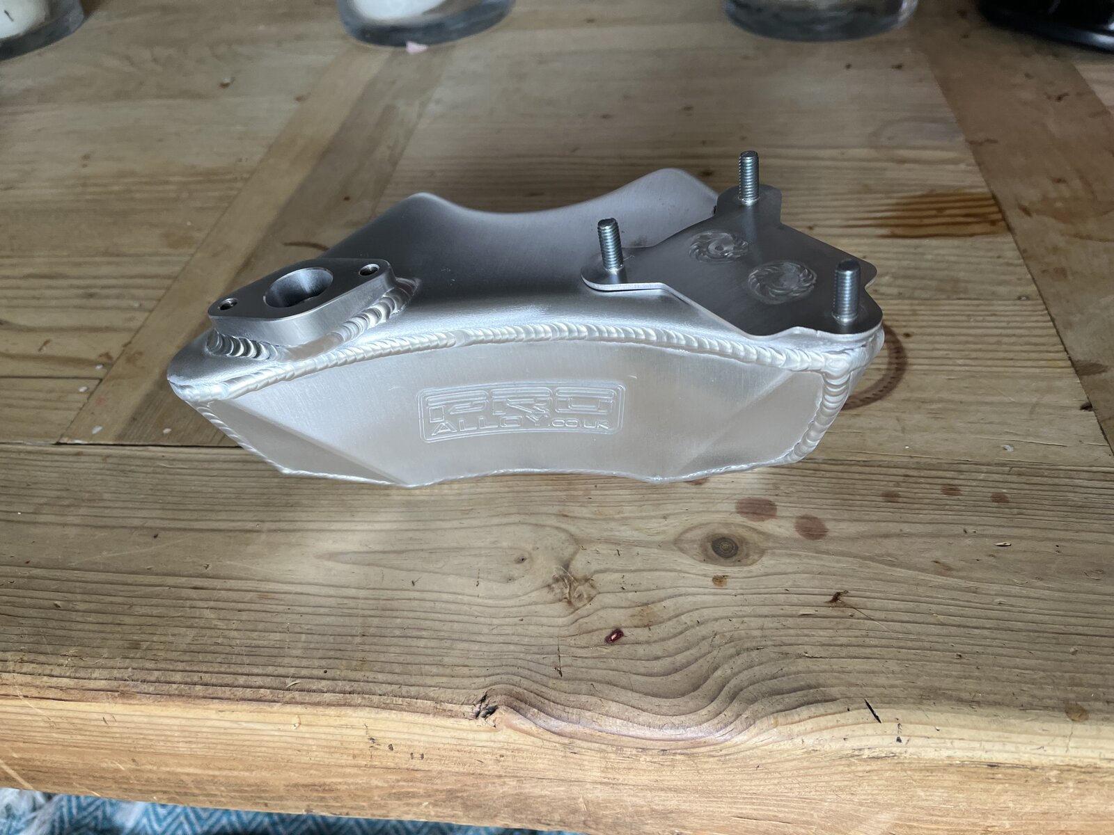

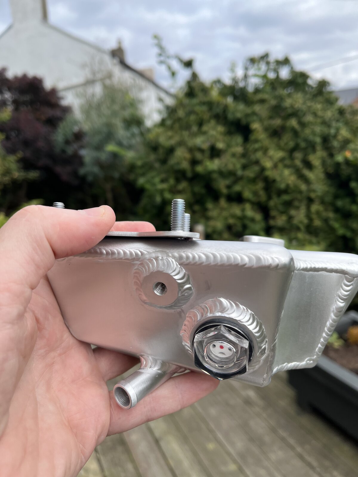

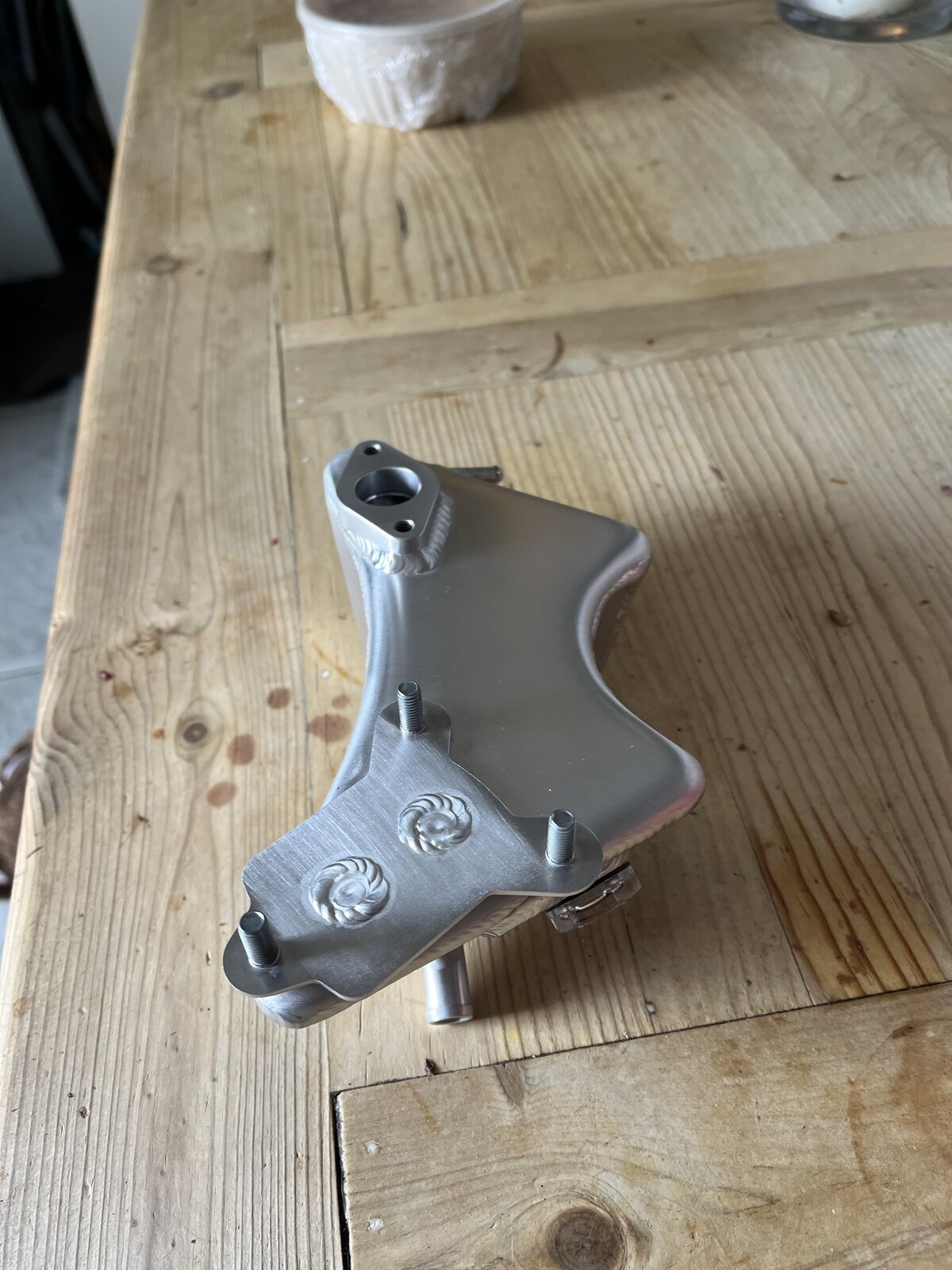

  1. IMG_8439.jpeg IMG_8440.jpeg IMG_8441.jpeg IMG_8442.jpeg Took the plunge a while ago when the proalloy replacement 916 alloy header tank was announced. It took a while for it to be made as they wanted enough orders to make production worthwhile. It’s just arrived & looks lovely , too nice to hide under the tank ? Anyways hope to fit this weekend as last time I rode my 916 it was doing an impression of a steam kettle from the original header tank

  2. @Macca

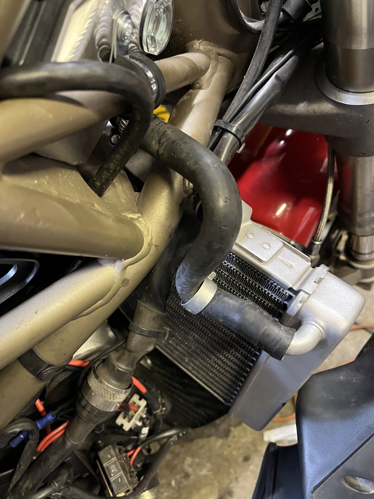

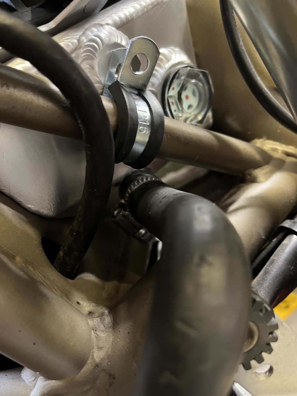

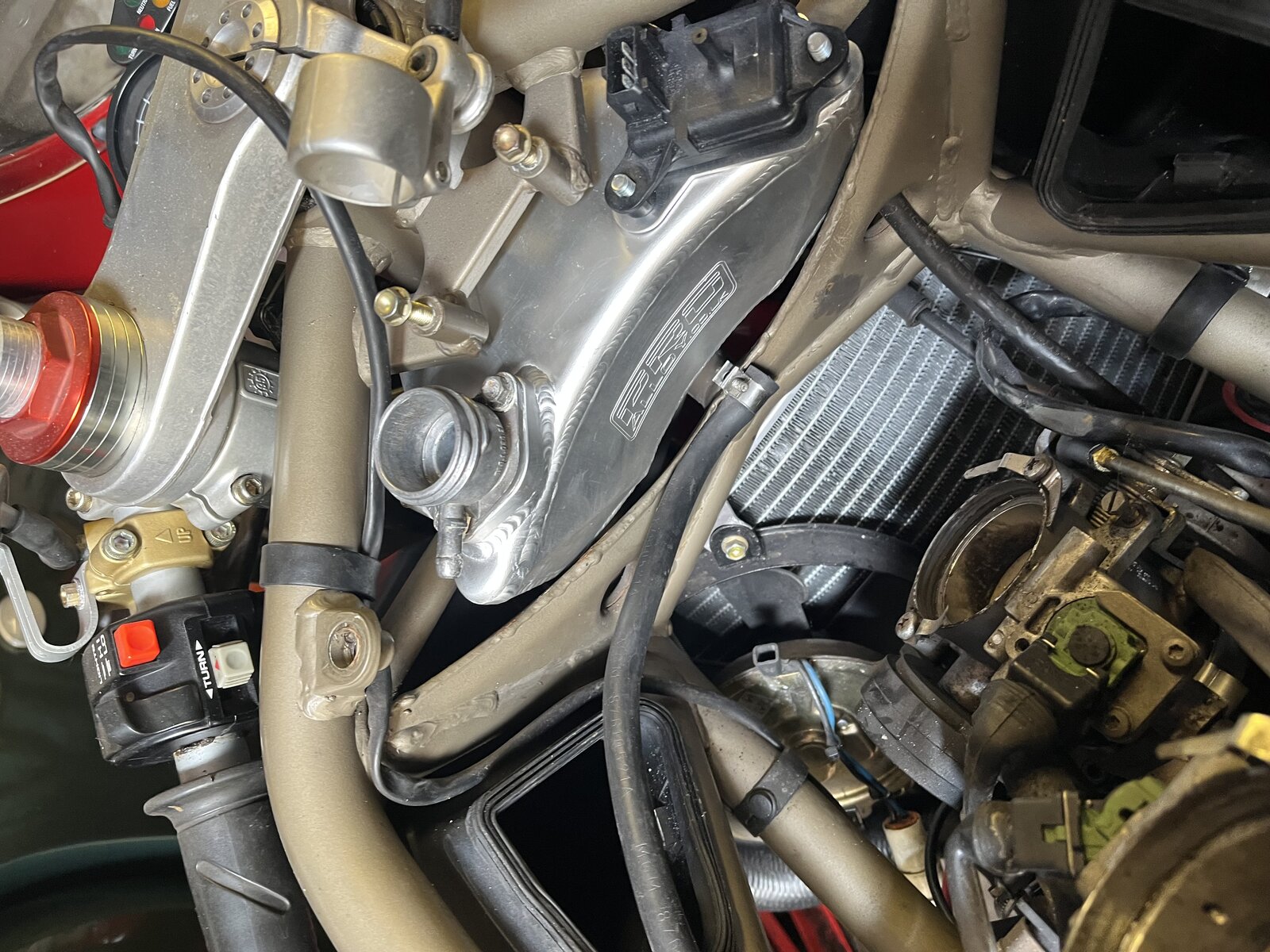

  5. IMG_8448.jpeg IMG_8450.jpeg In the middle of fitting the tank . To get the old one out you need to remove seat, tank, airbox & I removed the ignition switch. To fit the proalloy the air filter pipes also need to be removed to get access to the RHS hose and clamp. It’s also a bit fiddly getting the tank in and takes a bit of twiddling the position to get in, mine was tight getting past the lower frame brace and needed a gentle tap with my hand , you also need to swap over the air temp sensor & filler neck before attempting to fit & place tank mounting P-clips on frame rails in advance as you won’t get them in easily after proalloy tank is in place.
    I’ve hit two snag’s sofar
    1st is the air temp sensor was very tight going over the tank studs , so doesn’t need nuts to hold in place & the front most stud fowled the frame rail, destructions say leave this one’s nut off until fitted. As my temp sensor is now a press fit I shortened that stud to clear rail, & will fit nuts to the two other studs in case vibes walk the sensor of the studs.
    2nd is the rear cylinder hose to the front of tank is too short on mine to go on the pipe on proalloy tank as it faces forward instead of sideways. As my overflow pipe is longer im going to try swapping these over for now. Onward & upwards.
    My pipe swap seems to have worked & I wonder if PO had fitted these in wrong locations when they rebuilt this 916 ( it had been apart & a few issues with reassembly were found by me not long after purchase)
    Final leg found another couple of snags. Clearance around the tank is tight, so water pipe jubilee clamps have to be oriented in specific ways to avoid fouling frame etc & be able to tighten/release.
    RHS hose to radiator became crushed when refitting the air filter conveyor, it looks like the proalloy tank pushes that hose further out to the right. I fixed it by shortening it 1/2” at the end for the tank fitting. This one is awkward to tighten the Jubilee clamps& I arranged it so I could tighten from front of radiator . So now all fitted & ready to button up until I spotted a snagged o-ring on my fuel tank fittings which has paused proceedings until I get a couple of new ones :/

  9. True craftsmanship !

  11. I did want one. They look to be really well made and follow the originals design rather than the solid box bunkers
