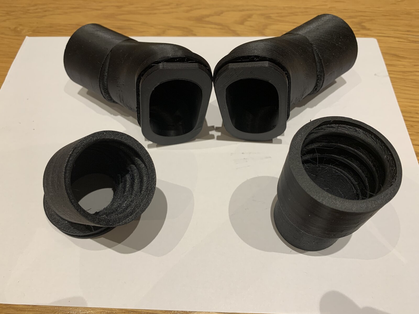

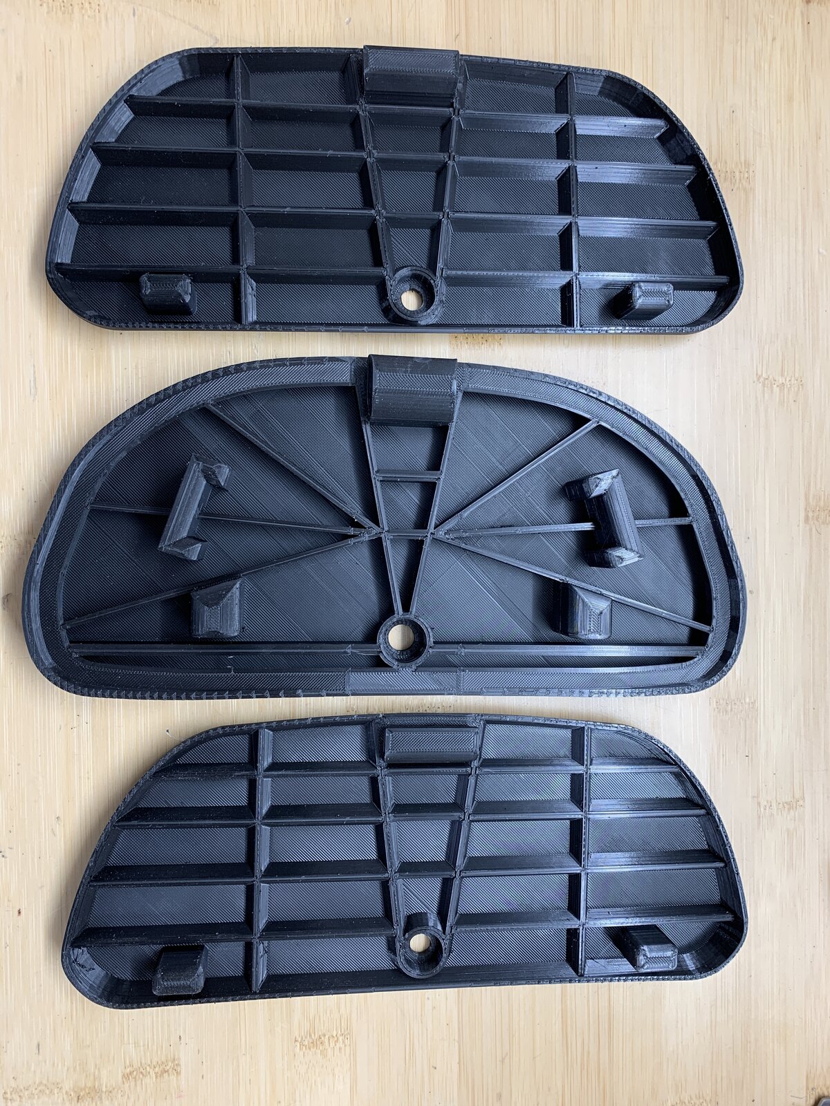

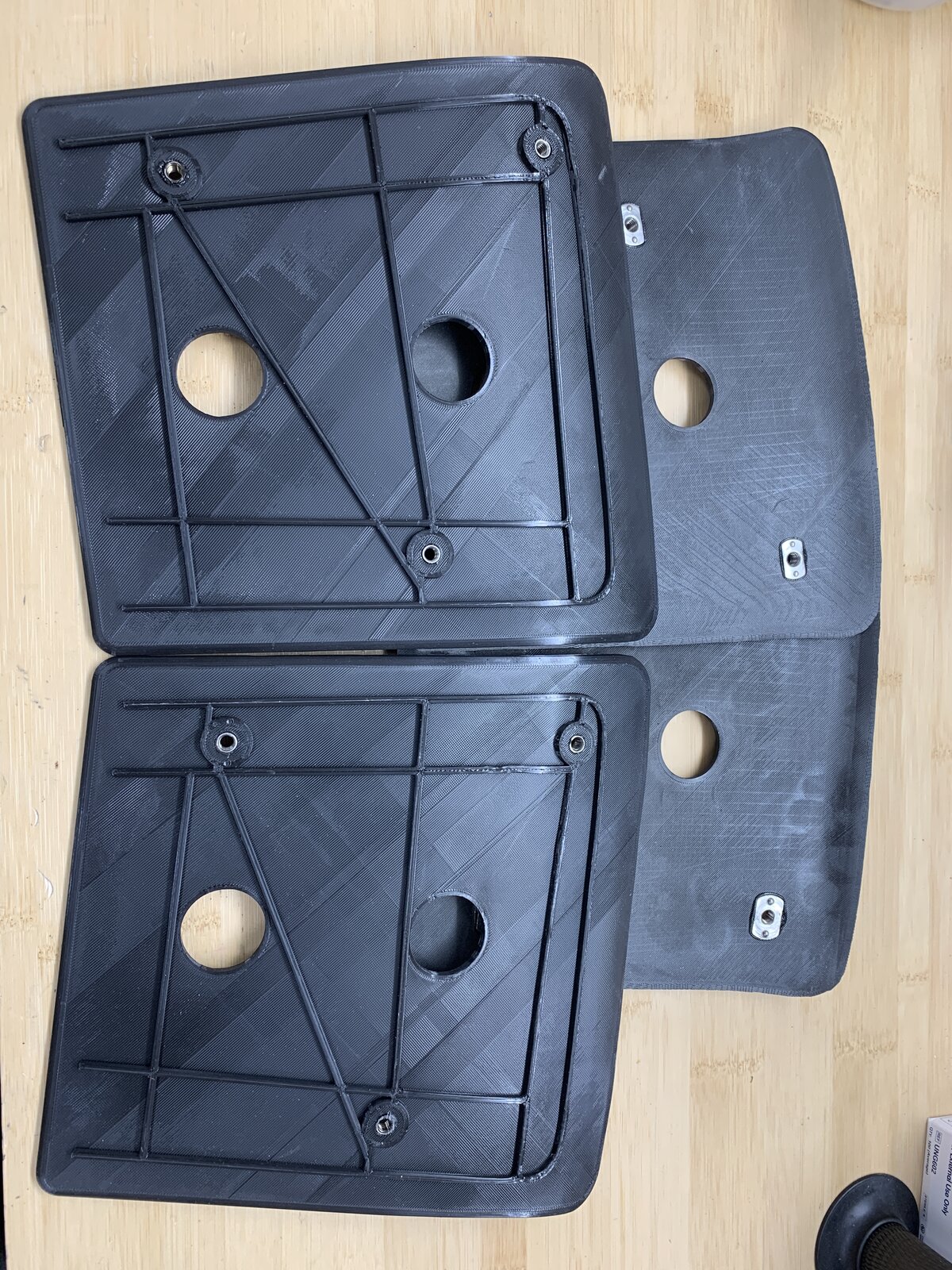

  5. I have been using PLA+ recently for the bases and TPE for the flexible rubber air ducts. The rubber ducts have a nice satin finish and the layers are less visible. The photos below are the following: -
    • 2 x 888 bum pad bases and 1 x SP3 bum pad base (middle)
    • 4 x 888 SPO/SP4/SP5 main sead base
    • Front and rear air duct connectors (the oval ones are the 1994 model airbox connectors that enter the airbox at the front sides, rather than the rear entry version)

  6. If you use ABS for your FDM printing, Methyl Ethyl Ketone is an excellent solvent for smoothing the exterior and also reducing porosity and produces essentially a glossy surface. Sometimes just the fumes are enough to affect the surface. Unfortunately I have no experience of using PLA.
  7. ABS is too brittle for the parts I have been printing, as a staple has a tendency to crack them. PLA+ has a decent finish and also takes a staple nicely. It is really nice a tough, plus has a bit of flex, that ABS lacks.
