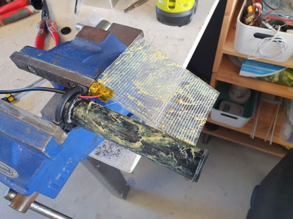

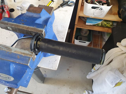

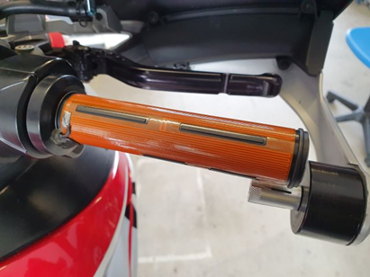

    First step is to remove the Ducati rubber grips to reveal the heating element.
    RH grip showed below

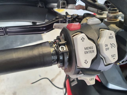

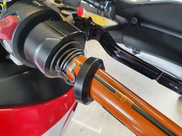

    I could not easily figure out how to remove the entire throttle tube so did the rest of the mods with it on the bike. You need to pop loose the small plastic cover ring on the LH to gain easy access to the wiring (see pic below) – These wires need to be placed so that there is a bit of movement possible so that twisting the throttle does not overstretch the wires – there are some plastic ‘bungs’ welded/glued to the wiring to keep it in place
    The LH side is much easier with the whole grip removable after undoing two screws top and bottom.
    (LH completed grip shown but note the screws with one facing up one down)

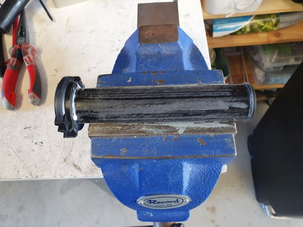

    I then removed the OEM heating element by cutting / pulling it off and de-soldering the wire connections. I filed off the plastic ‘ridges’ on both tubes to create a better surface to glue the replacement heating pads too.
    On the LH grip it is easy to use the new wiring supplied and to thread the new wiring through the grip and then to solder them to the existing wiring somewhere accessible at the handlebars. On the RH I decided to keep the old wiring intact and soldered them to the new heating pad as close to the crimped connectors as what I could. (Don’t try to desolder the wires at the crimped connections since this heats up the metal which will cause it to become undone)

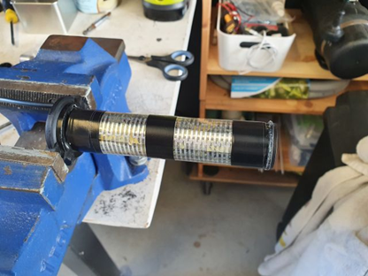

    Contact adhesive on both, wait to dry, wrap around and stick in place with the supplied ‘heat resistant’ tape.
    I then used some more contact adhesive and then heat shrunk the supplied heat shrink on

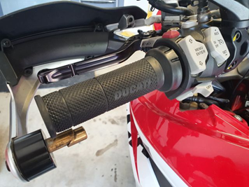

    Fit back on bike, use some hairspray to put rubber grips back on and Bob’s your uncle!!
    Temperature as measured stabilised at about 48 degrees (measured just above the A of ducati on both sides). We will see how they perform on a much colder day

    You were very wise not to try to remove the throttle tube. I did and of course the return spring pinged out of its end slot. I spent a frustrating hour trying to get the spring end back into the slot on the clam shell but failed. If anyone is in this situation undo the wire bundle rubber wraps containing the throttle messenger line. I found there was just enough slack to slide the throttle sensor ring off bars. That then gives you much easier access and it's possible to get the return spring pretensioned and the clam shells around it with the throttle tube in place.
