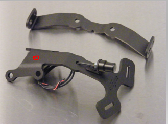

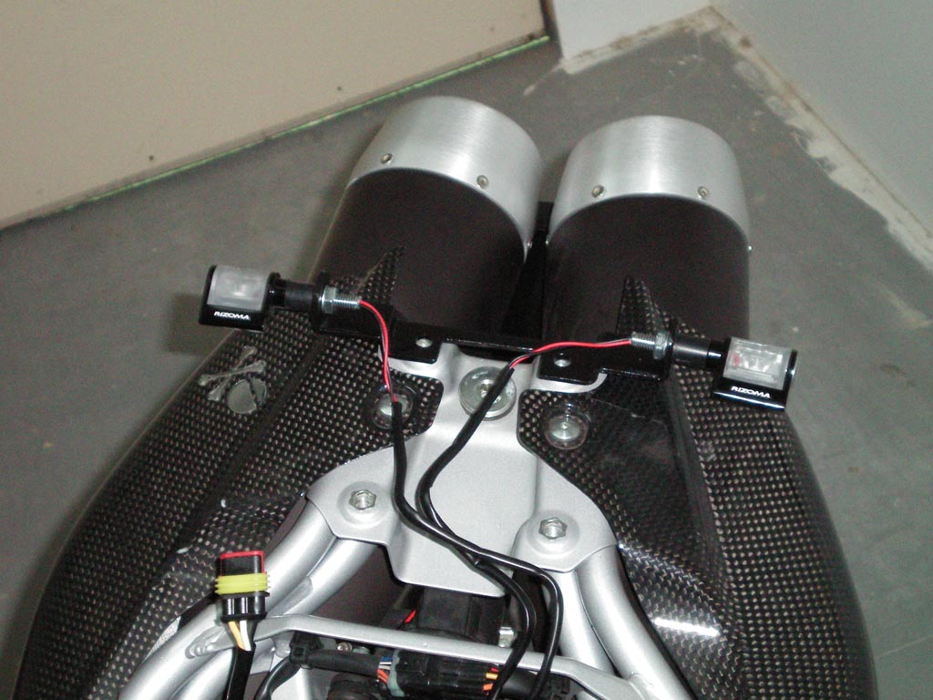

    IIRC (and sorry for being so vague) where I have marked in red, is where I recall drilling a hole - as the 4x bolt holes you see, would normally attach to the OEM exhaust - you lose those when you take off all the old can's gubbins. I'm 95% certain that somewhere in the rear, maybe under the fin cover, there was one large silver bolt - I used this to attach the bracket and tightened up a nut whilst holding the number plate bracket.
    The indicator bracket can be mounted with the bits up or own - if you look at the photo here you can see I mounted it upwards - this is so the indicator clears the exhaust.
    Hope this helps...
