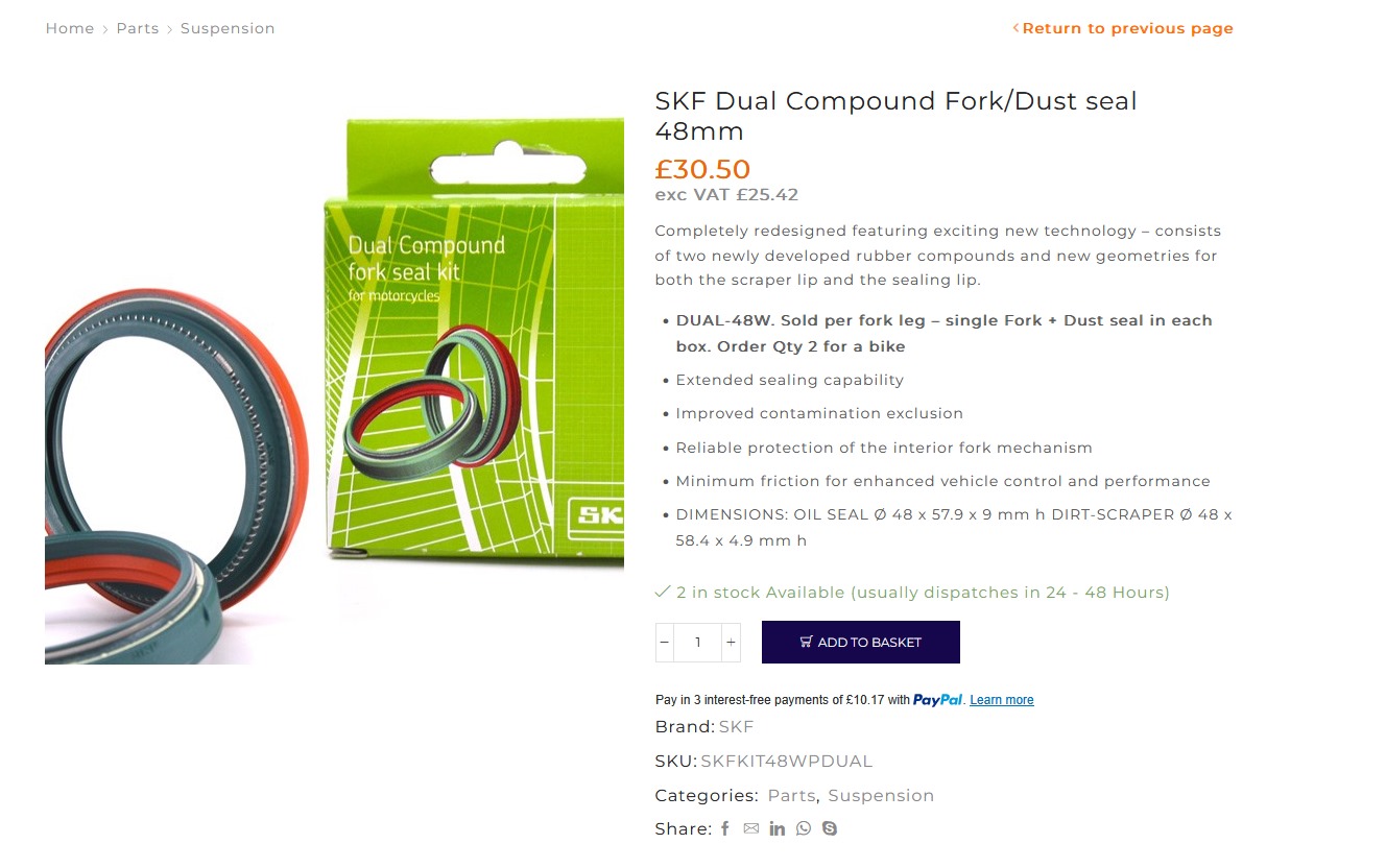

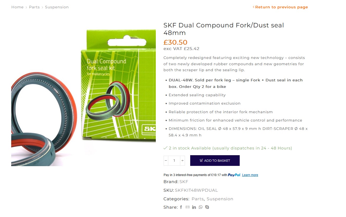

  5. Has anyone mounted those on their forks?
  6. You’ll not go wrong with SKF stuff.
  7. I've sent some emails to see if this new model will fit my forks. the description says 48 mm. I believe it should.
