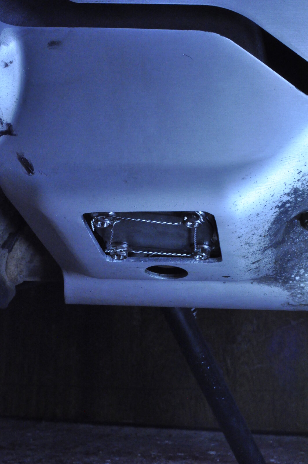

  9. O.K, it turns out the sump bolts were T30 and not Allen head bolts.
    I dont know which is standard but never mind. Instead of relying on slotting the rear mounting holes, which i have done anyway i decided on a better solution.
    I turned the 4 bolt holes into this single access hole.
