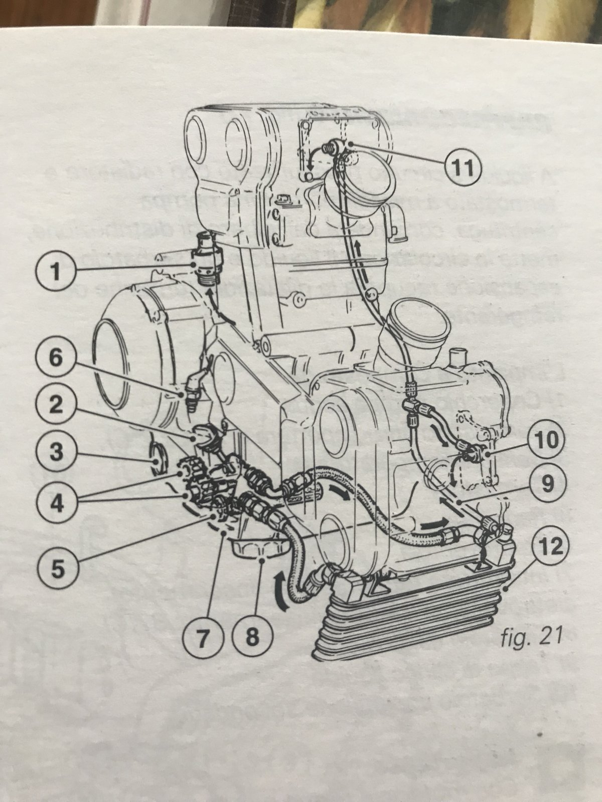

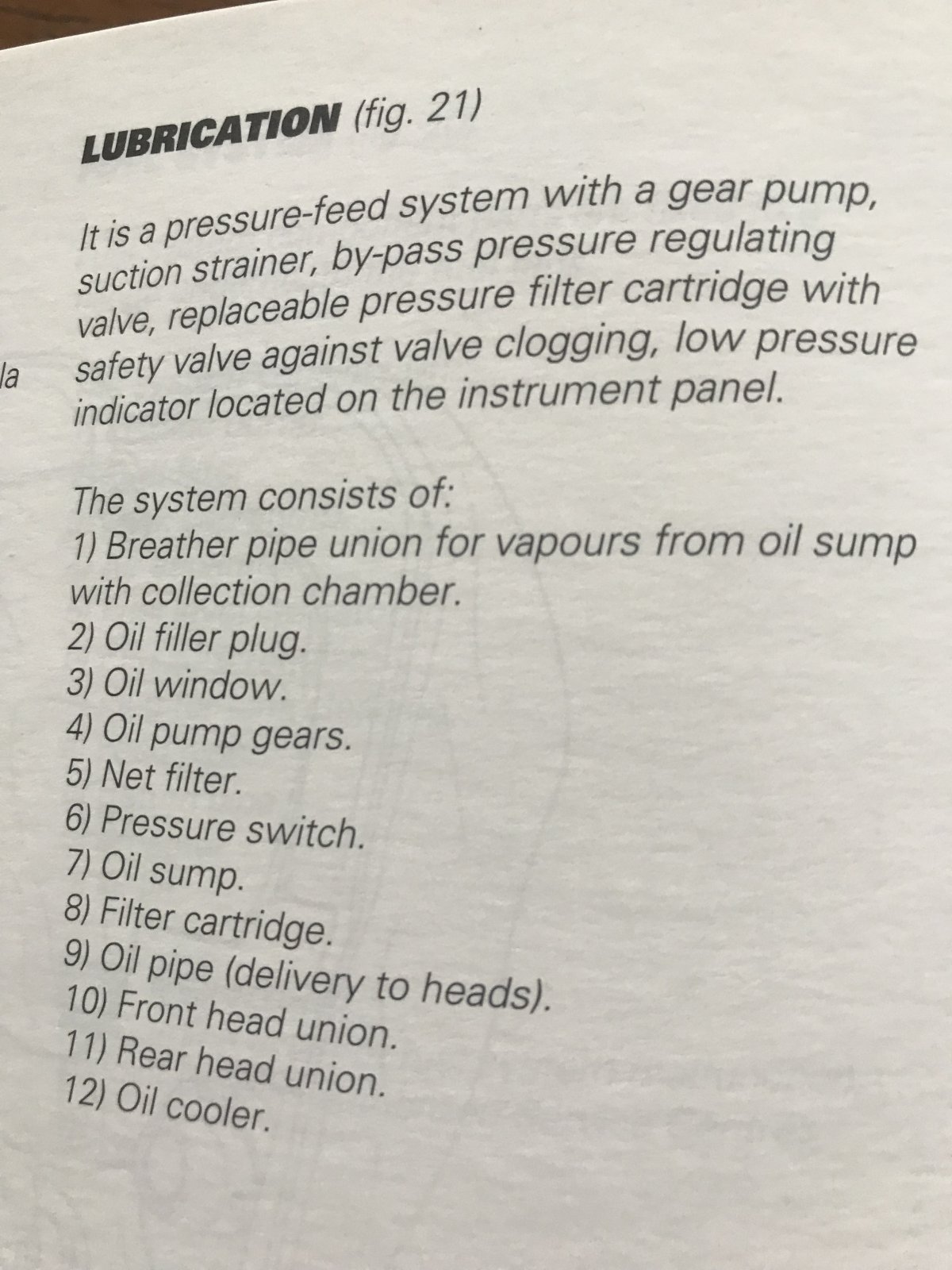

If the oil wasn't being pumped through the oil filter and the system then the oil pressure light would be on as the pressure switch is in the mail oil gallery!!
Sorry to be cynical , if you unplug the connector to the oil pressure switch. Then see if oil light comes on? Proves switch is working.

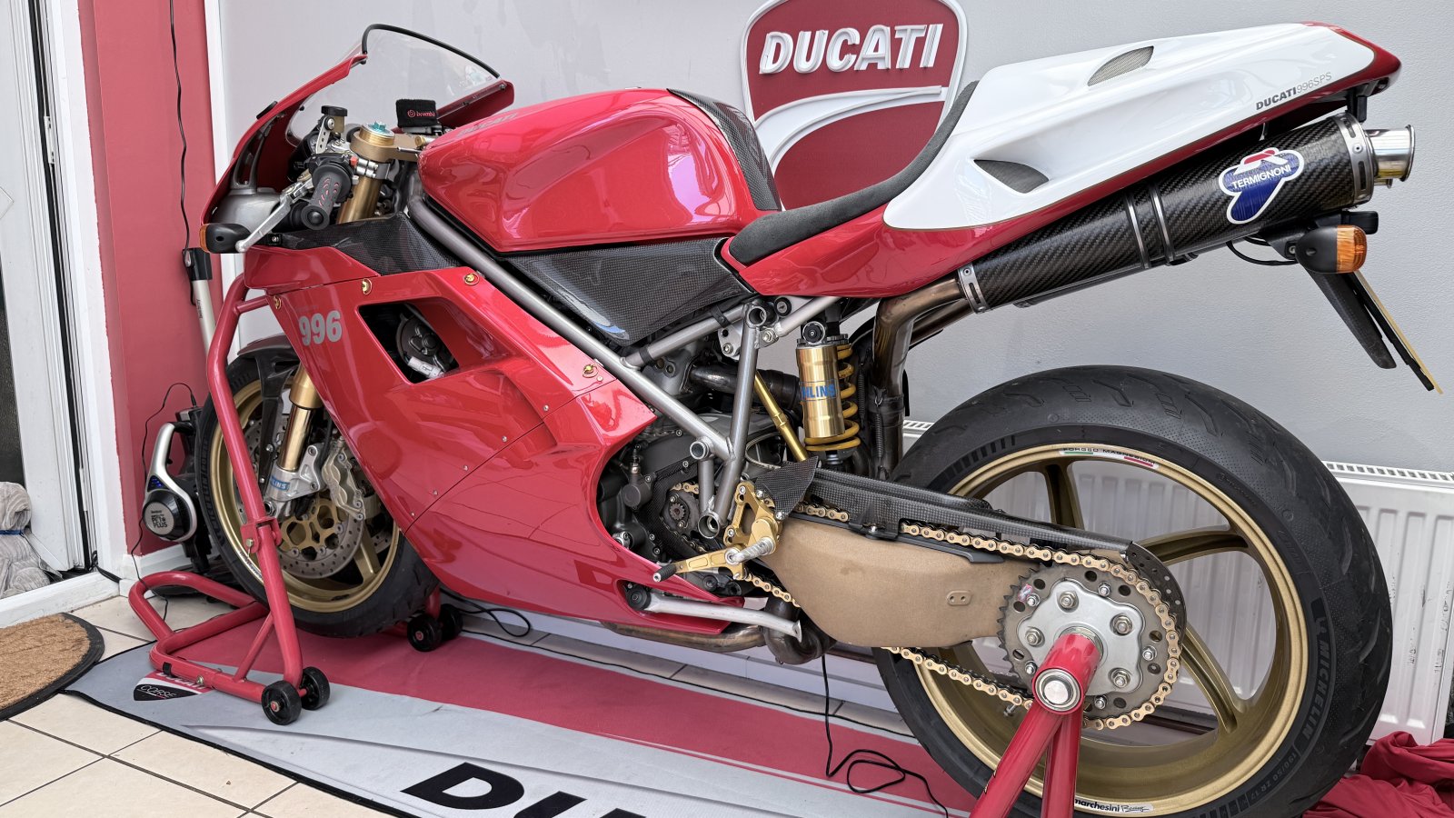

Hi there, I’m thinking about doing just that tbh. I’m trying to ignore it at the moment but as I don’t actually ride it out, I can take the time to see what’s going on. I can’t see how it’s normal for the oil level to not go down at switch on/start up! Anyway, a gratuitous pic!!
Nice pic!! Never thought to ask if the oil light illuminates when the key is turned on and that it goes out when the engine is started...!!! Surely thats been checked? If so then the switch is clearly functioning!! No further investigation needed. Just start, ride and enjoy.
