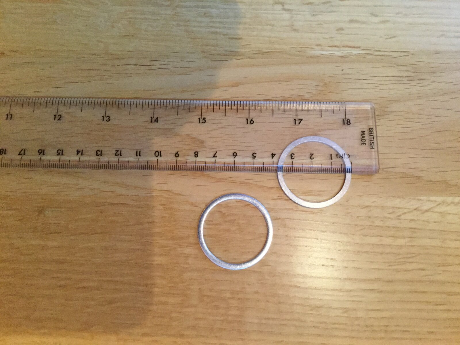

  4. 7070D856-D790-41B6-A540-1E70FA5DAB93.jpeg Are these them? 38mm od? Years ago I had a 748R and I have these still knocking about, along with some of the tiny green o rings for the qr fuel connectors.
  5. I think they are the bigger ones for newer engines part no 85250051A
  6. Just an observation from the picture.... it shouldn’t have a copper washer on there for a start, so anything is possible. Ducati have never used a copper washer on there. The alloy ones do get stuck on there as the sealing interface forces the alloy to distort. They’re also a different size to the sump washer but they’re close enough to get mixed up.

  9. They're the same size alloy washers as fitted to the Bevel twins and singles dip sticks and sump strainers.
    I've got dozens of them if you're still stuck mate.
    In the past I've bought them 10 at a time from JHP's. These days the Bevel spares dealers tend to bung a few in as freebies with whatever I've ordered.
