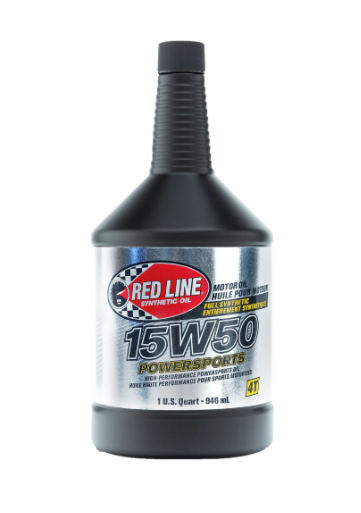

  1. After much deliberation and with the first oil change looming, I decided to plump for this fully synthetic 15w50 oil from Redline. IMHO and from what I have read, including oil sample analysis data, it's the best compromise for a street based bike for UK temperatures and for extra protection during cold starts when the bike has been stood for a while, owing to its PAO and Ester base stocks and 2200 ppm of ZDDP for antiwear, so that the oil tends to cling more to bearing surfaces as well as holding its viscosity over time.

  5. Test data was from "SpeedDiagnostix" as published on the US forum, comparing three of the most popular oils. Ultimately any decent off the shelf brands of the correct grade for the climate (15w50 typically in the UK), ie, Shell, Motul, Silkolene, Morris, Motorex all do a perfectly adequate job.
    However most "stock formulation" 15w50 API oils or manufacturer recommended oil such as Shell's Advance, fall short of the extra benefits a group 4/5 Ester based oil offers, which typically contain ideal levels of Zinc & Phosphorus (1400-2500ppm) and lower levels of Calcium (1000-1800 ppm). These types of oil, (as is my understanding) offer better wear protection. Redline is not the only option ('Maxima Extra' 100% Ester Synthetic being another)
    There are also others which offer even better performance (such as Motul 300V) BUT have a very short protection working life (600-800 miles, so probably better suited to a track bike or if frequent oil changes are not a deal breaker for you). Ducati themselves, promote a "Shell Performance" oil for dry clutch V4's, that has a similar limited lifespan.
    I am by no means an expert on this subject, just decided to choose a product that is likely best suited to my usage of the bike.
