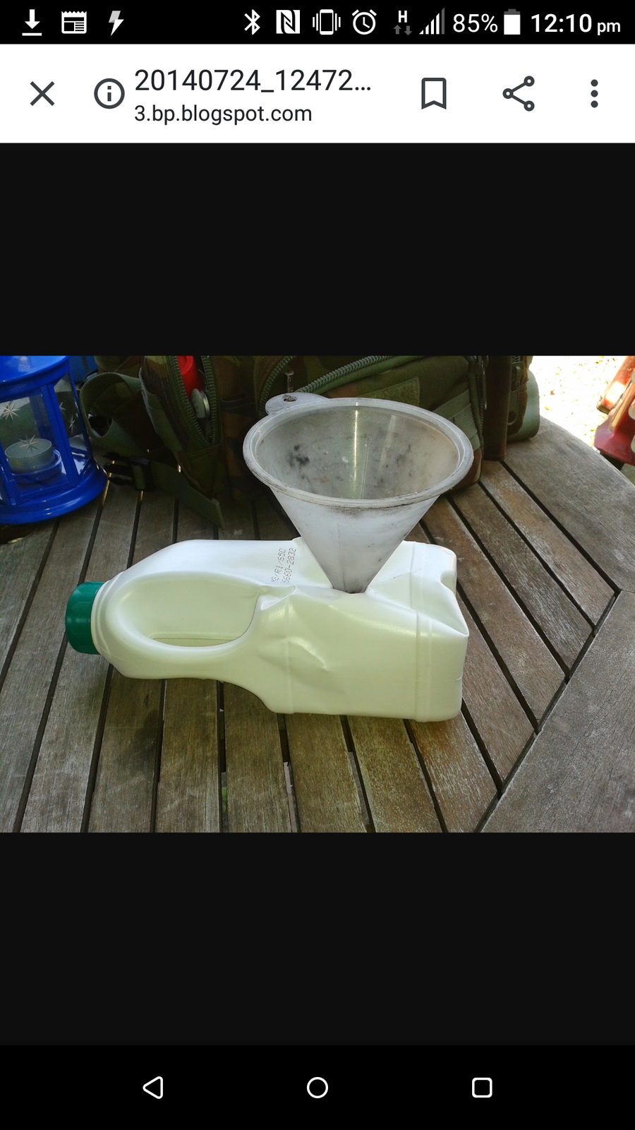

  6. 6 pint plastic milk containers laid on its side with a large hole cut out works well. Just remember to clean first and put the lid on before letting the oil out.
  7. Like this but bigger Screenshot_20191008-121058.png Screenshot_20191008-121058.png

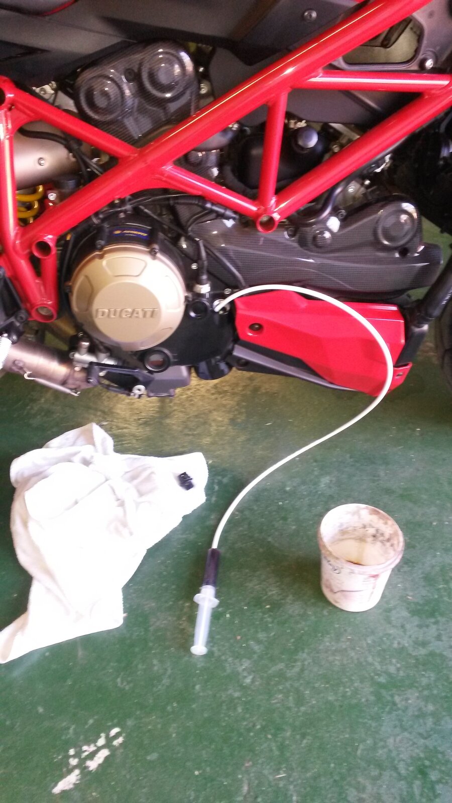

  10. You can draw oil out of the filler cap as well. 6mm pipe on a decent size syringe. Cleaner and more accurate if you've just got a little to take out.

  13. The missus get upset when I use the cat litter box when changing the oil... your plan looks like a way to avoid marital strife :)
  14. Yes ...
    ..... my favourite method
    Get two of them ..... one for a drain pan and one to tip it into , for saving or disposal .
    No funnels to clean , and the local waste disposal has a place for used oil and another one for oily mess ..... easy life !
  15. each to their own on that one, been there, done that, permanently stained the floor/drive as oil brims funnel because air can't get out*, also no need for a funnel/extra height with a tray but appreciate the ease of obtaining a milk container unlike a tray or syringe for that matter. (you could go the whole hog and syphon with a small bore clear tube even)
    *it doesn't happen everytime but a second hole in top of milk container will prevent this.

  16. I'm with Nelly on this one, Get a syringe and a rubber pipe ( make sure it doesn't drop off in the gearbox, and suck out what is extra, saves breaking in to the system and it also allows you to measure quickly how much more oil was in than you needed.
    i just had a similar task a few weeks ago from a main dealer and a mates 999s track bike, the dealer filled the bike as per the amount ( ltrs) rather than observation of the Oil glass. i took out 700 ml of 300V to get it to show on the glass..
  17. To conclude:
    managed to extract the overfill of oil using a syringe, worked well, easy to extract amount of oil
    took more than 100ml out
    also cleaned out the air box and the air filter, they were not too bad but did it anyway
    Will go for a run later today and see how it works out
