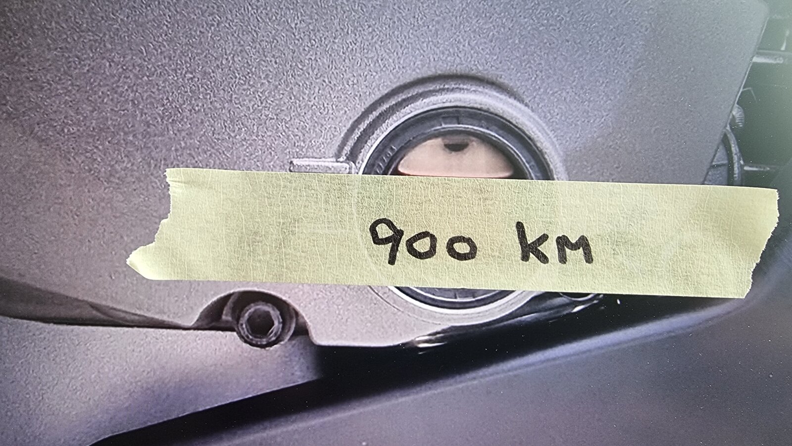

  8. I have checked the oil level after 900 km. Mostly canyon carving at a good pace.
    No signs of consumption on these kilometers.
    I will measure regularly, and update continuously. Oil change will be carried out at 5000 km.
    The Multistrada is placed on Ducati depot supports at the rear, and on blocks at the front that correspond to the exact height at the rear. Then I have leveled it up sideways, so that it stands exactly the same at each measurement.

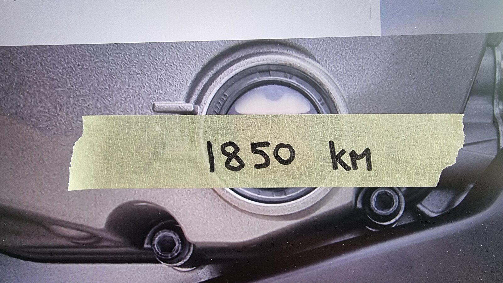

  10. I have driven another 950 km, a total of 1850 km. This time it has been a bit varied driving, also with motorway.
    This is the consumption so far, Minimal.
    The measurement is done in exactly the same way. Same height front and rear, and level.
    Otherwise, everything works as it should and no problems. Gearbox works perfectly

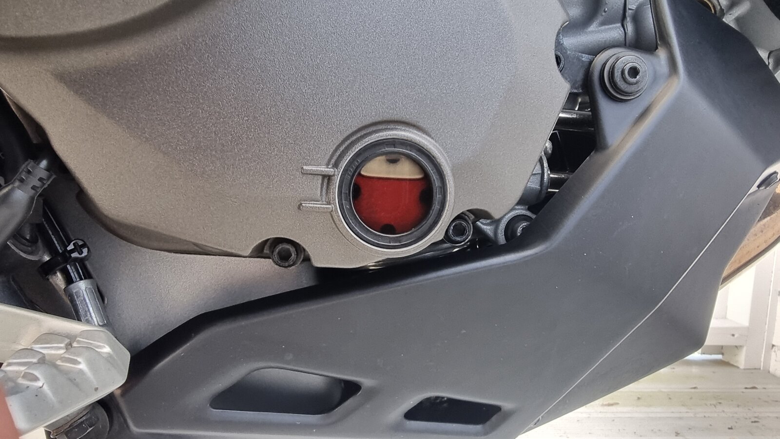

  12. Interesting that you mention that you had an oil leak on the cam pulley shaft. I have now discovered that I had a drop of oil hanging on the underside of the solenoid. I took off the belt cover but could not locate the leak.
    Could it possibly be the seal on the upper or lower cam pulley? Or could it possibly be a leak at the solenoid?
    Or could it also be from the gasket to the valve cover? It is not much, but this will be rectified when it is due for Desmo service
    I will, first of all, replace the solenoid on the horizontal cylinder. There is a small O ring there, I was told.
