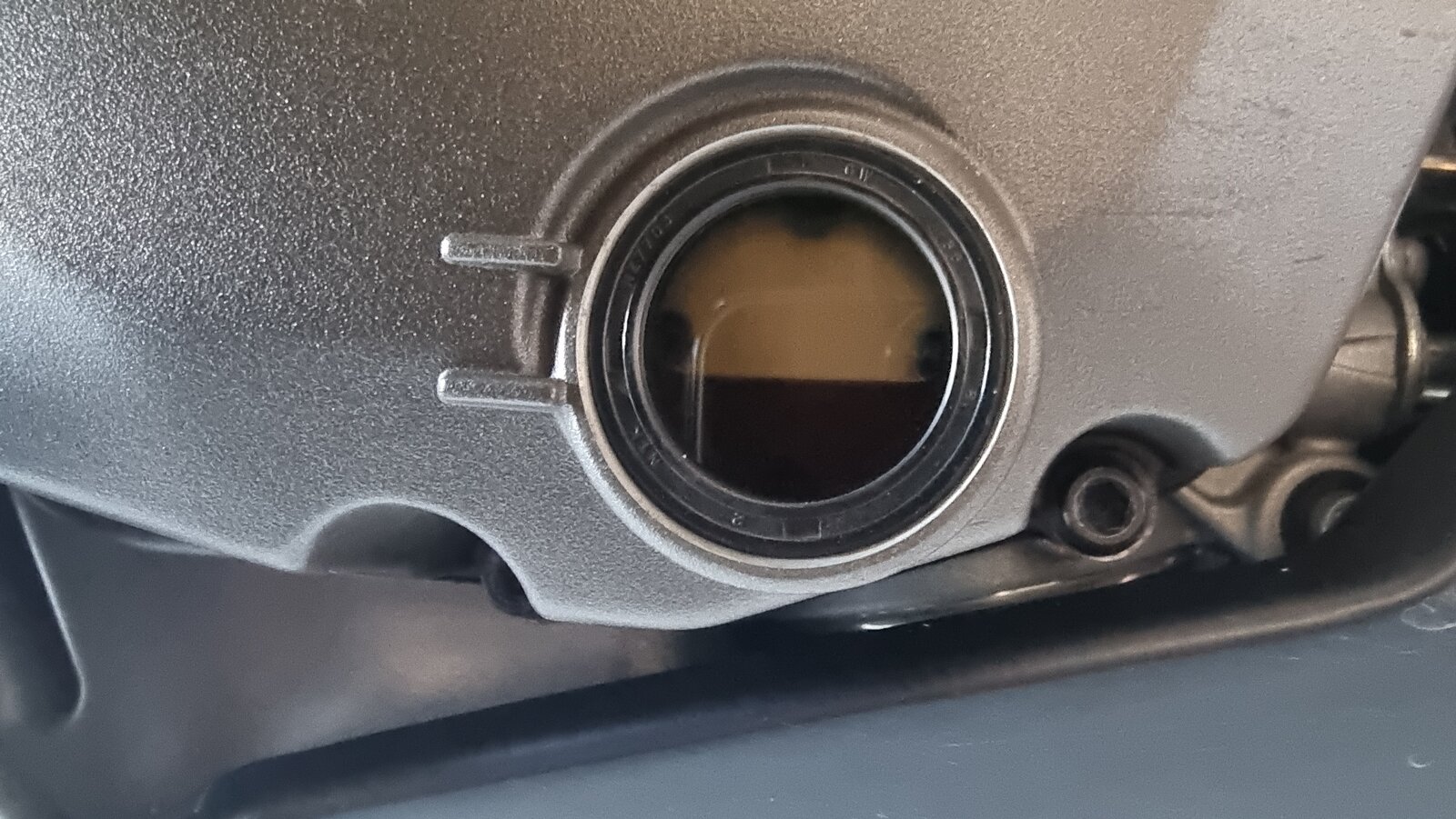

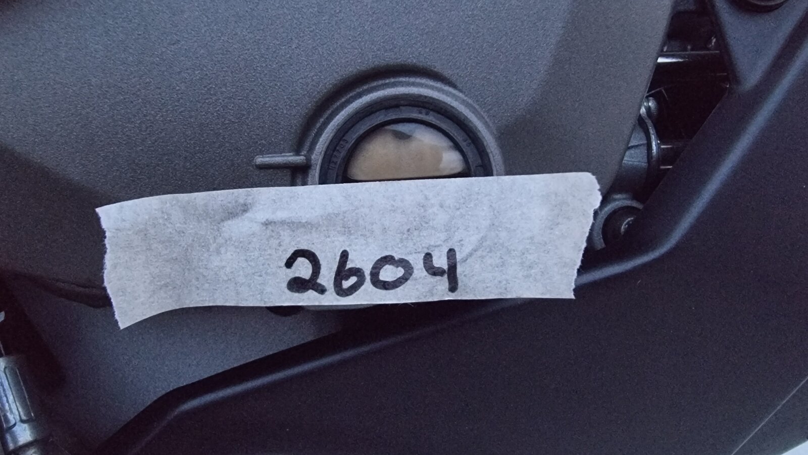

  3. This is what it looks like now after 2604 km.
    Does anyone happen to know how much oil goes between the max and min marks?
  4. It’s at least 250ml , sorry I don’t know the exact measurement.

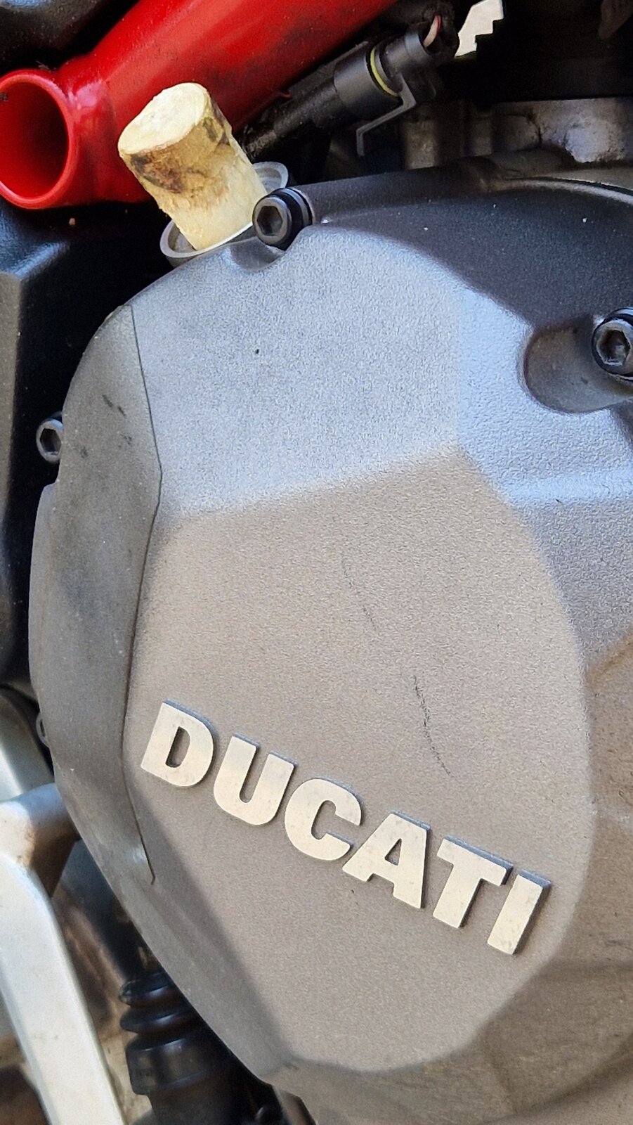

  6. Just completed 2500 mile European trip. My 1260 Pikes Peak Multi drank one litre of oil.
    Mixture of maybe 25% autoroute/autobhann/autostrada and 75% twisties/cross country routes on A and B road equivalents.
    Forgetting to put the oil filler back on after a top up maybe spat a little of that out :rolleyes: Had to whittle a temporary replacement.
