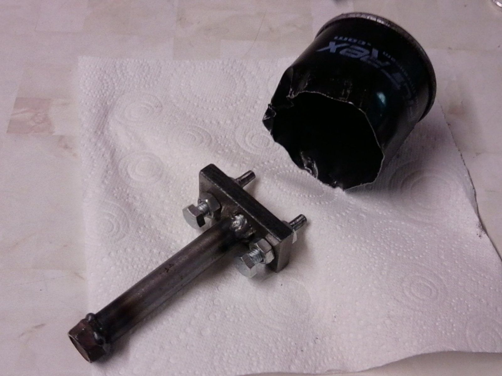

  4. had the same sort of problem myself
    housing on the filter turning but not undoing
    made my own tool inspired by the pics on here by I think duke desmo
    also made a mess in the process trying different ways first lol

  9. to be honest I used a genuine ducati filter at the time
    to replace with have used a rubber strap wrench thing to replace since works a treat
    did consider a k&n filter with the piece for a socket
    but have heard of the piece snapping off
    probably been overtightened lol
    did think of buying the proper tool the cup type one but
    heard of the filter collapsing but hey ho

  18. That's a pretty substantial tool, it has to be said...
  19. you need something like that if you find that you're not screwing properly

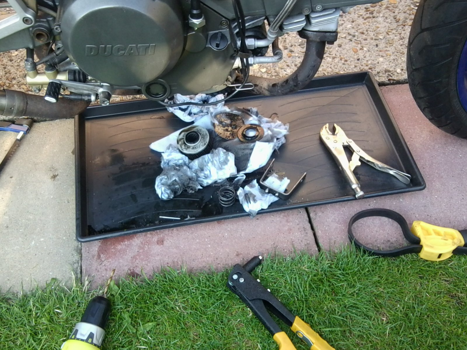

  20. Amused me to see the OP for criticising himself for buying a cheap filter.............
    .......shows a photo of the wreckage...................but..............
    .......doesn't mention buying cheap pliers as well................:laughing:
