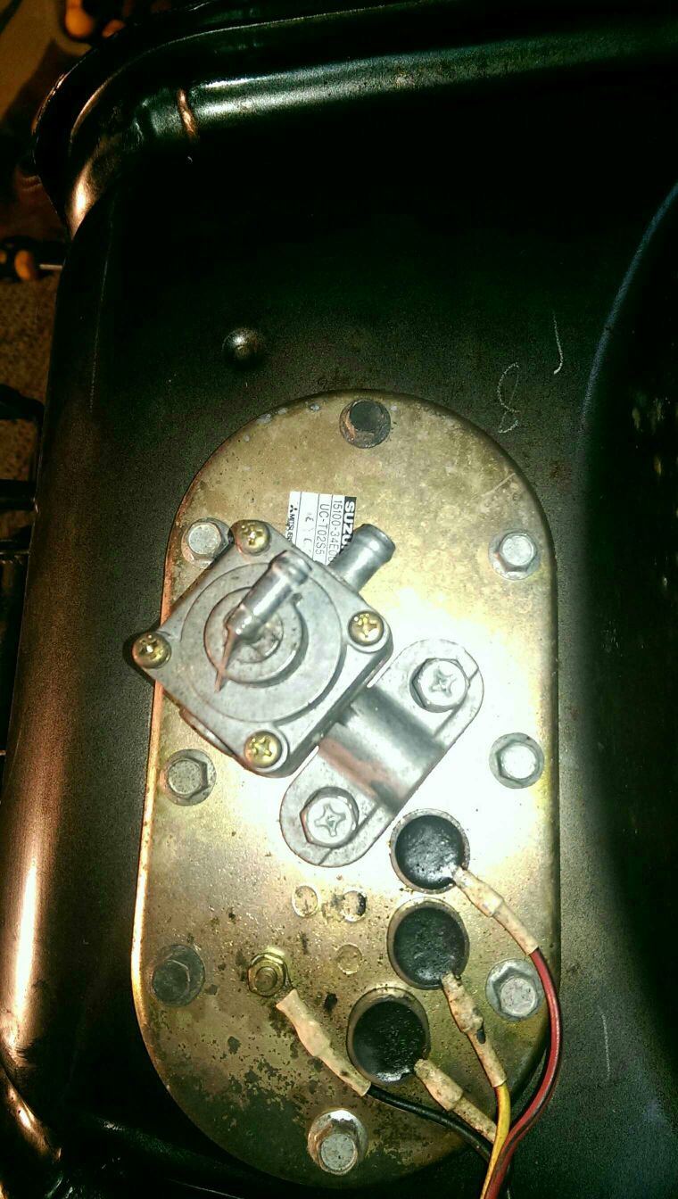

  16. Any ideas on torque for these? Nothing in Haynes.[​IMG]
  17. what the plate periphery screws? - they will be gasket-ted - what type? - just nip them down 'so-so' as my best mate in the world used to say - the undoing torque will give you a clue - definitely don't go mad on them - no need.
  18. sounds fine - I am old school and don't use torque wrenches on the whole but no point in discussing on here ;) - just had another glance at your pic - you will see the outer edge of the plate has a 'turned down' flange which means the tightening is self-limiting if you are careful i.e. - you can visually see that gasket is squashed to max plus torque required will increase quite suddenly (hopefully)
