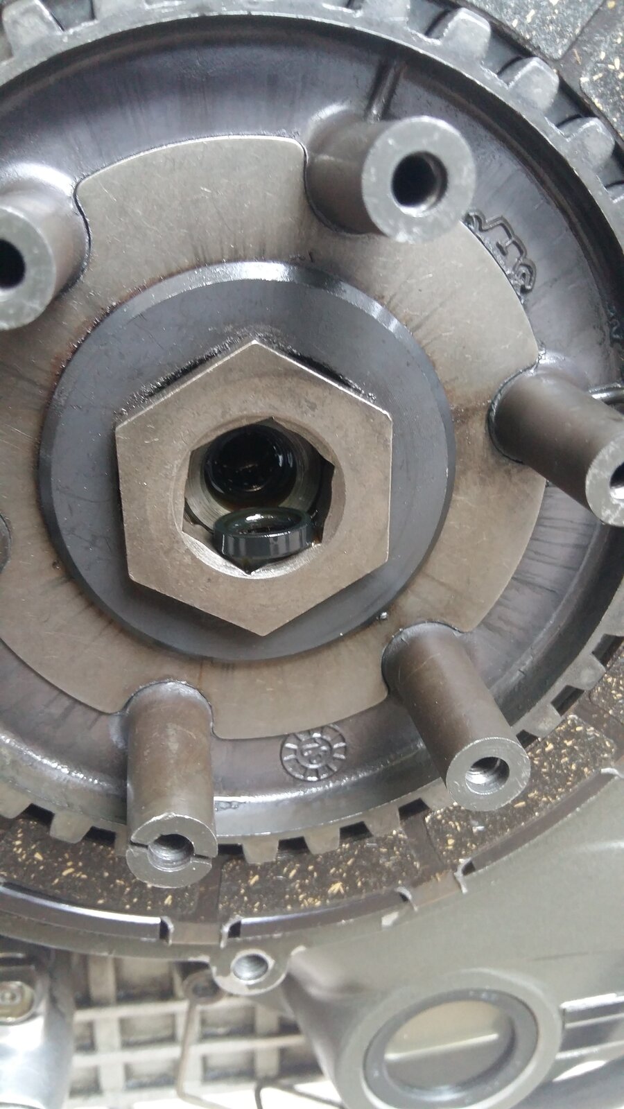

    Here are some pics:

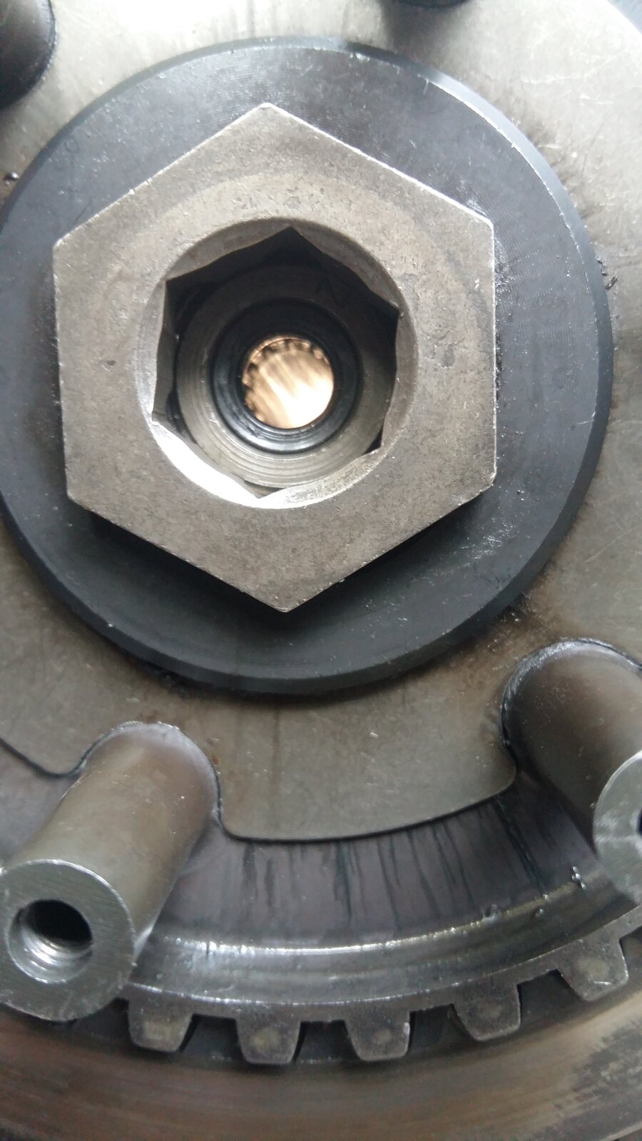

    After taking pressure plate off (throwout bearing turns nice and smooth) and pulling pushrod out through the left side...
    But on closer inspection, is there another seal behind the clutch nut?

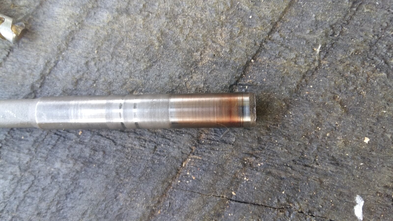

    End of my pushrod is tarnished brown. Heat? I lightly grease both ends whenever I install so not sure what the change of colour represents.
    It is straight, runs true. Has only done 7K miles.

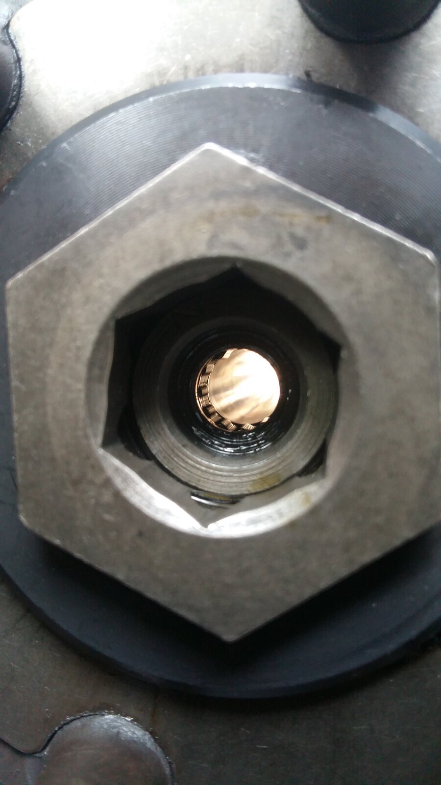

    Anyway, drove in seal again (with decent force) as per normal. Looks to fit ok, assuming I have it in right...

  6. Personally I wouldn't grease the pressure plate end of the rod, if the rod is a tight fit into the top hat bush and the bush is a tight fit into the pressure plate bearing, the bearing should then do its work and stop the rod from spinning, the brown heat mark could be the rod spinning in the top hat bush.
    Steve
