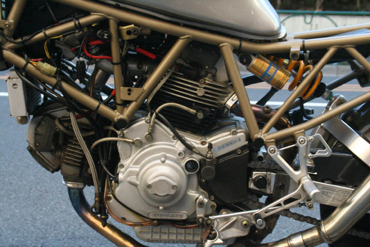

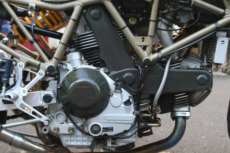

  12. Looks like it
  13. Thanks AD.

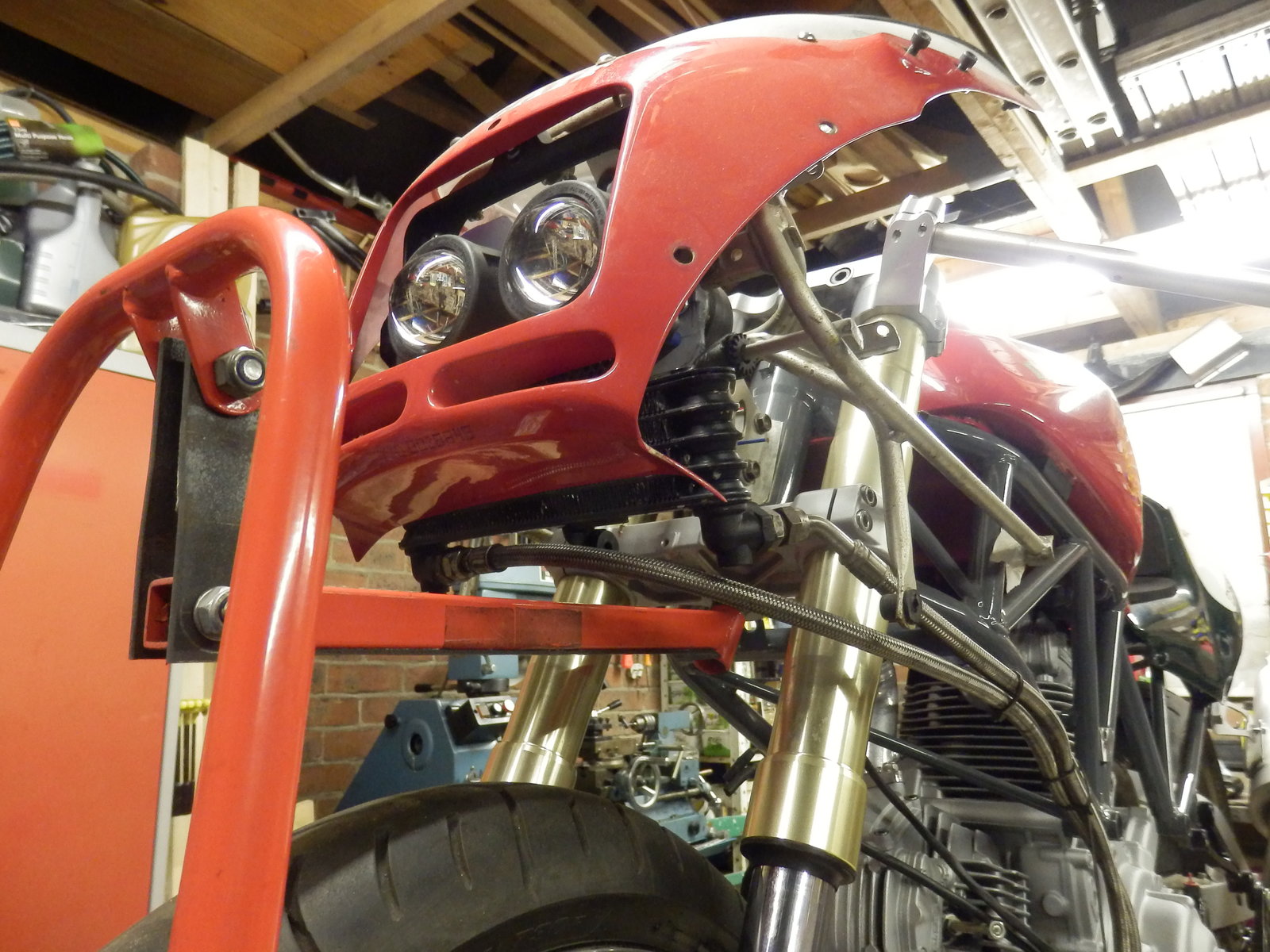

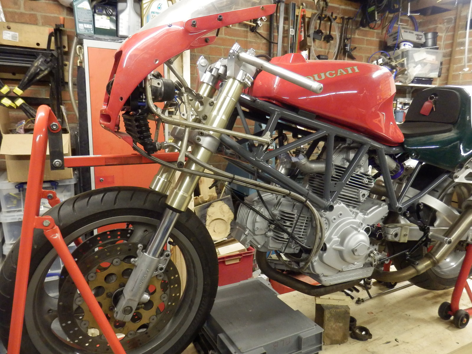

  19. I'm still playing with this.
    As Sev mentions above I have the later type adaptors so I can use any later type cooler.
    I have a 1098(I think) triangular oil cooler on the way with it's hoses, and will mock it up to see what it looks like.
    Whilst I'm waiting for it to arrive I've been messing about with a Multistrada 1000 cooler and lines which could look quite trick if I can get it right, and the smaller area will be compensated for by the longer lines.
    It's only hung loosely in the images below, I'd make sure it was vertical and would have to add a heatshield between it and my projector headlights.
    Although I'm not sure I actually like it, and would need to cut the horizontal section out of the bottom of the nosecone to get it some more air.
    I suppose I'll make a decision when I've mocked up both versions.
    Nasher
