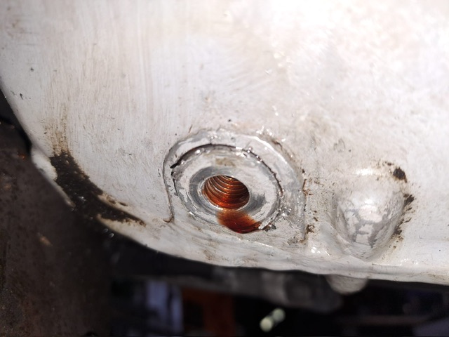

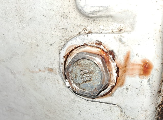

    A customer of mine recently bought a Monster S2R, went to do an oil change as they didn’t know how old the oil in there was and found someone had butchered the oil plug and tried to fix it with an insert but the insert was leaking all the time around the edge. She managed to find a local engineering firm who welded around the seam thus sealing it for good.
    The engine remained in the frame, they just lay the bike on its side. For sure there’s a lot of heat generated but it’s very localised and for a very short duration , this is micro welding after all, not joining steel girders.
    ef65d269-a529-48b1-8e78-3097ab48fd53.jpeg a3c53398-bfc4-4b08-aa7a-7689b0a3cf3d.jpeg
  19. Totally agree, i am also asking around and will see if anyone is willing and obviously capable. The dealers did say becuase of the heat and apparently they pass through an electric current which could damage the sensors is why they want it out. But il get a few opinions from others
