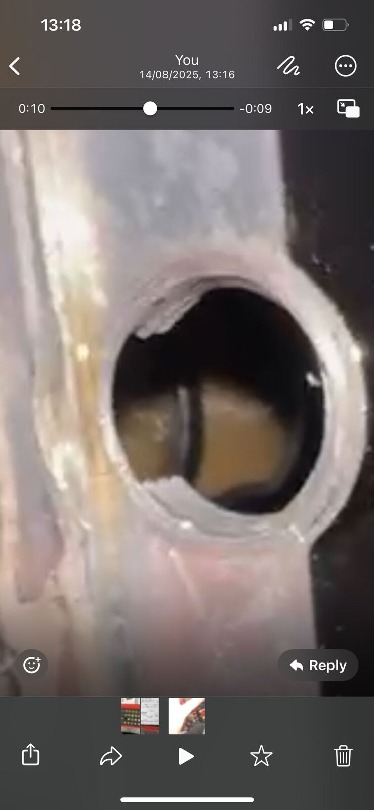

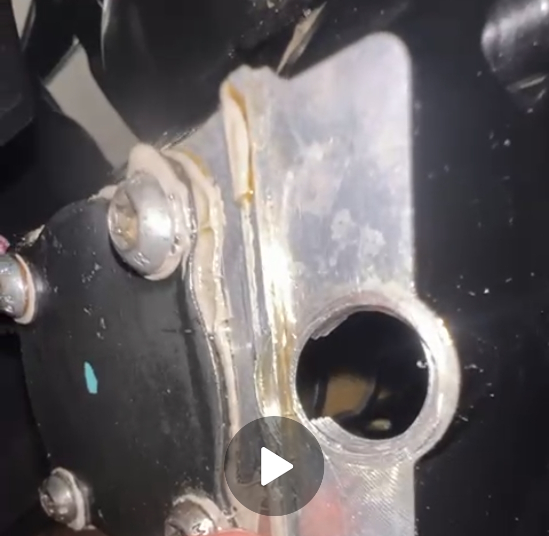

after having an issue with my M3 oil pan plug i reviewed what options are available on the market, i would have a look at the Time set from Wurth, https://eshop.wuerth.de/Produktkate...ime-Sert/1401600601.cyid/1401.cgid/de/DE/EUR/ this is what i used on the sump and have a stronger thread connection between the alloy housing and plug now.
The dealer already tried the time sert in the first instance and said there was still a leak apparently once the engine warmed up. This is why the opening is bigger and needs a repair job
hmm strange as when you use the time-sert correctly you also cut a small recess for the upper insert flange to ensure a flange/thread interface and also thread lock is needed.
