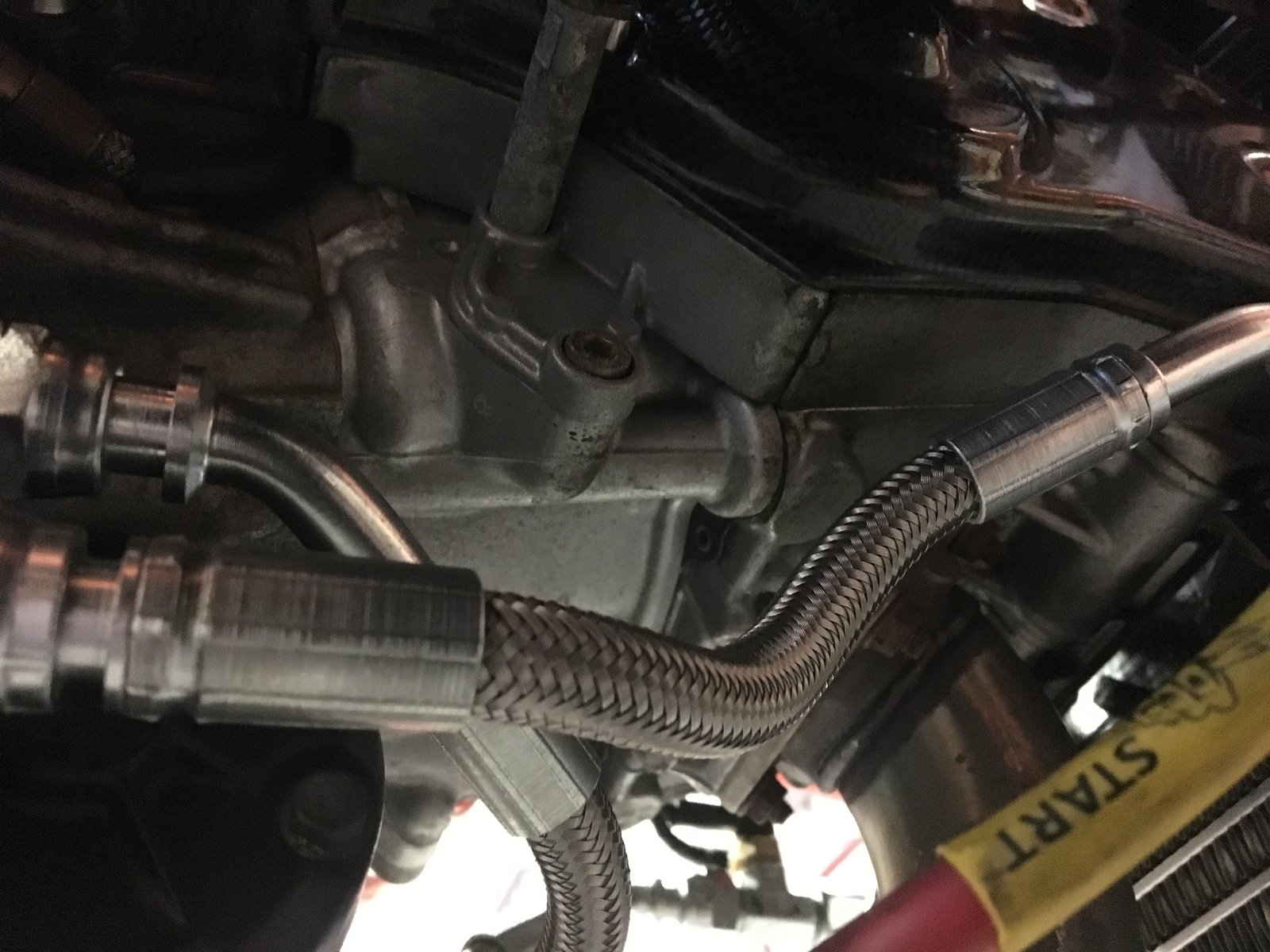

  3. @ducv2 this is it. The threaded bit at the top of the T will get machined flat. Drilled and tapped to M10.
  4. Is that on the 'in' or 'out' side of the cooler, because it will make a difference.
  5. Surely you'd want it on the cooler inlet as that's going to be closest to what the engine oil temp is, no?
  6. Thats a nice solution that I bet didnt cost RS prices!!
  7. Hi all. It’s placed on the oil cooler feed line. TBH not sure it really matters but that’s how it is on the RS bikes.
    Price wise, don’t know yet. He charges £35 an hour and thinks about £25 in bits. He gave me the fittings and hoses so I could get it all mounted on the bike, chop the hoses down to size and mark it all up to get the angles right before crimping.
    Shouldn’t cost much more then £60 to £70.

  13. Got it all finished off today. Temp sensor seems to be working fine. Let it idle up til the fans kicking in.
    38B6C90E-B682-48F0-8793-569FD1F6CAB7.jpeg 2A2812F5-CFD5-427E-ACF1-65ACF2AA0BDC.jpeg 65504497-63B7-4B0D-AB6A-39A983C91492.jpeg D7C86279-CFA2-46DD-8187-F77562F40029.jpeg 2160FE2C-805A-4174-9B57-E9A8B632DB7B.jpeg
    Checked for leaks and nowt found.
    Best bit though... £60 for new oil lines, £15 for the T piece, machining and tapped out to M10. The sensor only cost a fiver as well.
    Lines were made up at active hydraulics in Keighley in case anyone’s interested.
    Ian
