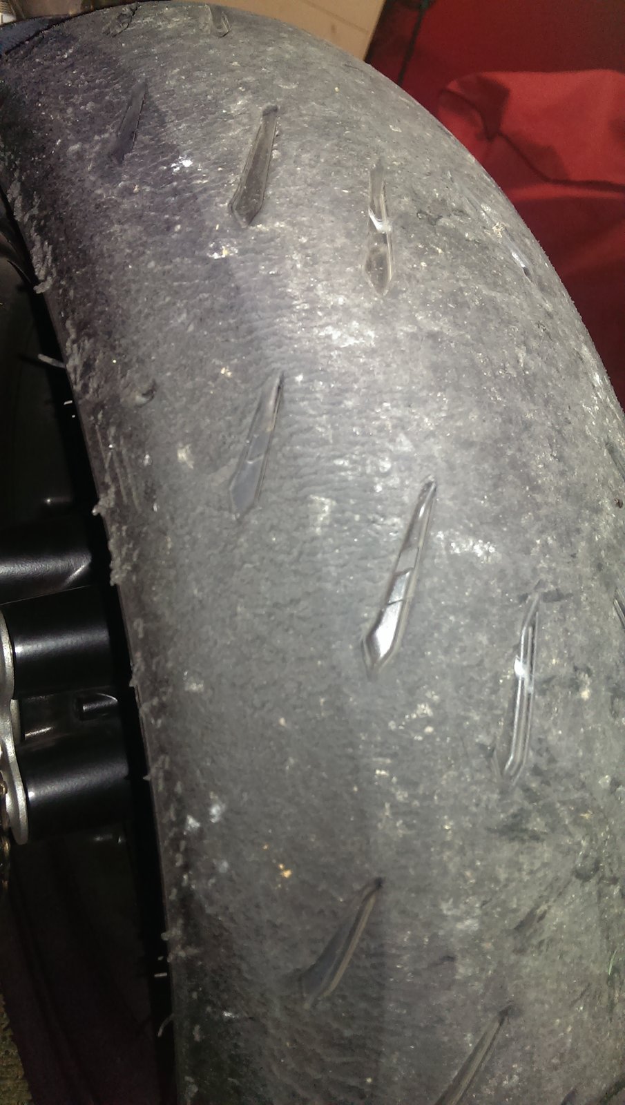

  1. just out of interest but are you a fat person? the only way i can get the tyres peeling on the edges like that is when i am two up with the mrs on board.
  2. Nah. I'm 6'2" and about 82kg in my pants (there's an image for you).
