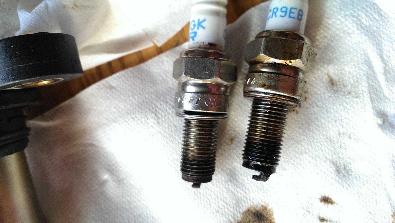

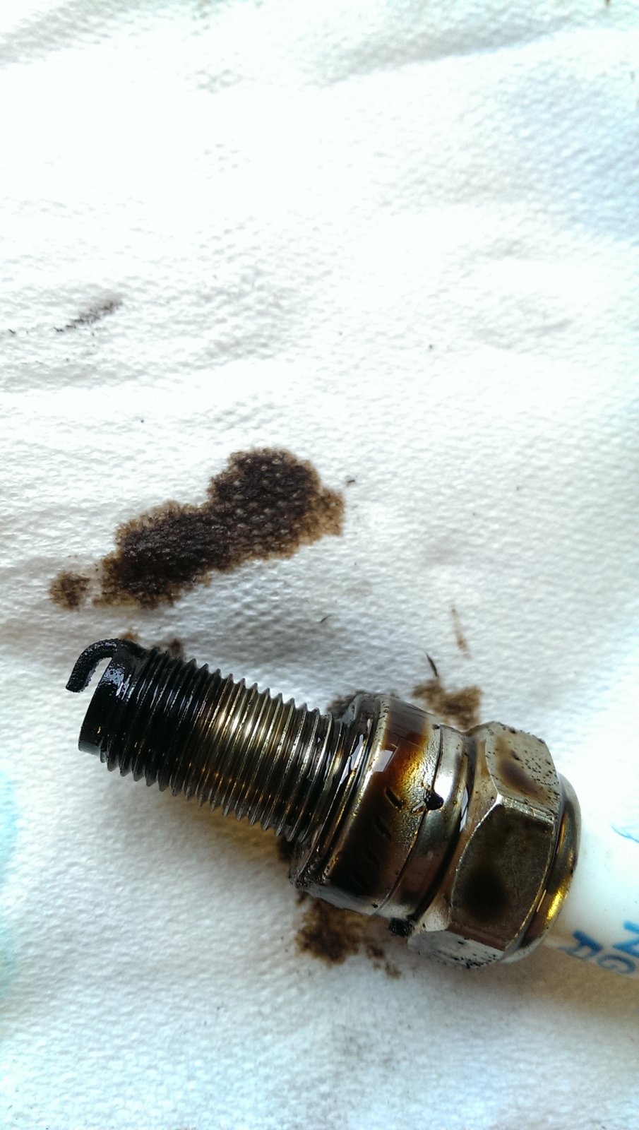

  6. Vertical plug looks oily.
    • Dislike Dislike x 1
  8. There's oily ...
    ... and then there's that monstrosity!
  9. Other than the amount of oil, that looks to be running rich to me which would account for a bit of black smoke.
    Steve
  10. That's quite a bit of oil on the outside of the plug mate, is your rocker cover loose, leaking, or cracked?
  11. why so much oil around the base of the plug? you got oil leaking into the plug holes?
  12. I know on 1098's the seal on the rocker cover that keeps oil out the plug hole fails regular filling the plug hole with oil. When I put mine back after checking valve clearances I put some of that grey stuff on the seal. Stopped mine leaking
  13. So, as I'm going to get the valves done anyway, this could be good as maybe only the gasket gone explaining losing oil and smoking exhaust?
    I have a feeling heads have never been off.
    No sign of oil on outside.
  14. Tend to agree looks like it’s running rich and even if leaking into plug hole that wouldnt get to the cylinder so that won’t cause the smoke - think the black smoke is over fueling
    Does it smell like it’s over fueling when running ?
  15. Smelling fine. And done a very happy 2k mls since custom map. No poping on over run.

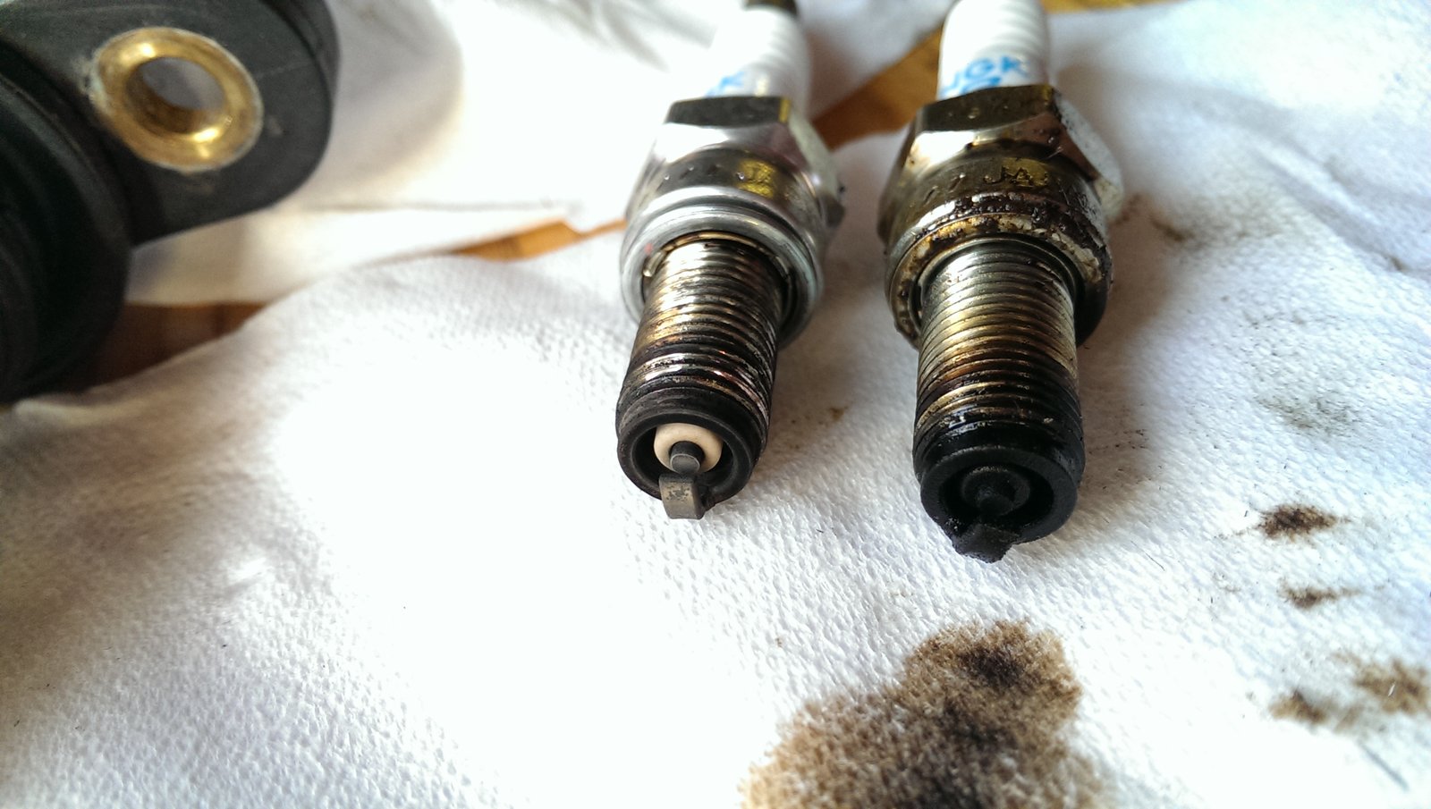

  16. Pulled the H. Looks healthier.
    Did a compression test on cold engine.
    V-100
    H-115
    Anyone know what this indicates?
  17. Vertical is a bit low IMO which taken with the condition of the plug COULD indicate rings or valve seats. If the stem seals have gone that could result on crud accumulating on the valve affecting the seating. Andy
  18. Ok, to be honest, as I know the valves should be done anyway, this probably won't be to horrendous......
