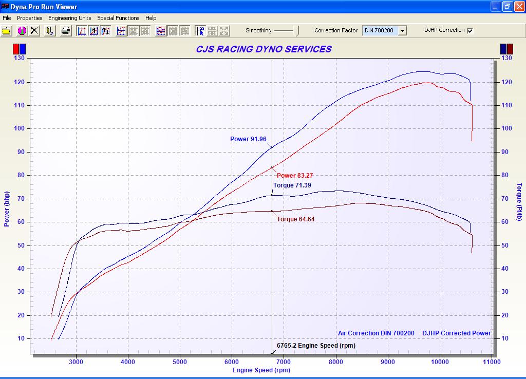

    You said you had a remap and dyno...has it been mapped separately for vertical and horizontal cylinder?
    When I took my VTR sp2 the guy mapped each cylinder separately(done some exhaust work to separate the cylinders) ..so both bikes being V2 I guess the 999 would need the same. Taking my 998s FE in the winter for remap.
  12. yep. pro Custome Map before and after.JPG per map.
