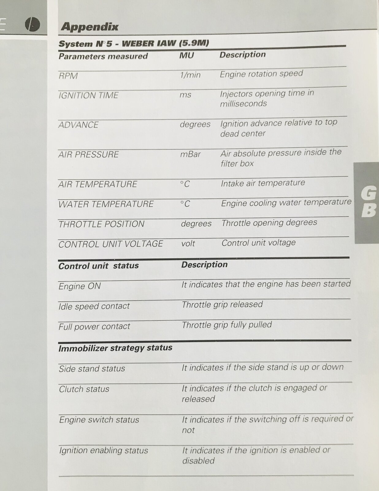

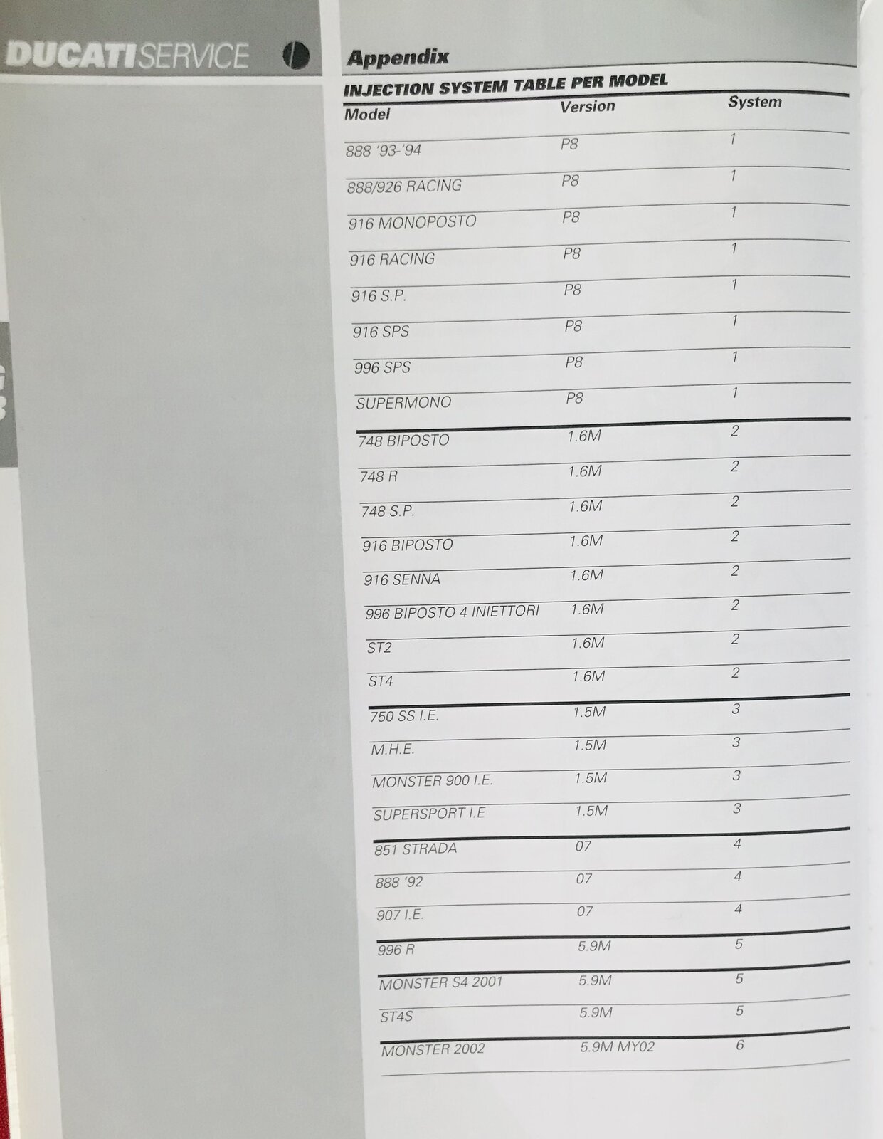

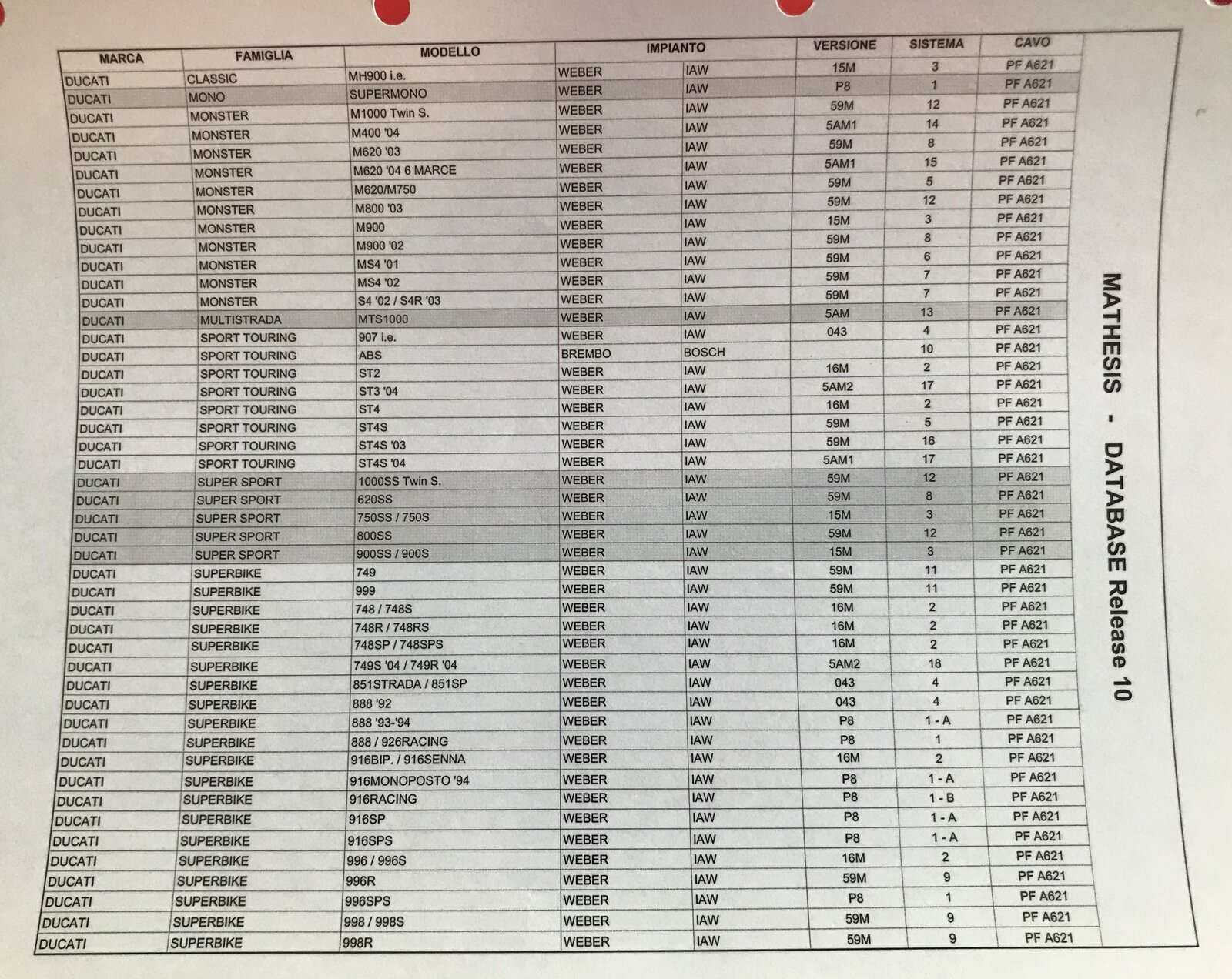

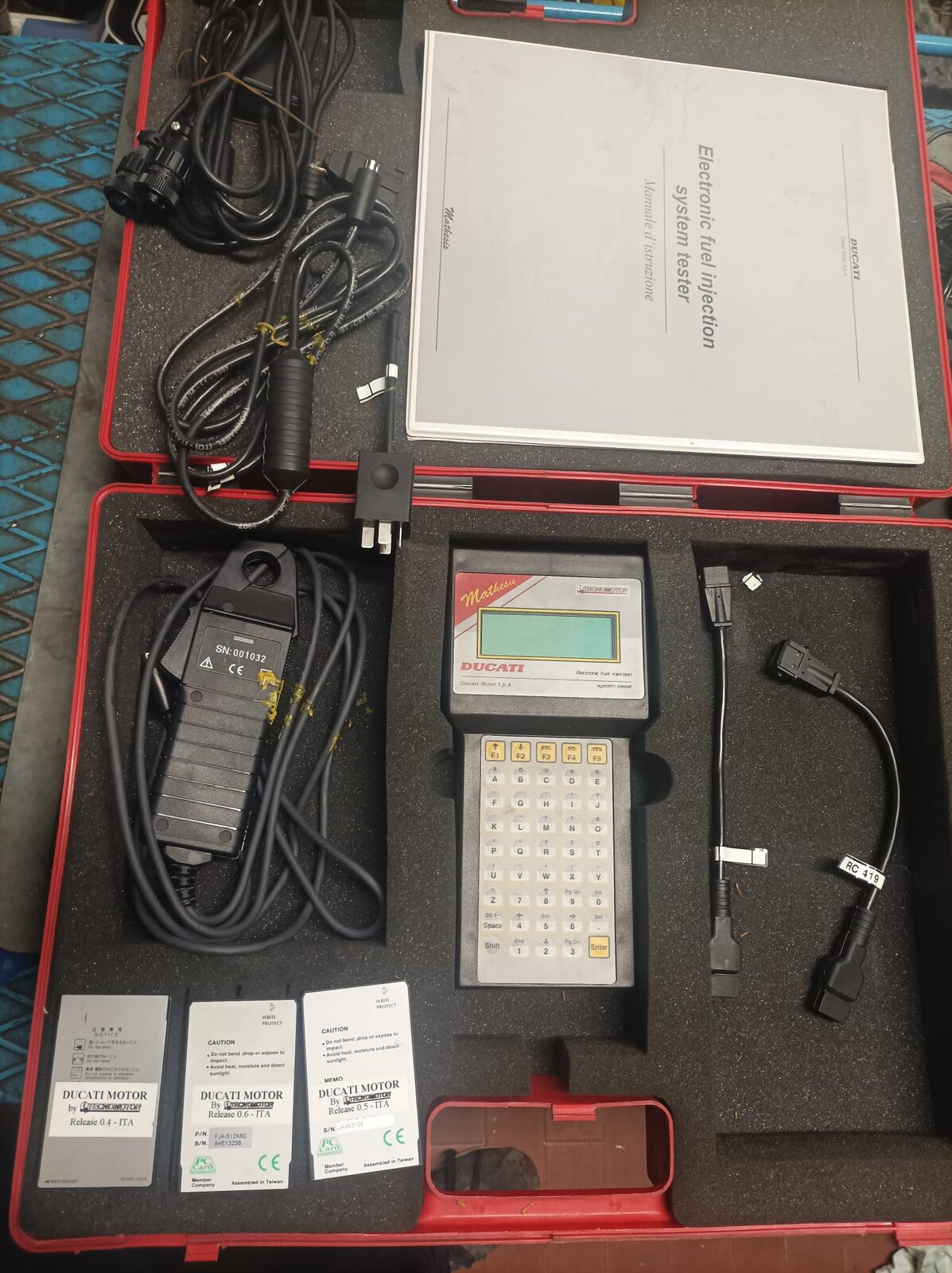

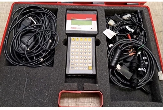

  6. So, having looked at my 05/2002 diagnosis tester user manual, here’s what Mathesis info I found about the 5.9M:
    - Software version = 0.6 or 0.7
    - 996R = « System » 5 9269668F-C60E-4D48-9080-17111F904545.jpeg 8102D998-A186-4336-BA16-B13E34FF1D14.jpeg A9789661-45FE-42AD-AF2F-FDA78E1DCBFF.jpeg 814B52DA-4ADC-4D5A-8430-A9830DB27710.jpeg 7D174BA0-2186-4F23-9758-E4BE6532F649.jpeg
    In a later workshop document I have (Mathesis database release 10), 996R is mentionned with « system 9 ». 64085A51-56F8-4BB1-A873-5F9C1699C97B.jpeg
    A little confusing, but nothing out of the ordinary for Ducati… :D

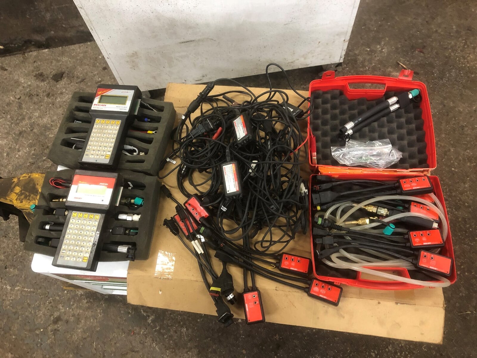

    and there I found what I was looking for - look on facebook messenger
    an American ( Raymond Burris) currently has 2 sets of mathesis: One complete in Italian with belt tester and pressure kit and another one with only the belt tester. These are getting extremely hard to find. And when they are available are costly"
    hard to get in touch with him he doesn’t connect so often

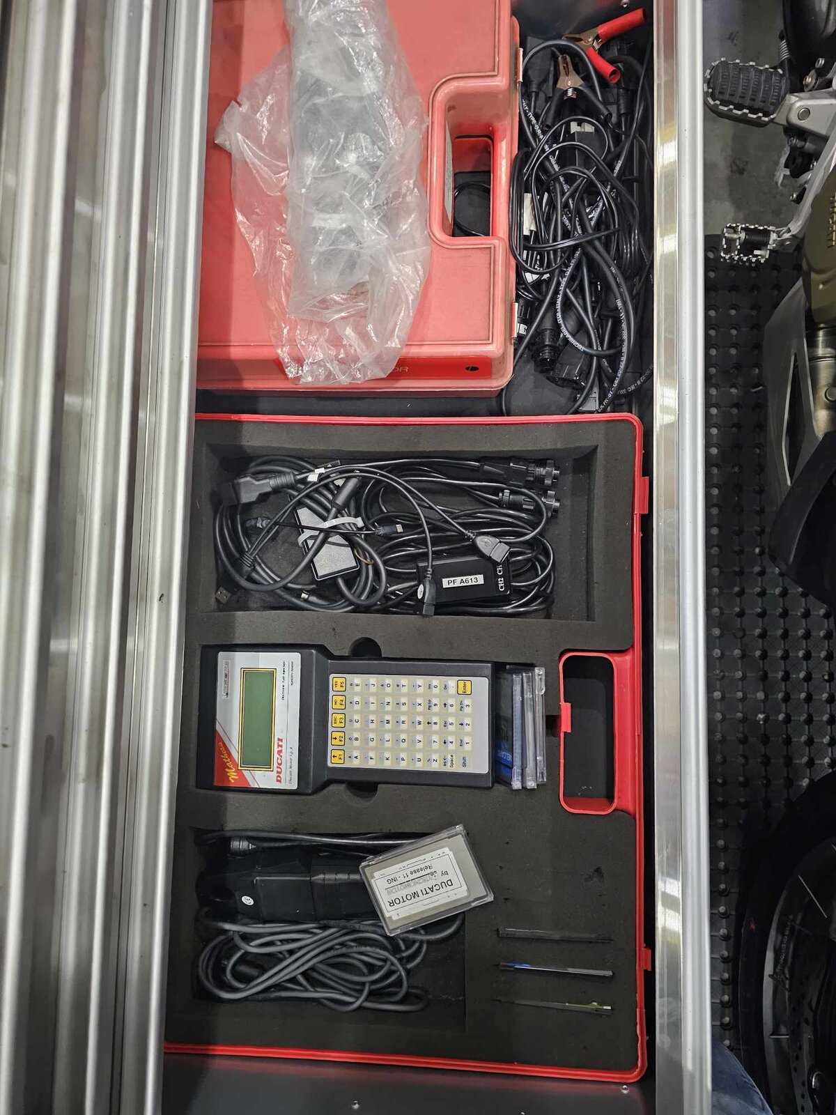

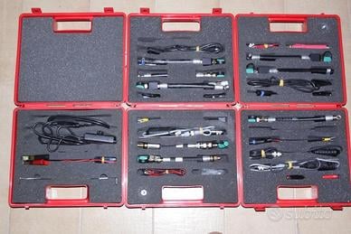

    an Englishman ( john Tomlinson), great collector of the 998 model, to a lot of mathesis cable but not the appropriate suitcases (photo 3)

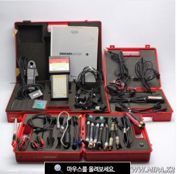

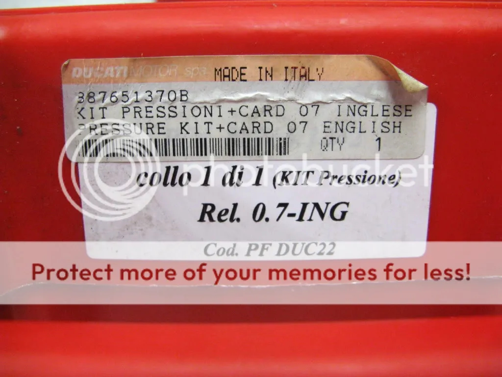

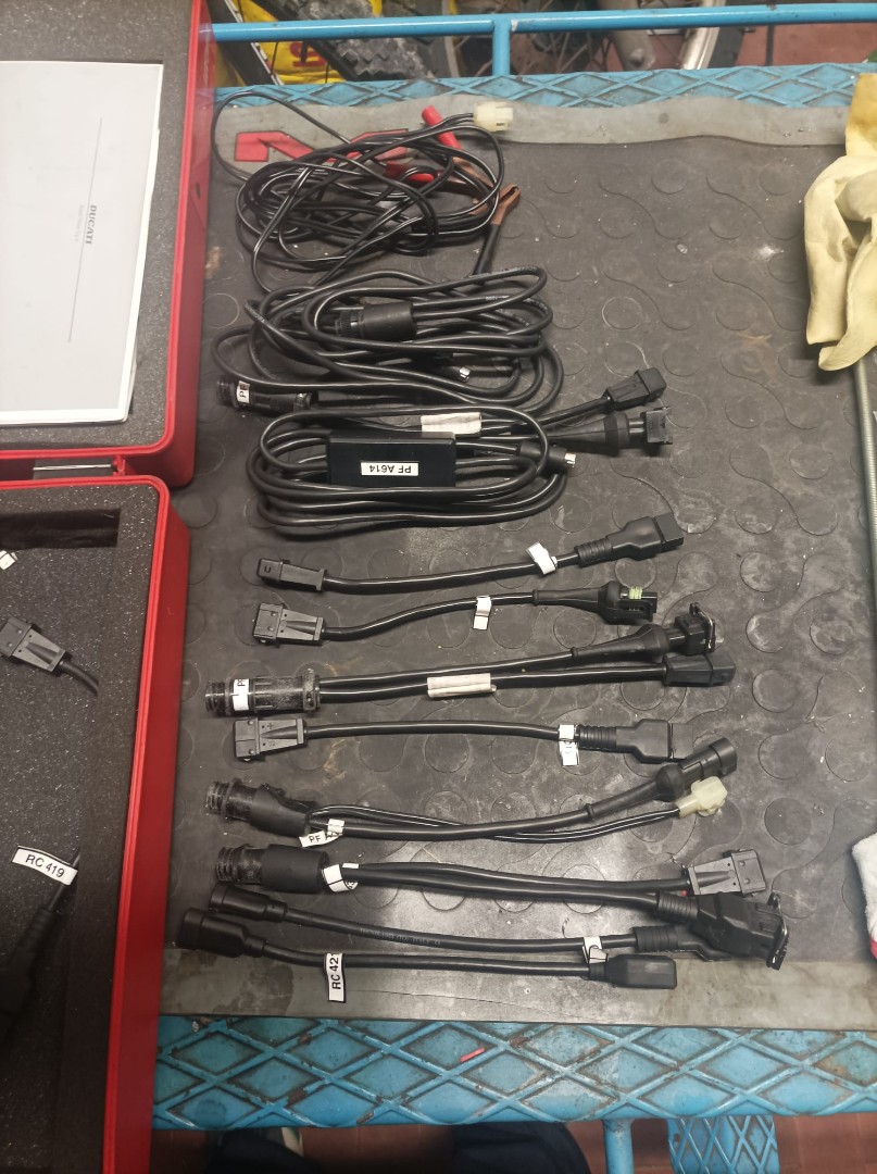

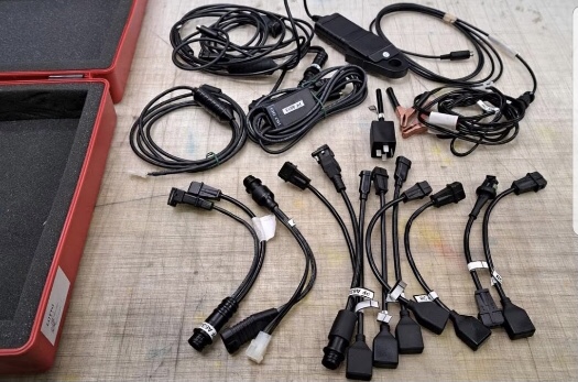

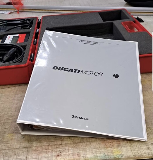

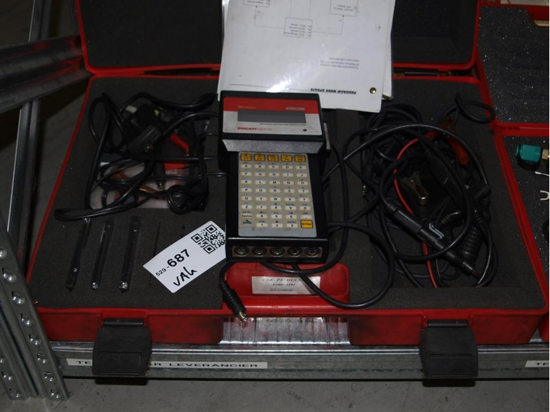

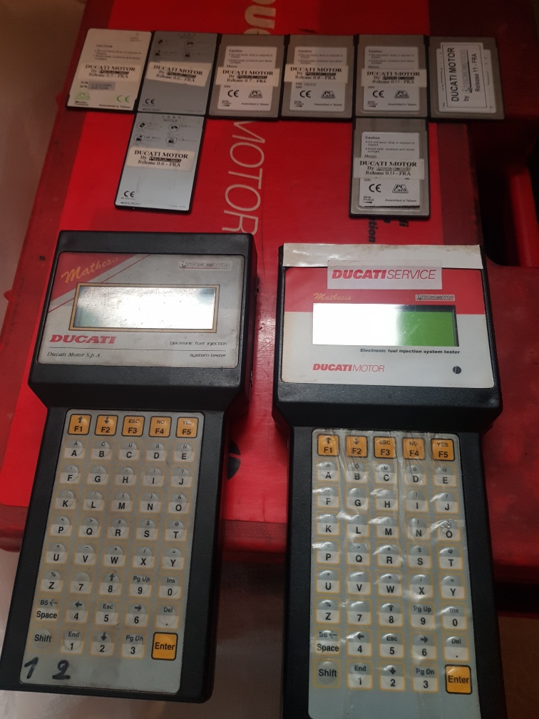

    an Australian ( Ryan'o P.Coltrane) to what it takes fully and practically new ( photo 4 and 5)

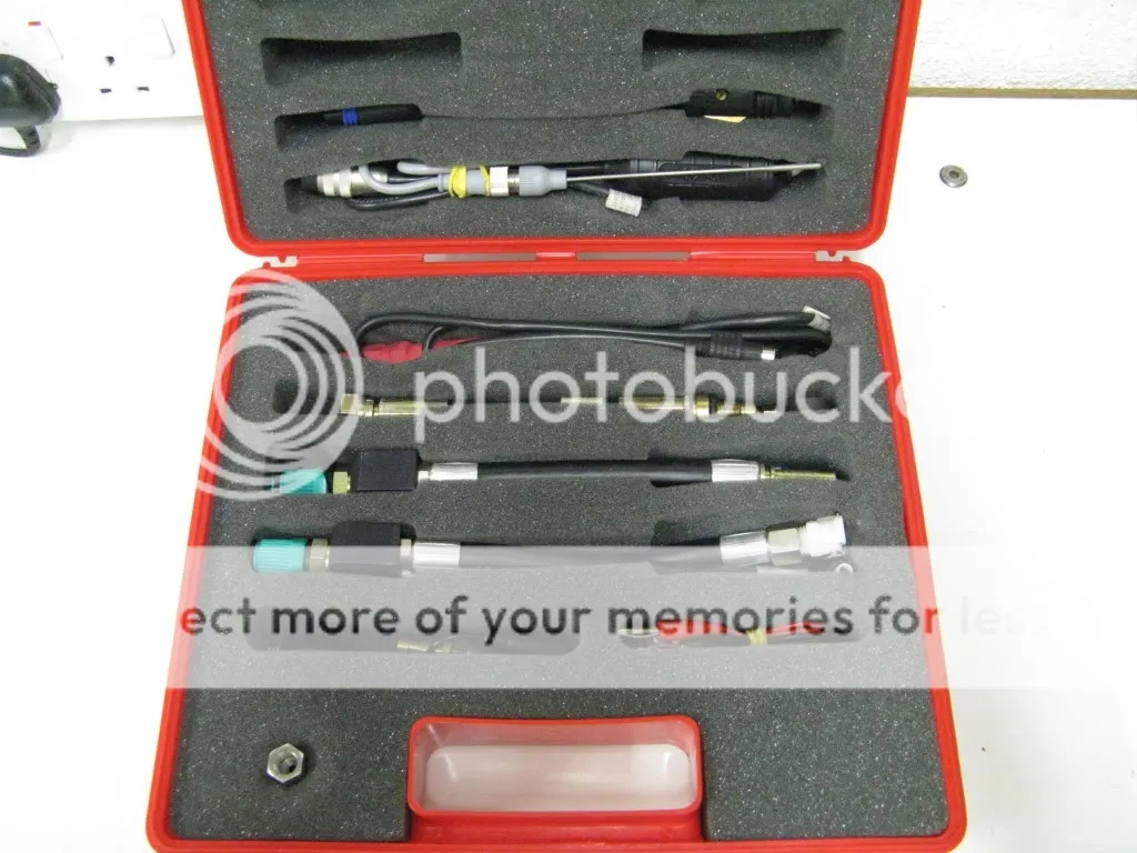

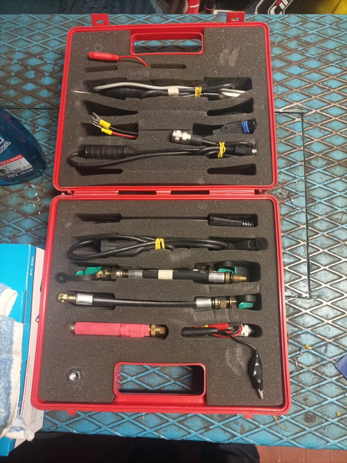

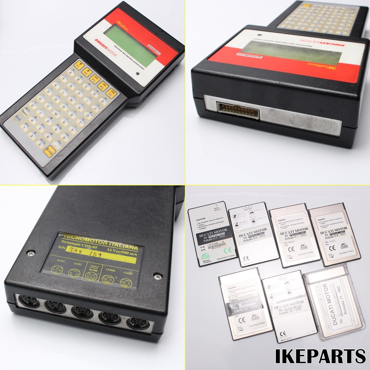

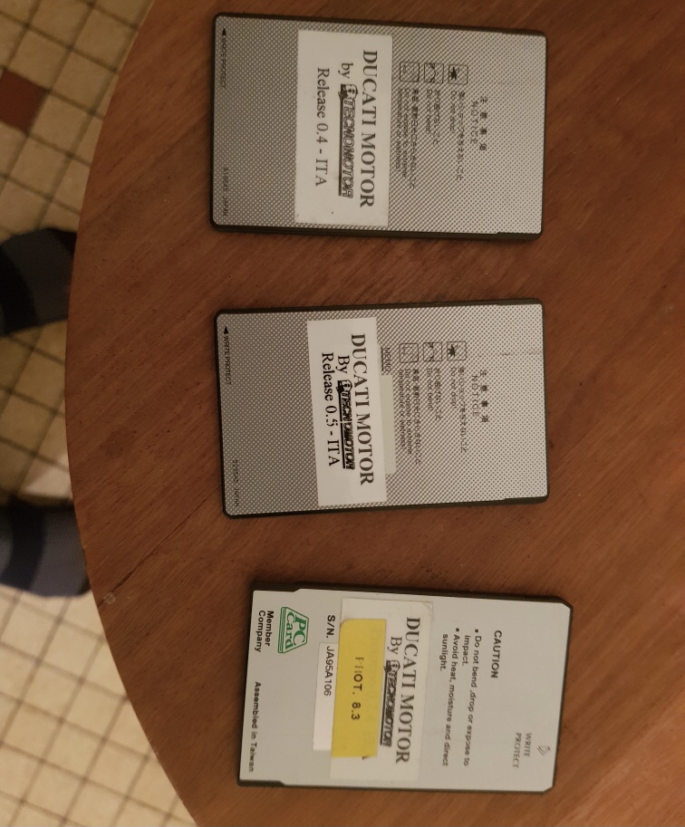

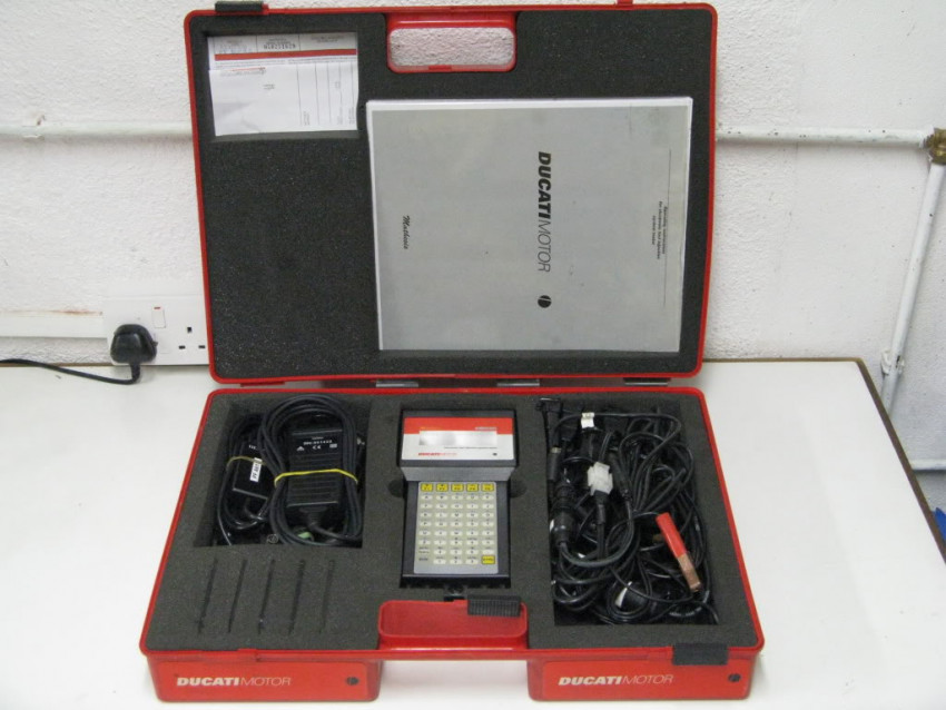

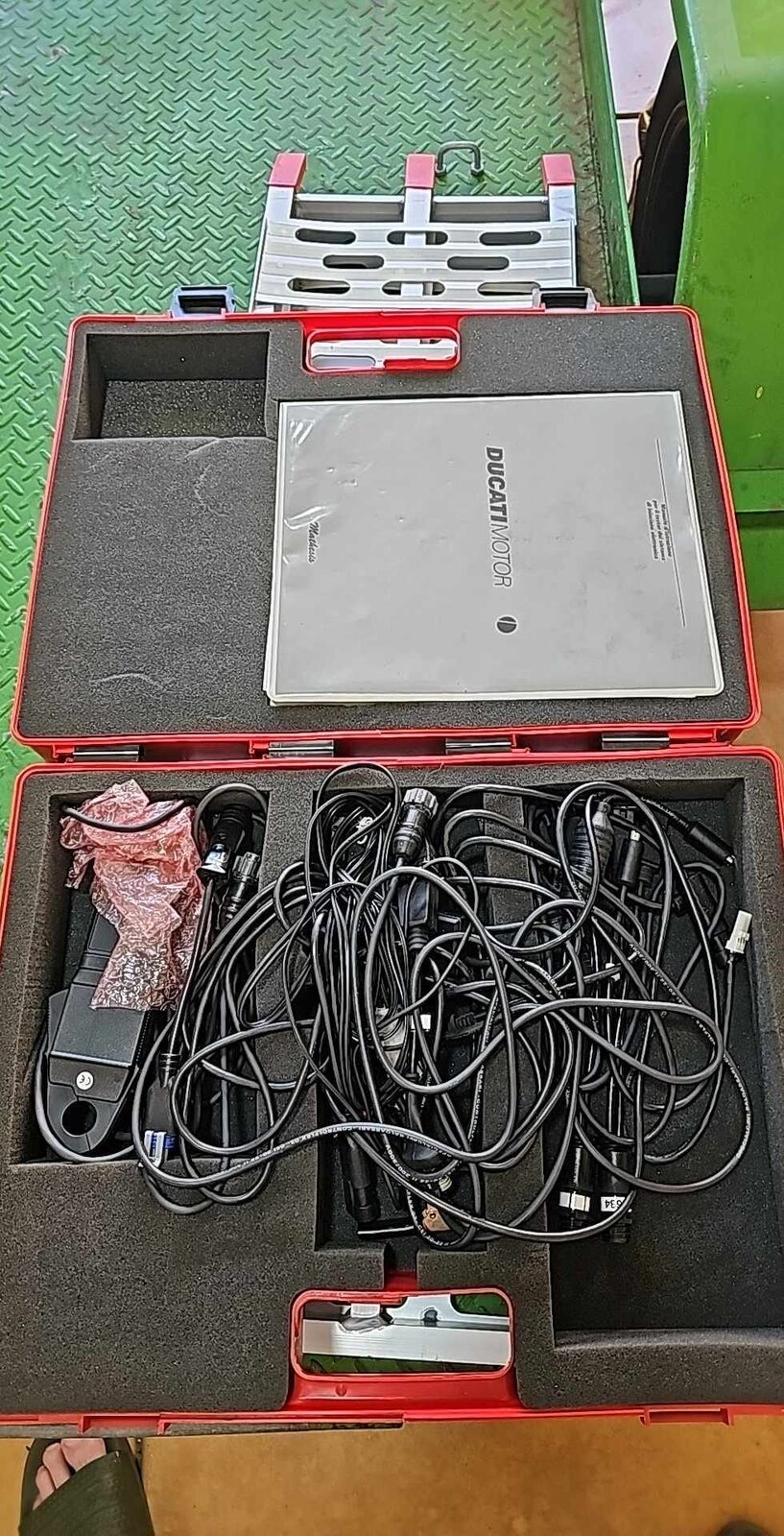

  12. Images 6, 7, & 8 appear to show an older unit and it only has updates v4, v5, & v,6. v6 would work for me, but I'd rather have a v7 for the additional features. I see a 2021 posting on their FB page but nothing listed on their website.
    Images 4 & 5 also appear to show the older unit. I see it has a v11 and 3 others that I can't read, so perhaps had a v7.
    Image 3 appears to show both the older unit and a newer unit (system 5 that I want) below that one, and no software disks that I can see. Really sucks he is missing the cases. Even the 1 case he has is incorrect for this unit.
    Images 1 & 2 show the newer unit I want, and hopefully, he may have a v7 update for it.
    There are several Raymond Burris on FB. Can you help me with which one?
    I also found a person on FB named Greg Neveux who has a kit and posted images of it. He said he paid $4500 in 2001 with 2 cards 0.6 upgrade. That's crazy, it has a cracked case and is only the Mathesis unit and 1 case.
    EDIT: What I called the newer unit is technically a "Terminale CDS-05" made by Tecnomotor Italiana. So I'll take that to mean "system 5" referenced in the May 2002 manual.

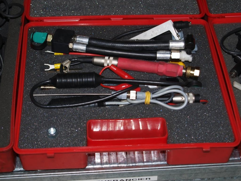

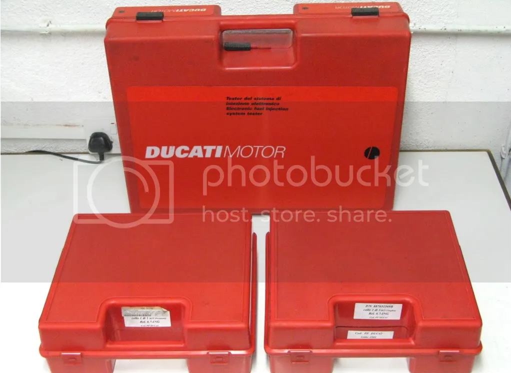

  14. What do you make of this image, which appears to show 3 cases PLUS the Mathesis unit case? That's 4 total, what's the middle case in the image of the 3?
  15. IMPORTANT QUESTION:

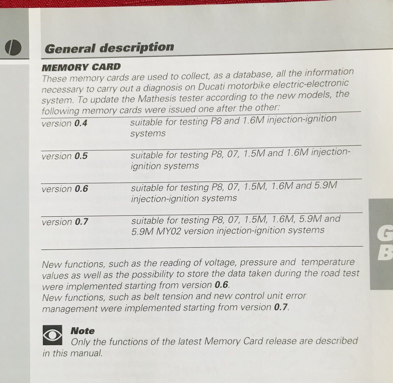

    How specific exactly are the memory cards? For example, that manual says 0.7 is for MY02 injection-ignition systems. Does that mean I must have the 0.6 for my 2001 996R? For that matter, if I find a 0.8 card, is it backwards compatible?
    It seems to me they are adding features with each revision and not locking a certain version to specific model years. But I want to ask just in case, because you know, Ducati lol. I want to be 100% sure on this.
    I ask because I think I've found a kit with a 0.8 English card.
    Thanks!
  16. I understand that each new version (0.4, 0.5, 0.6) etc, consists in a new software update with added functionalities and models. They call it a database release number XX. So a newer version should work for a model that was already taken into account in a previous software version.
    Now if you strictly want what was the latest release in 2001 when the 996R was available, then I’d say it’s 0.6.
  17. I appreciate the confirmation.
    I've realized that these cards are more common than the kits so I'll be buying the best system 5 kit I can, and whatever card I need I'll worry about after the fact. Like if I get this kit with the 0.8 card, I'll just go find a 0.7 and 0.6 card afterwards.
  18. for the mathesis boxes, for the 2 versions, they are both CDS-05
    for Desmomarket mathesis, the kit would be sold with 5 other memory cards in addition to those in the photo, making 8 cards in total (4-5-6-7-8-9-10-11) - but I recognize that the box is a first generation
    contact Paolo on Whatsapp +339 333 363 0495
    As for John Tomlinson the lack of suitcases is reguretable but it has the cables in duplicate of which one almost impossible to find, for the cards of Ryan'o, it is a card 10 and 11
    for Raymond Burriss, he has a 748 on his profile picture
    https://www.facebook.com/raymond.burriss

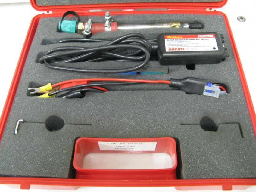

    for the photo of your set of 4 suitcases, the case is a CDS-05
    why so these 3 suitcases in addition to the main one, the first is that of the belt tension kit, and the other 2 are in reality only one. it’s just a more spread out, less piled up layout, with some duplicate elements
