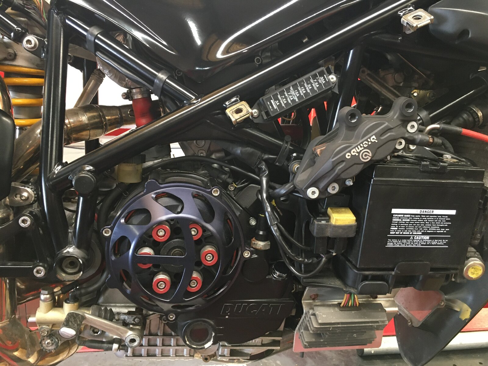

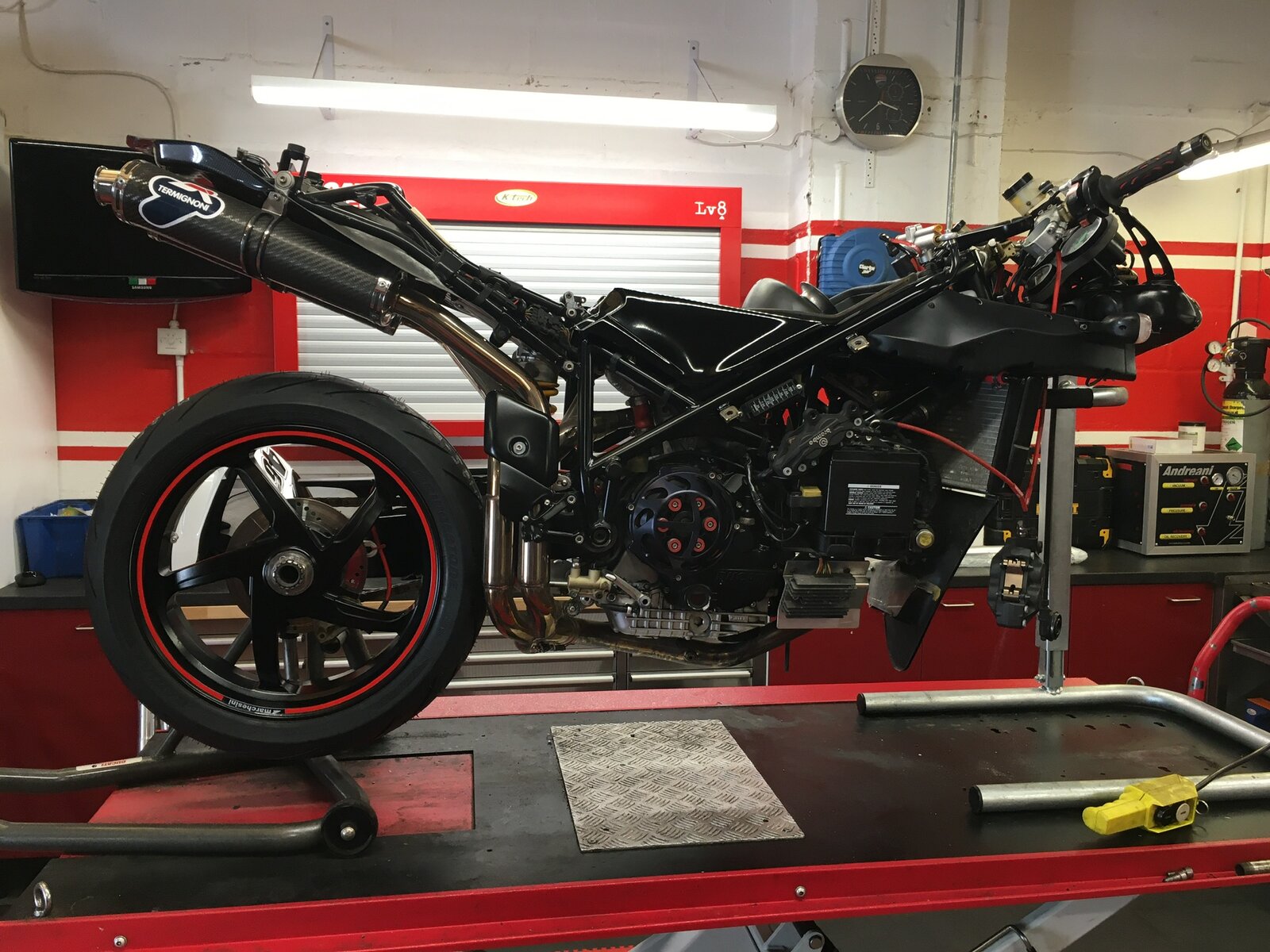

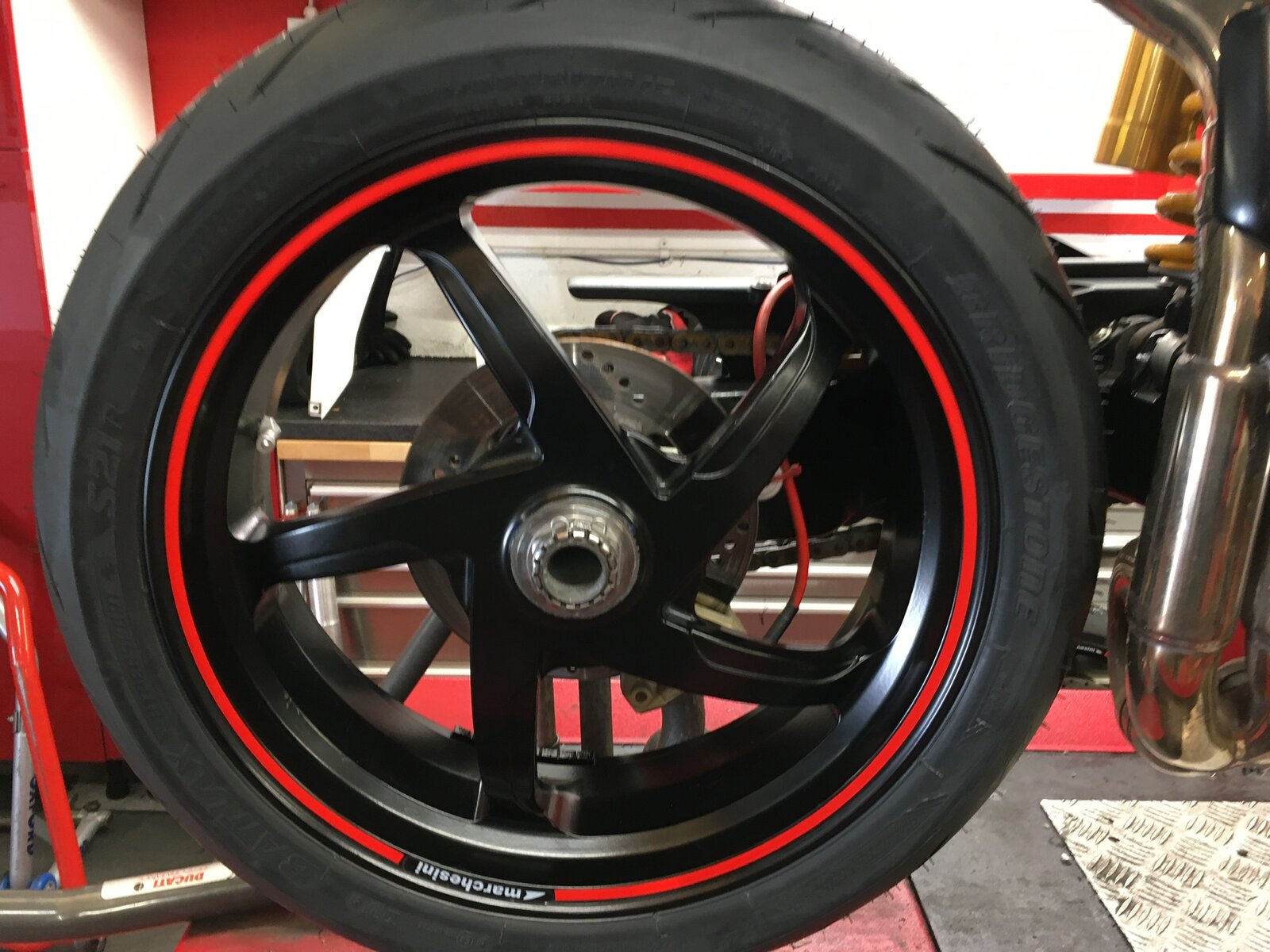

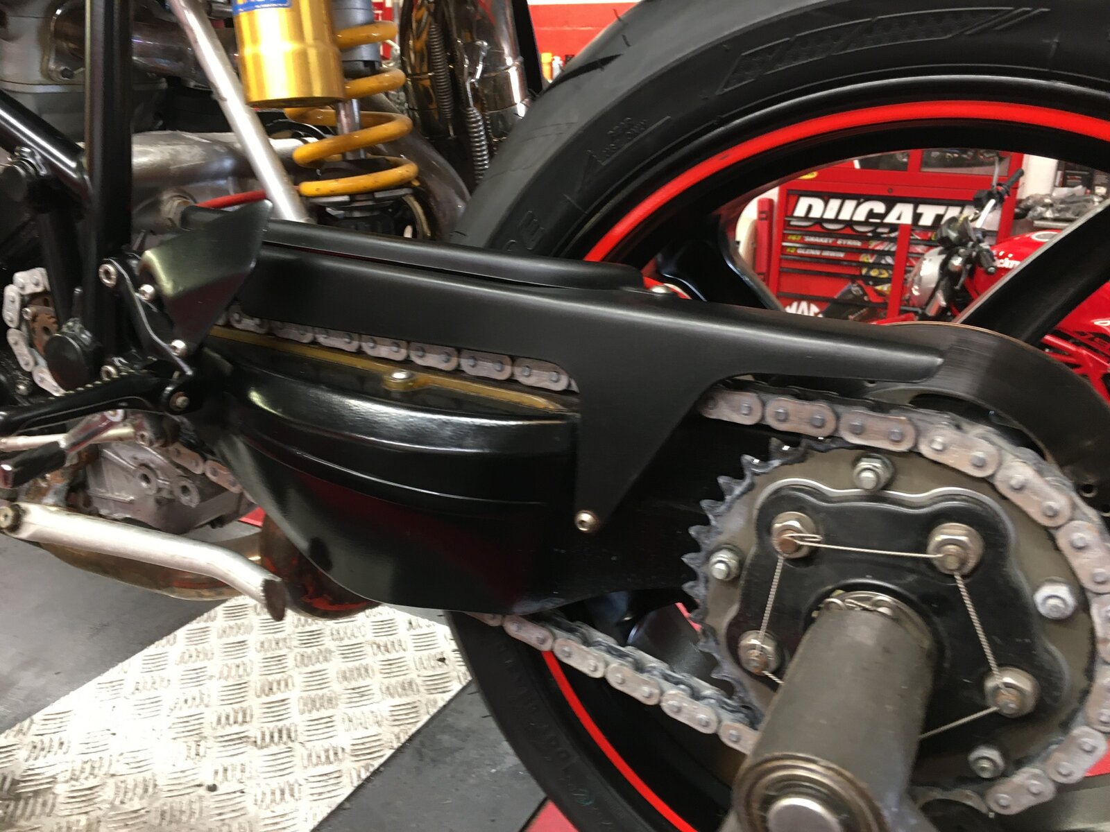

  1. With time on our hands the chassis has had a good clean, in fact the whole bike has and the engine checked and serviced. No bad rockers, valve clearances tight and good. New belts etc. Ditched the under tank air filter and fitted Pipercross filters in the air tubes. Clutch is good, fresh coolant and brake fluids in the front. Rear master cylinder looks goosed, but that’s kinda exepected. New Bridgestone S21 tyres have gone on. No scary surprises have cropped up. New battery fitted and the engine cold primed to move the fresh oil around the engine, hit pressure quite quickly so she should fire when the tank is back on with some fresh fuel. On the whole, the bike has stored really well.

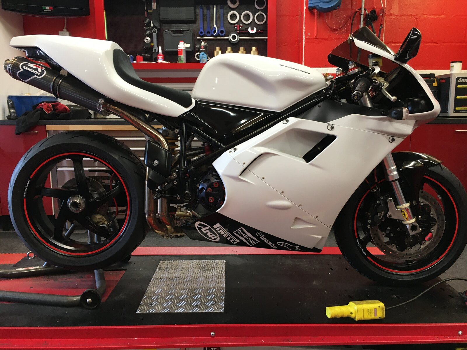

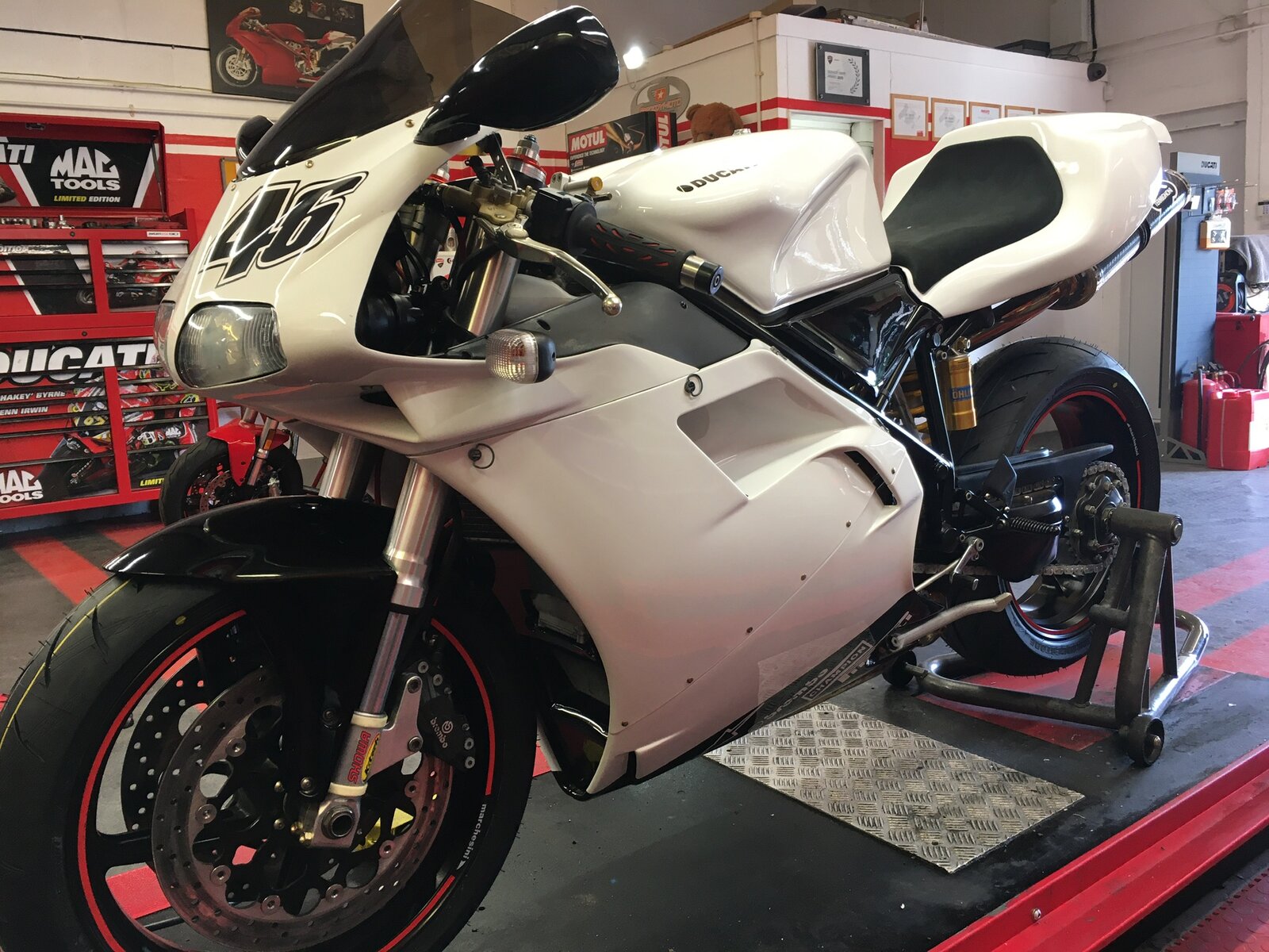

  8. So got the tank on, fresh fuel and hit the button. Fired up within a couple of turns and idled pretty nicely.
    Got an odd noise on the starter which I suspect may be the sprag, but strangely no slipping and it wasn’t there doing the cold prime with no compression on the engine? Sounds sweet when running though.
    Going to take a look this week.
    Just got the rear plate hanger and indicators to get back on then get her tested.
    Looking forward to riding this one....

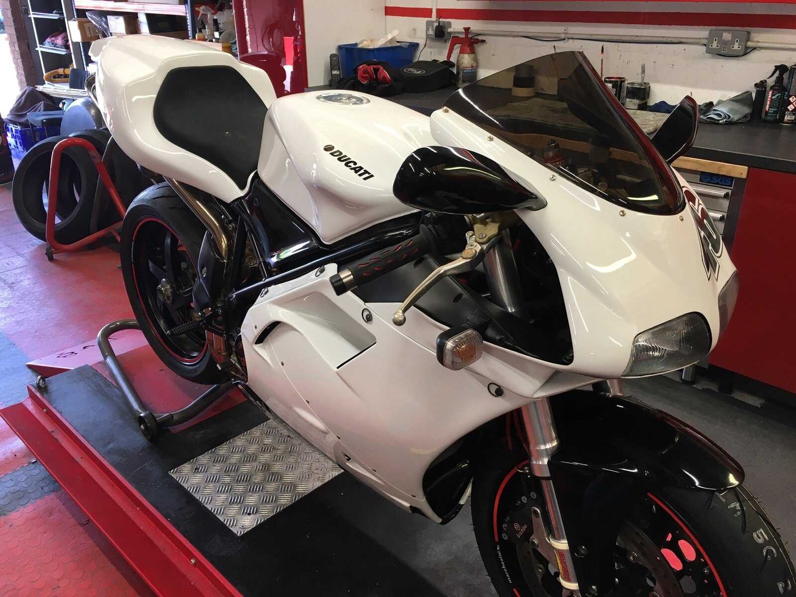

  19. Well, it was kind of a sprag issue..... it wasn’t fastened to the crank, neither was the flywheel or alternator rotor. New nut, thread lock and it went back on. No damage, so fired up and idled even better!
    I wonder if I’ve found out why it got parked up 10 years or so ago and never moved again?
    Anyhow, jobs a fish, next job....MOT. Might just sneak a quick go on the trade plate though ;)
