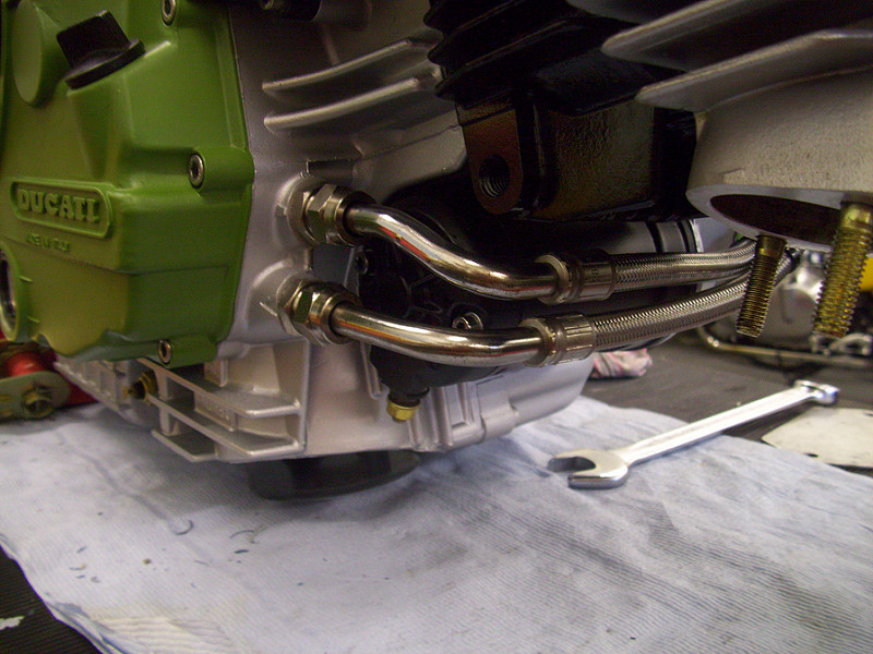

  2. I've been following this thread with interest. In respect to the unions did you have to get any special adaptors or did you just buy the ducati items for the engine side upgrade? - lovely clean conversion though :)
  3. Hi Sev,
    I bought the cooler & hoses, then got the 848/1098/1198 unions off a forum member on here? They screw straight into the SS cases... :smile:
    New listing for the brackets kit:
    Ducati 900SS 900 SS carby 848 1098 1198 oil cooler upgrade brackets & bolts | eBay
    Bike is running some very good temps at the mo, even in this heat? Very happy with it all! :cool:
  4. The adaptors are £6 ish each from a Ducati dealer - I needed to get them so that I could use Hyper lines for my SS setup.
    Oil Cooler Lines 001 by Lindsay fae Angus, on Flickr
  5. Unions/adaptors are: 815.1.022.1A :smile:
