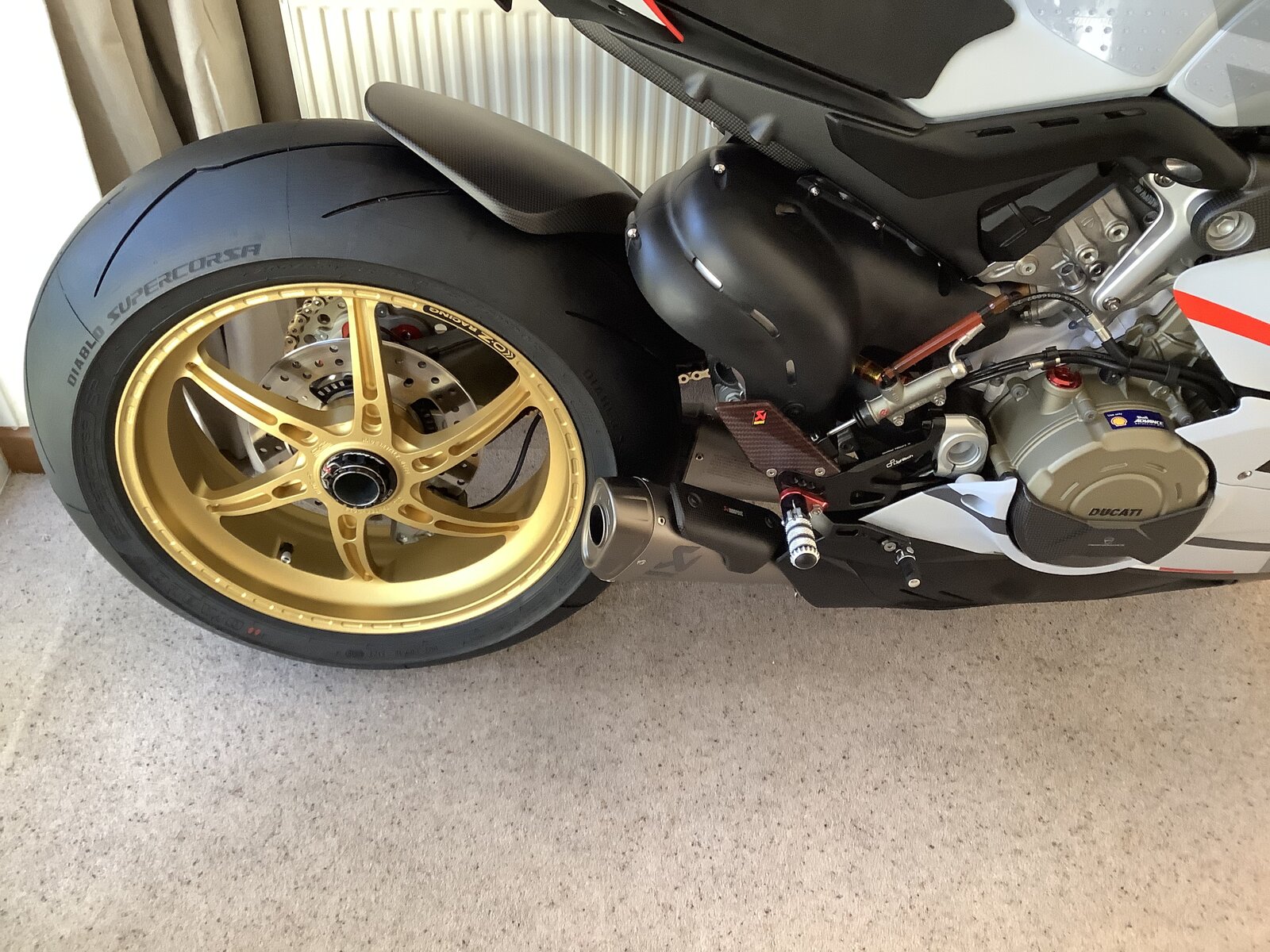

  7. Is carbon not an option?

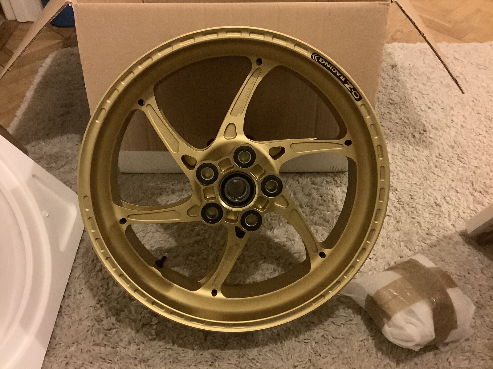

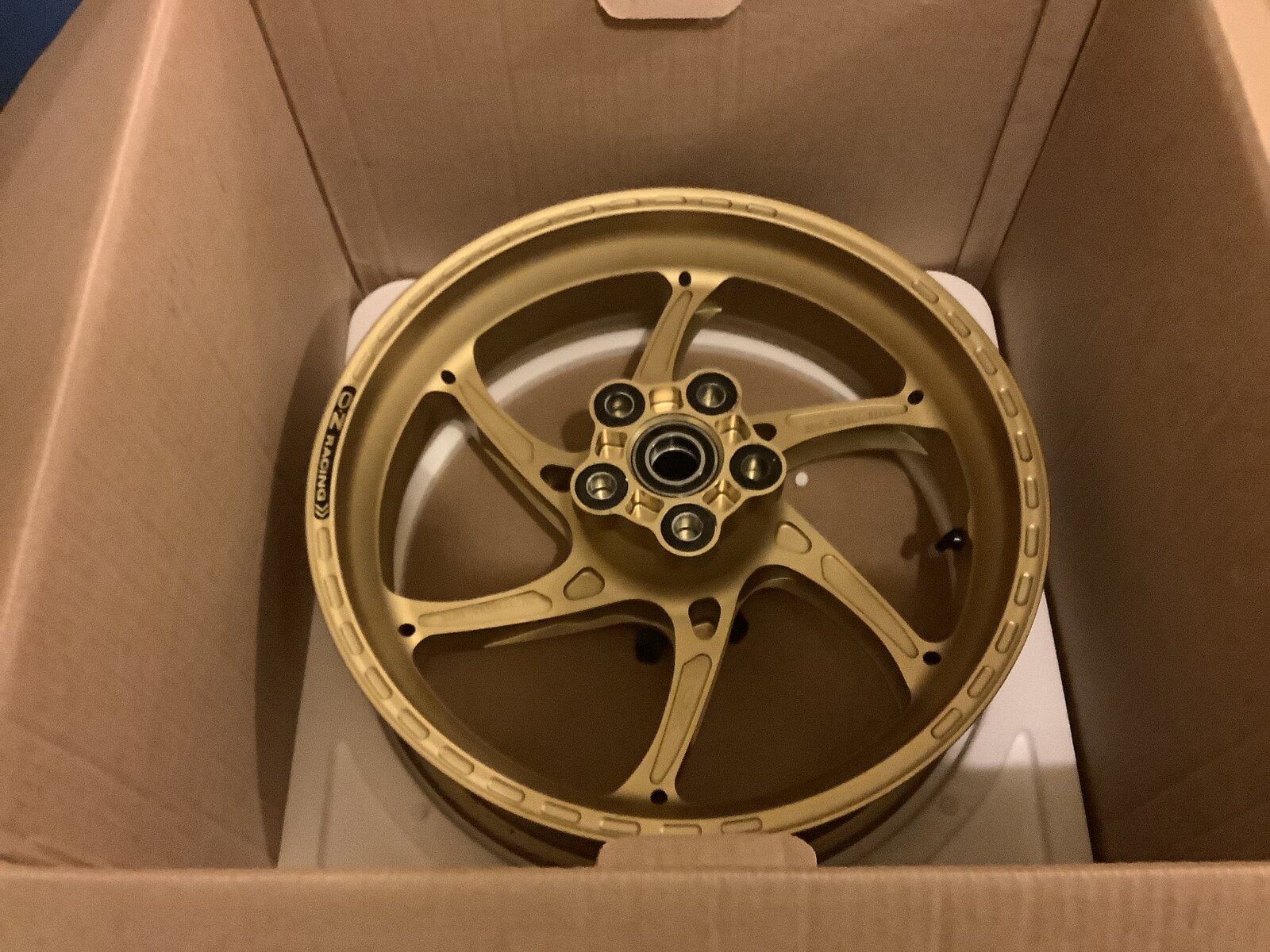

  13. My rear Oz turned up today:blush:
    FCBA0A2A-0F98-46ED-A50F-B555193E90BF.jpeg 4970A453-38F4-44C1-B25D-A8C0D961231F.jpeg

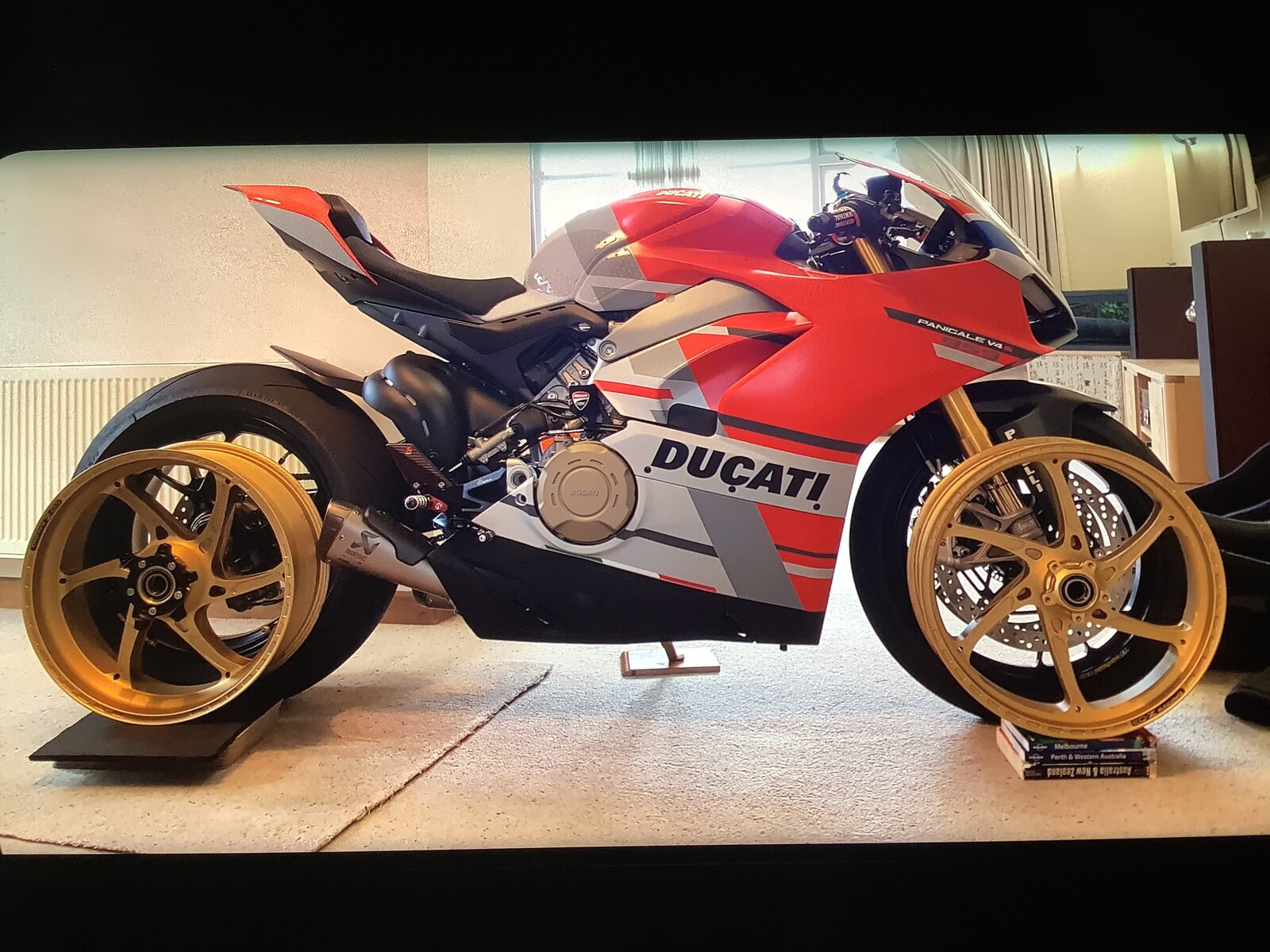

    I have done a deal with @Dave dunlop for his 959 GASS wheel - just have to wait for the front to arrive from Italy :sob:

  18. Will be worth the wait Steve :grinning:
    But for now your have to make do with another picture....
    7948192C-7165-4DBA-9FE4-80E2AD9F086C.jpeg FFECFEA4-318D-40FB-8317-C32B9FA54A8B.jpeg 94884B93-C4FA-4D39-8543-6BAD985A99F7.jpeg
