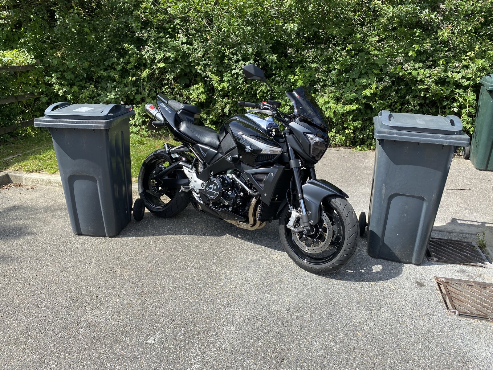

    Anyways with a bit of luck the 748s with be joining my 30 year old GSXR and 11 year old B-King.

    Oh and you forgot my bin

  18. Well seen as I just bin out for a ride…:bucktooth::joy::joy:
