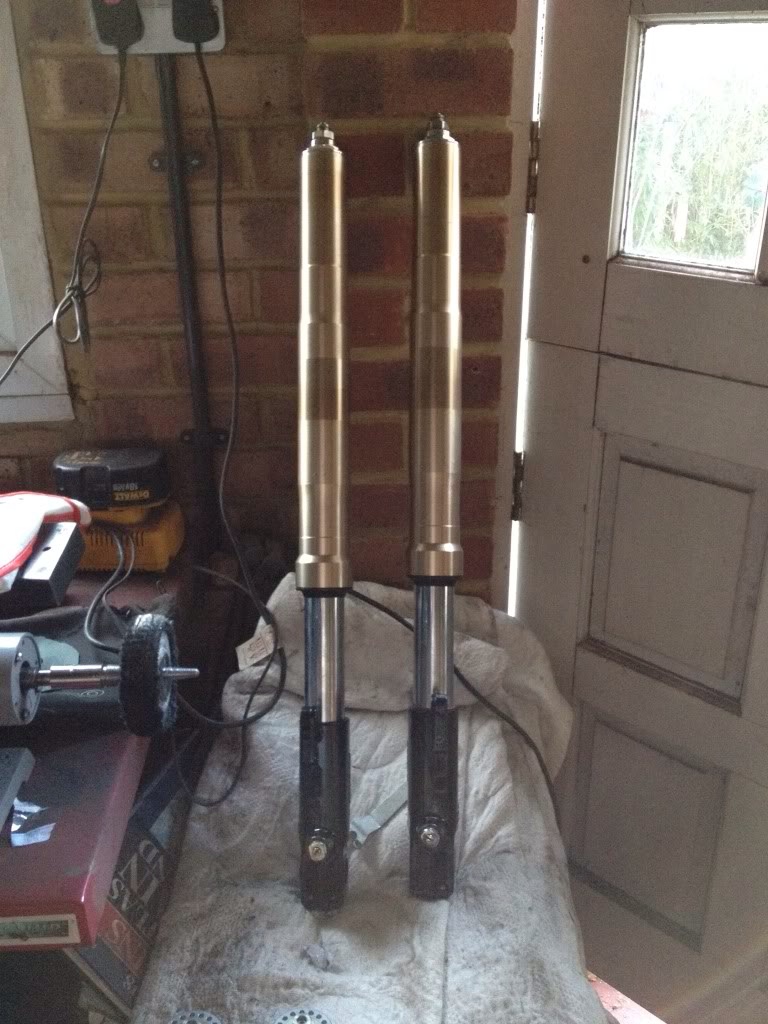

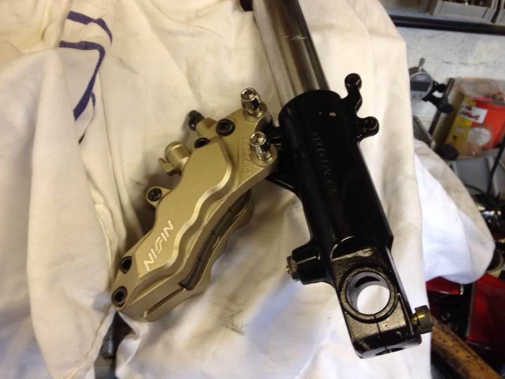

  1. image.jpg Would these fit? Bought them to go on a M750 but the calipers won't fit. Don't want to go to the expense of new calipers really (the onesie the pic aren't mine). £250 same as I paid on UKMOC image.jpg image.jpg image.jpg cheers

  2. Early forks, wrong caliper mount
  3. Thanks for the thought, Harry. As Bradders suggests, not an ideal fit for my late model Sport ie.
  4. Those are fully adjustable Showas from the earlier carbed SS's as Bradders says.
    If you can live with the smaller caliper bolt spacing they are perfectly OK.........Not much wrong with the narrower spaced calipers if they are in good nick........They would still have you off in a panic braking situation.
  5. just means new calipers and front spindle plus drop the front a little potentially, bit of hassle and extra cost
  6. All of this is doable, if need be.
