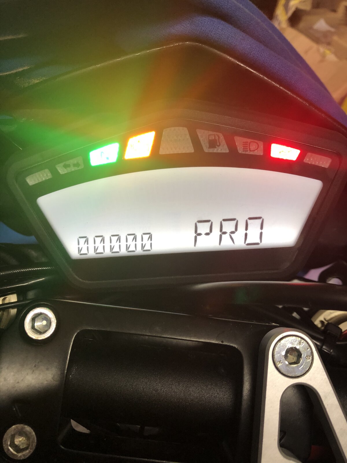

  7. I get to the key Program step but C95012AD-EEDA-4A93-A3BE-80D77C5C382F.jpeg
    it asks for a code and won’t accept the code for the original dash. I love my hyper but this experience has been painful and I’m not so sure the next bike will be a duke. The Dealer solution to a failed dash of a new dash (expensive but ok) plus new lock and keys and a new ecu (mouth watering price) even when I have both keys and the card code is taking the piss. So it’s off to Carmo Electronics who can hopefully resolve.
