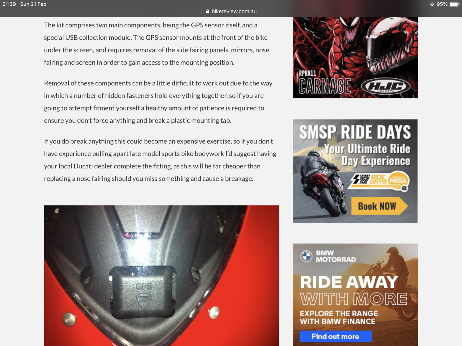

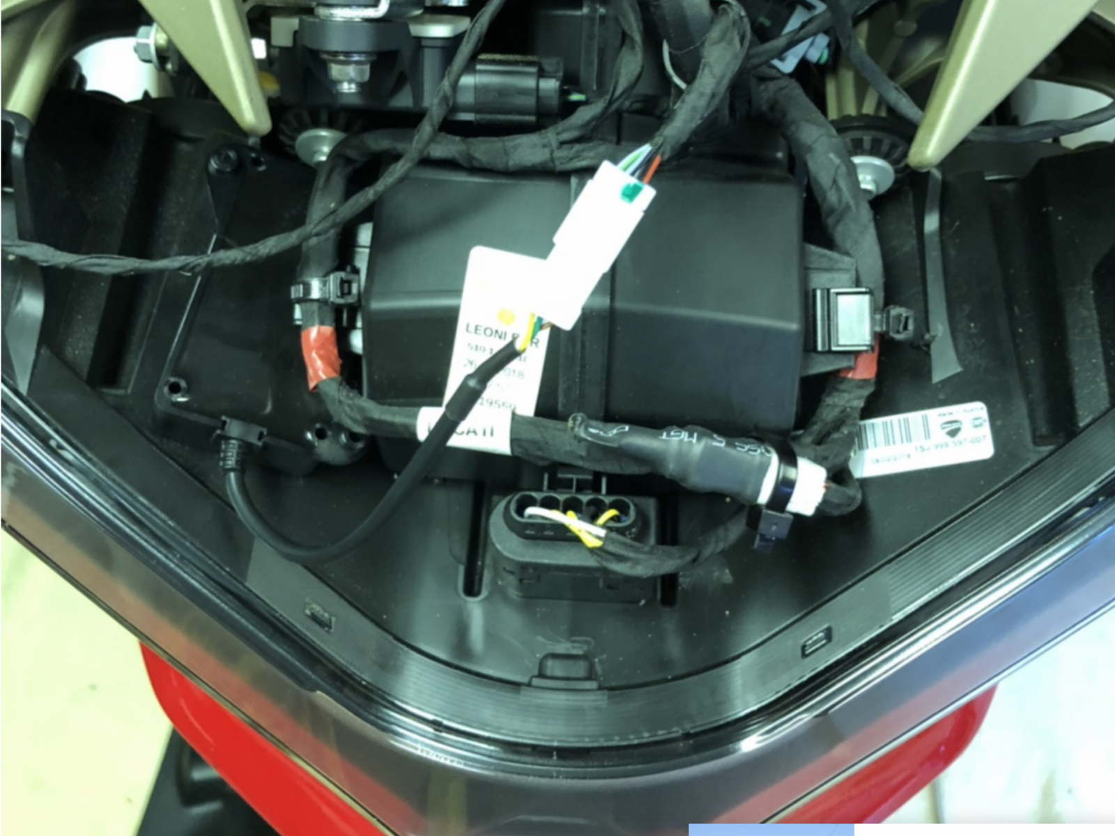

  1. Does anyone know where the GPS plug is located for the GPS module? Is it in the tail or the front fairing?
  2. located under the nose cone.... kind of inside the inner trim behind the screen...
    141F89A8-9C28-46B1-A8F1-3B3038294EFA.png 2D662E50-C012-4F92-876D-ED94CAE5B294.png
  3. Thanks Dave

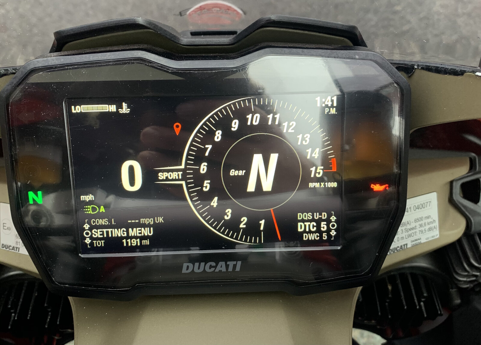

  6. B098A7D5-53D2-4A61-B7AD-3DE2AEF9140B.jpeg You need to have the GPS function activated by the dealer if not done already. Little icon at the side of the 7
  7. Im guessing they charge for this privilege?!
  8. I was wondering what that little icon was for.
