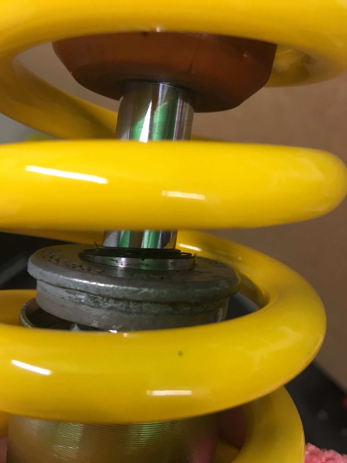

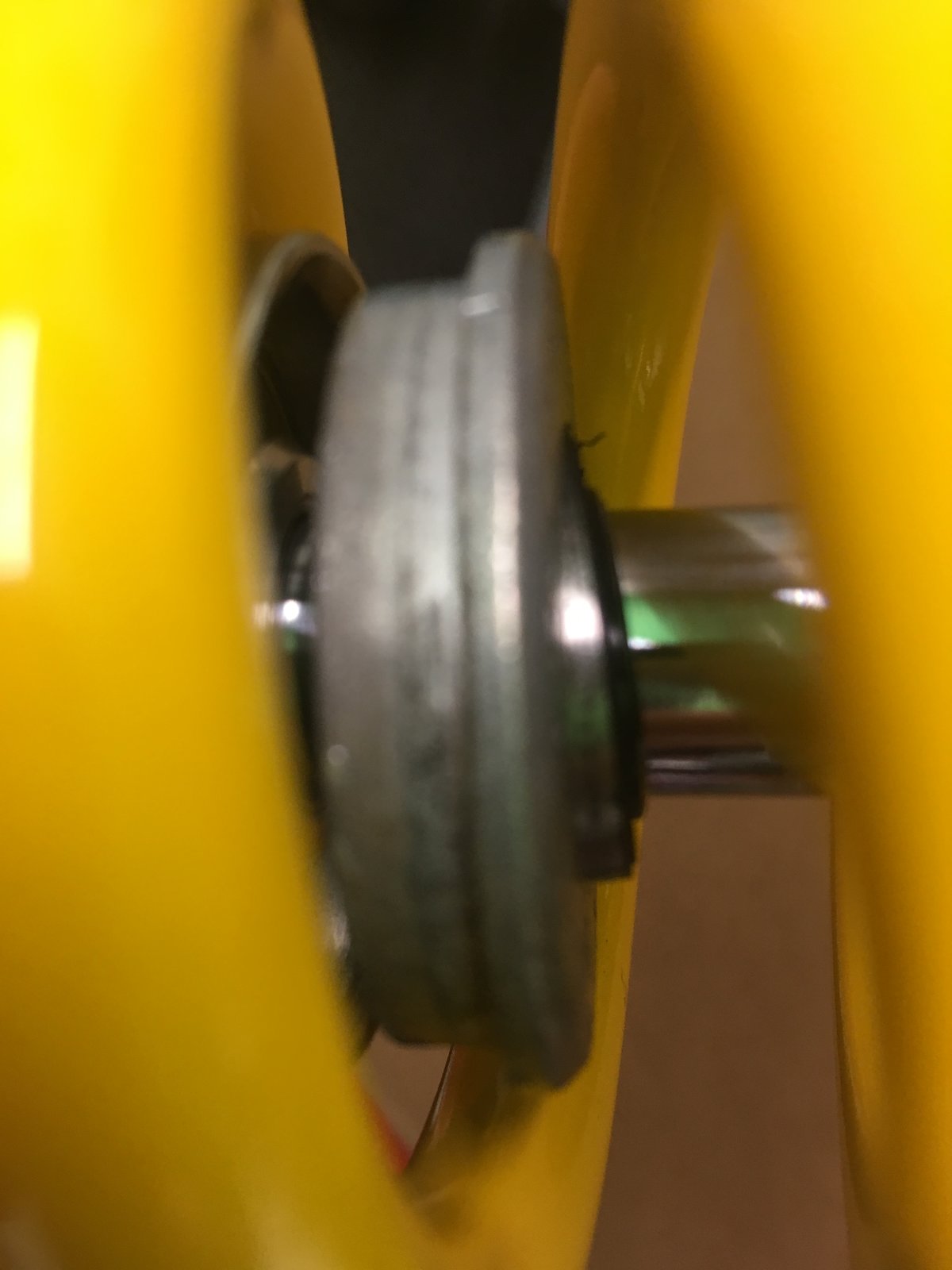

  16. I just ordered a ktech rear shock as my OEM one fell to pieces

  18. It didn't fail completely - that is just a scraper seal apparently. The shock has definitely deteriorated over time though so i sent it back to get redone.
    The new shock is way better
