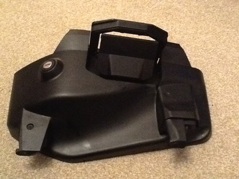

    Getting it apart is easy - to remove top piece which has handle and lock all integrated, remove 2 small screws on outside of pannier top piece, 3 small screws from inside and then 4 large screws also inside. The top piece then lifts off easily.
    The broken piece was withdrawn, the remaining part connected to the handle, is held on by a small c clip.
    Have both pieces, going to attempt to glue and see if that works, otherwise I'll see if the dealer can order the individual piece
  4. This is the removed top piece with the handle and lock integral

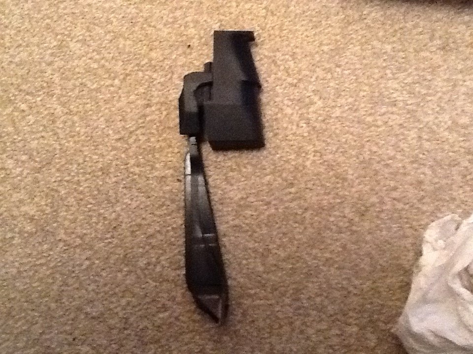

    This one is trying to show the underside of the top piece, might be able to make out the broken piece

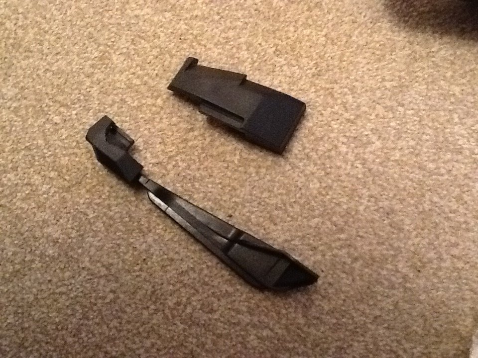

    This is the broken piece and the latch. Moving the handle, pushes the arm (the broken piece) back and forth which pushes the latch in and out
    This is the arm and the latch separated
    Have superglued the arm and reassembled, seems to be working fine but haven't tried attaching them to the bike yet.
    Reassembly pretty straightforward, although a bit fiddly reconnecting the arm onto the spindle which is part of the handle.
    If you need to try this fix, make sure the latch is in place before you connect the arm back onto its spindle.

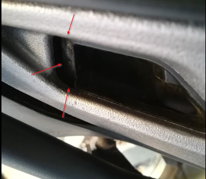

  7. Revival of old thread to put a question: I had the same issue has you but after changing the same part as you changed I noticed that the support itself in the bike was broken. I can't find the part to order.
    Anyone with the same issue? I ask myself if I should just replace it (after I knoe the part to order) or if I should create and adapt something more solid (in metal) over there.
