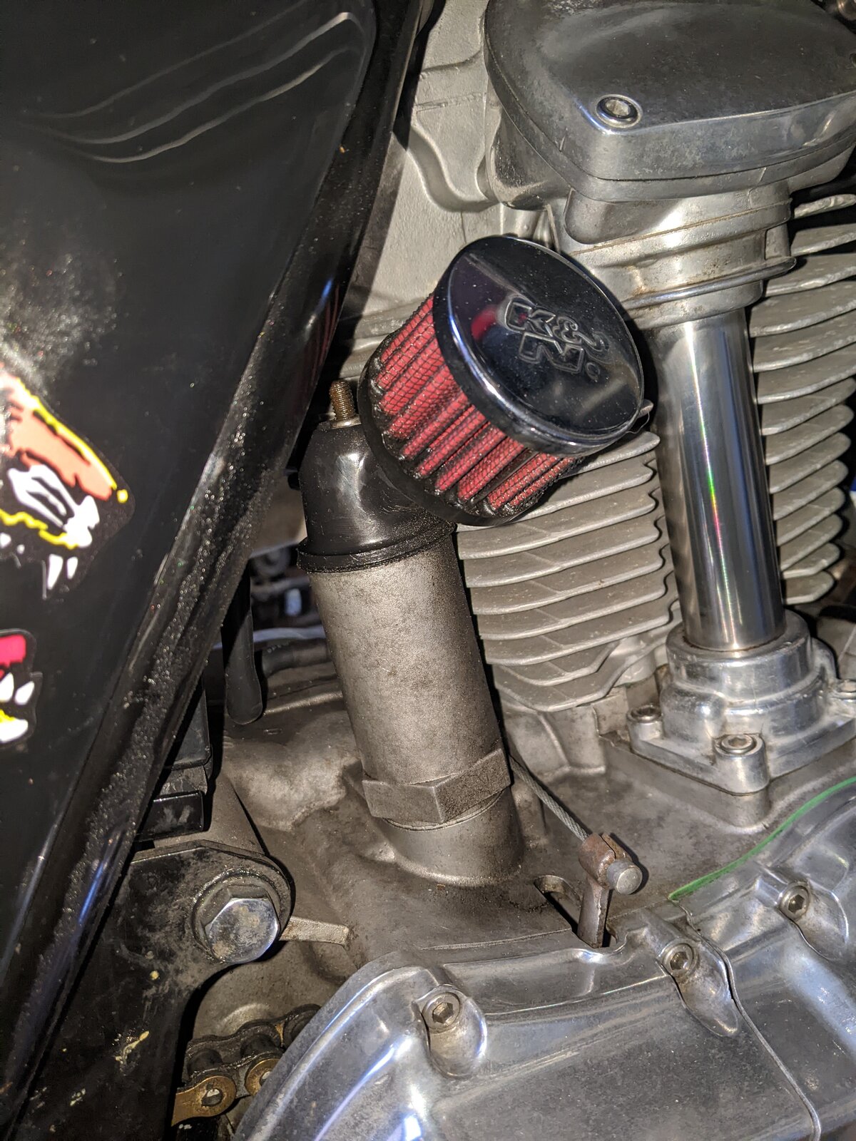

  5. Remember K&Ns require oiling periodically and this does help them filter out dust particles. I fitted them to my Darmah and the only issue I've had is what to do with the engine breather that is normally fed into the front air boxes.
    Another smaller K&N fixed that:
