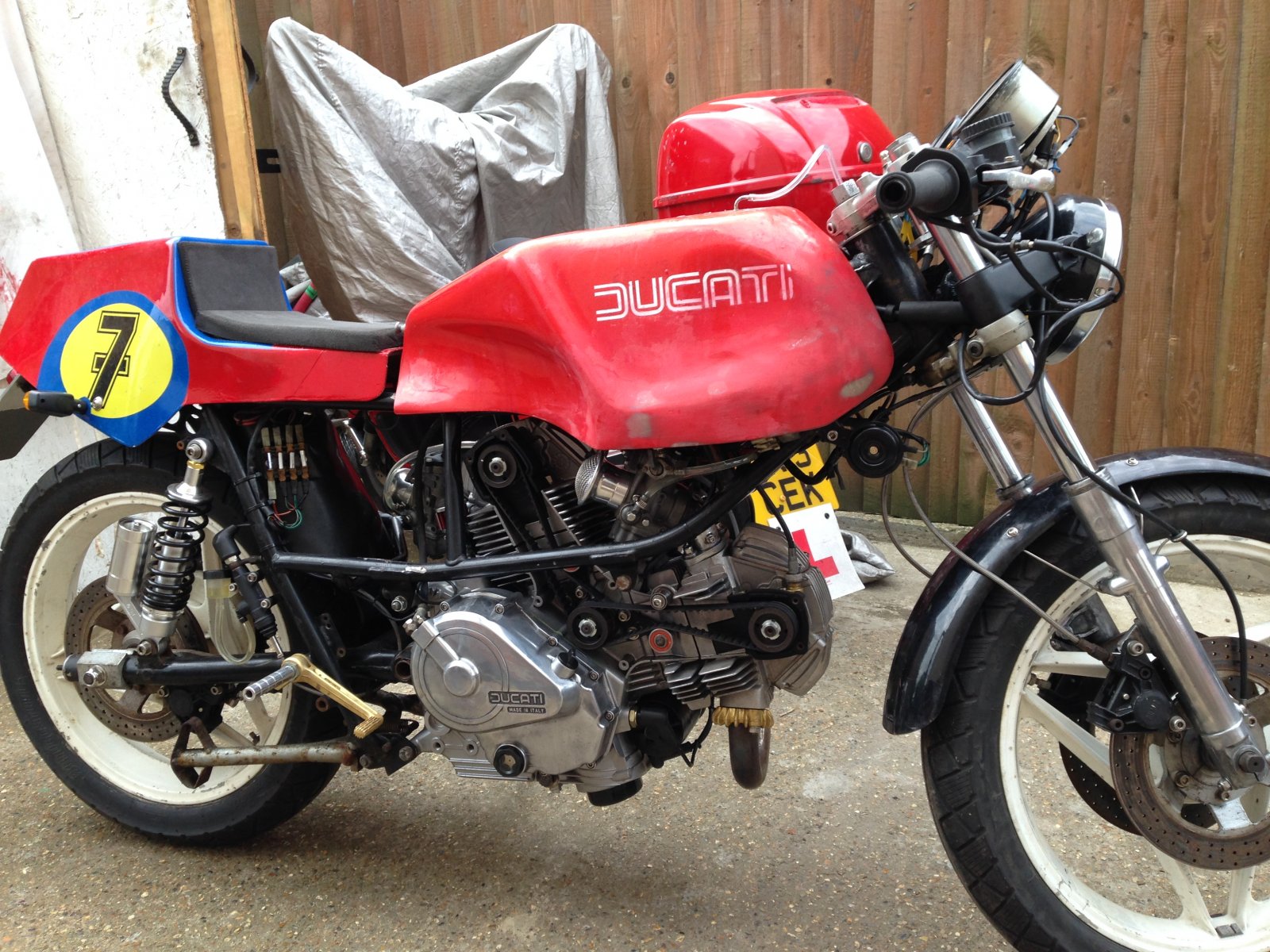

  4. image.jpeg A momentous day as I managed to get an MOT. A few niggles getting there. The first is tank sealant. Knowing the fibre glass tank is not capable of coping with ethanol I used something called bill hirsch tank sealant from hitchcocks m/s's. It looks like nothing more than pva glue and not very thick. After three weeks of 'holding' fuel one of the seams obviously became saturated with e10 petrol and split open. F**king useless product. I had to take out a 6-8 inch section of the tank and rebuild it. After making good I tried the more expensive caswells product. There appears to be a couple of products, this is a phenolic based product. A bit like making up a more liquidy expoxy resin. After about an hour of slowly rotating the tank with the product it's starts to set. Looking inside the tank it now has a glass like veneer of about 5 mm thick sealant. Looks really good and so far so good.
    I few ergonomic details to fine tune and a few longer than 2 mile runs to check its all good.

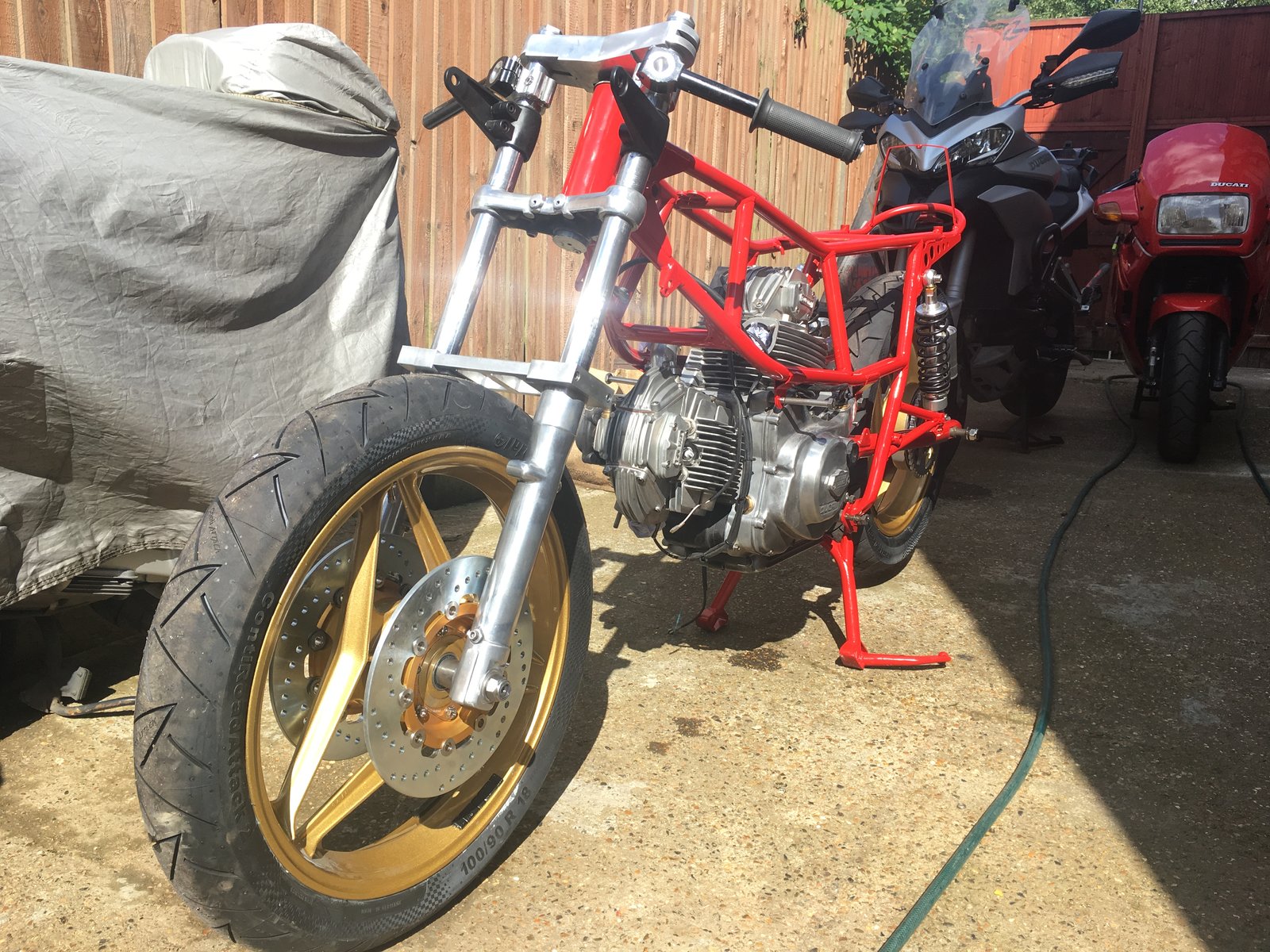

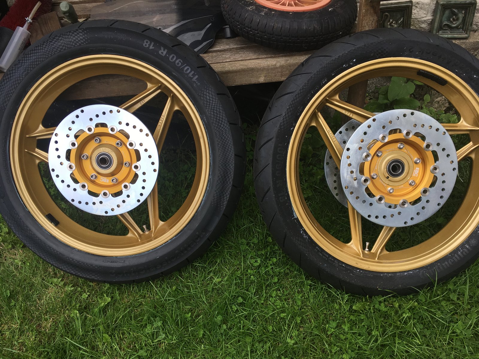

  5. image.jpeg Well, after what looks like a year of 'shake down' I have stripped the allazura/pantah project ready for a more cosmetic rebuild. Wheels were blasted and powder coated by TPCS who did a fantastic job I must say. I have found some floating discs marked up as for the pantah but are the same size as the allazzura with the Oscam wheels. Used some nice drilled titanium bolts so,it seems churlish to not wire lock them in a sexy racer style! (Also picked up some 4 pot brembo calipers and master cylinder as per most 90' ducatis). the oscams are designed for tubeless so I could use a conti road attack on the front and a conti road attack classic on the rear. I have a Moto gadget M1 magic box and have just knocked up the harness. Currently spraying the frame and swinging arm so new photos coming soon.

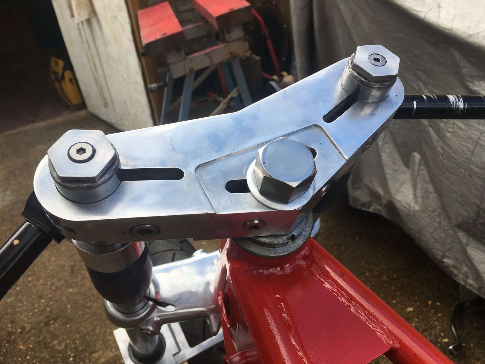

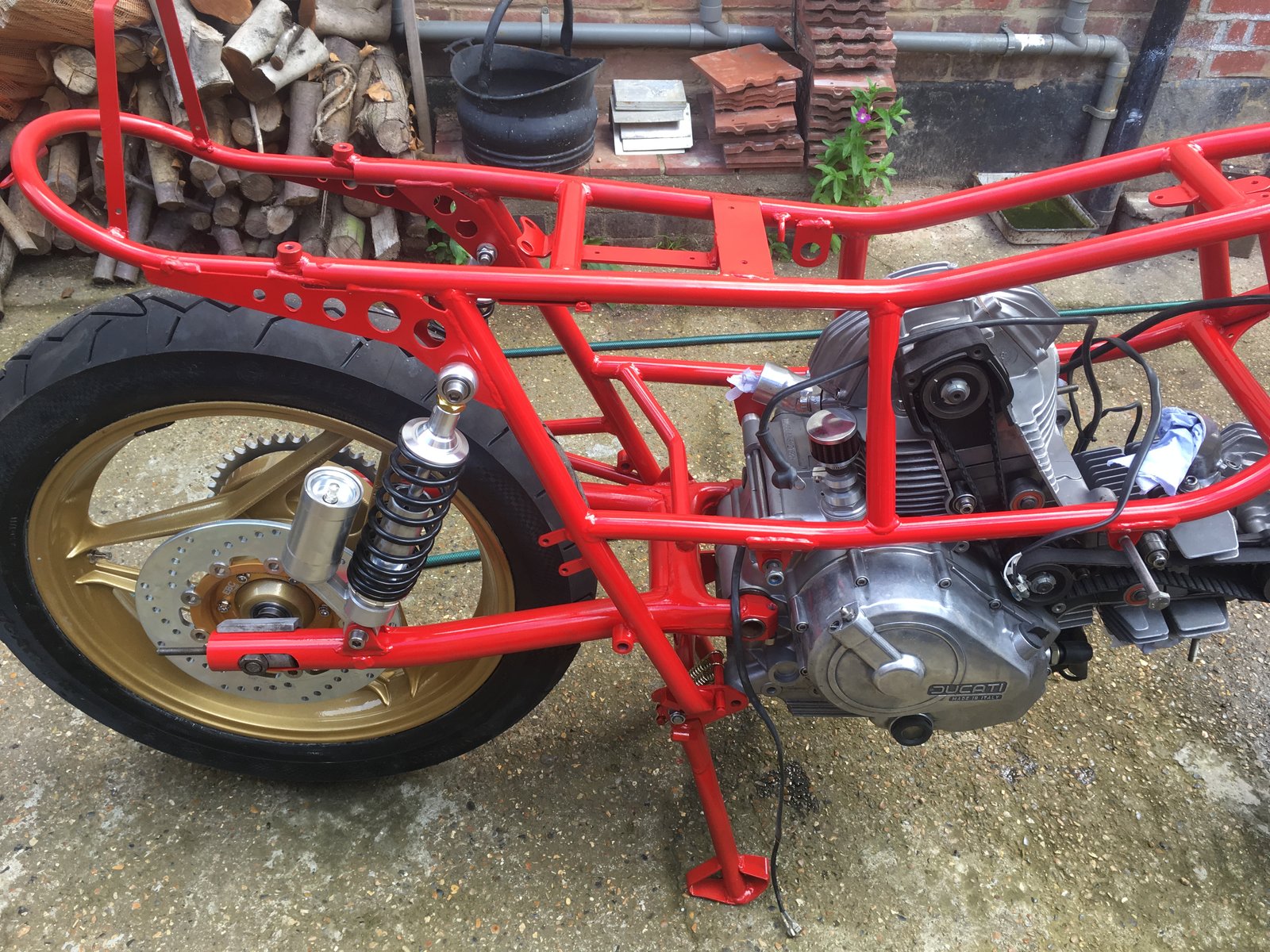

  7. image.jpeg image.jpeg image.jpeg image.jpeg Engine now back in repainted frame. My own top yoke machined from a solid lump of Ali. Also made a fork brace from Ali. Still a bit too chunky so I need to trim it down on the mill. One long stainless engine bolt to go and a pair of the fancy front ones. Also need to make a bracket for the gold 4 pot brembos I have picked up. Nearly there!!!
  8. A wonderful post that shows what passion Ducatisti have. I read it in awe as this is something that I could never do ever!!! Many congrats.:)

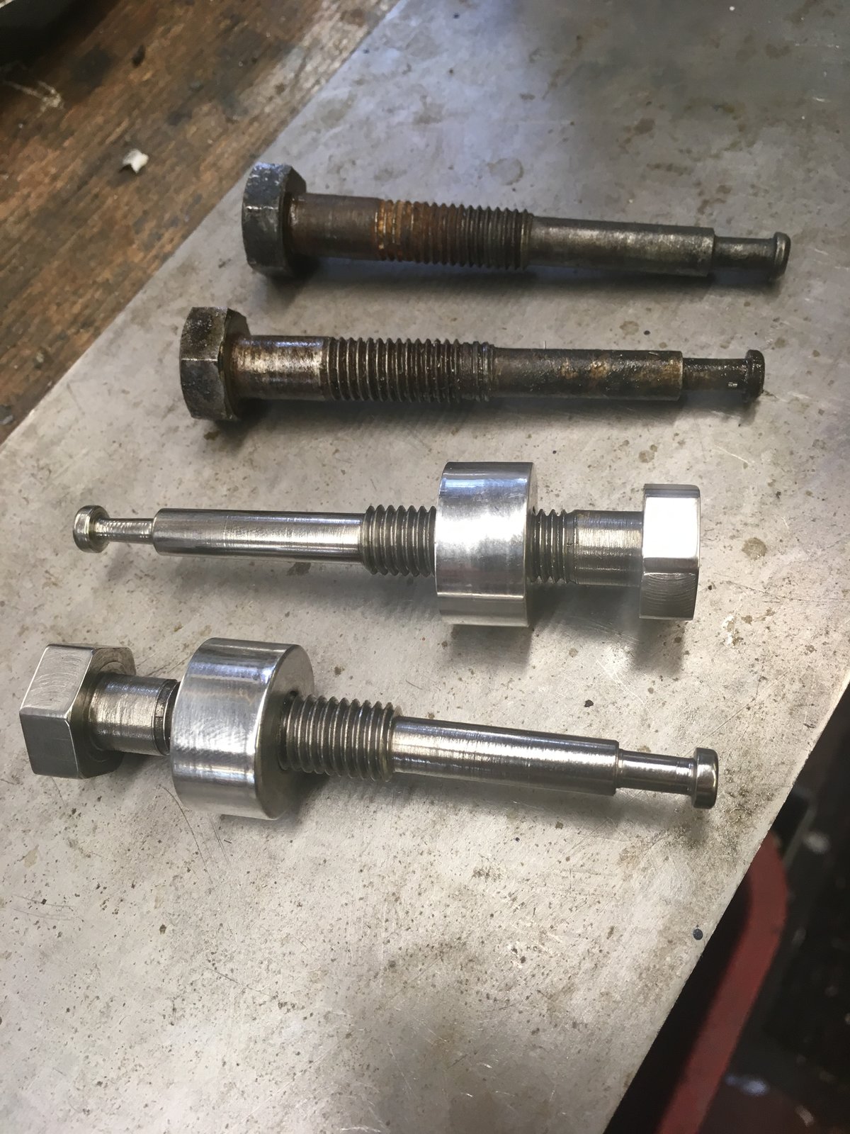

  9. image.jpeg New front engine mounts turned up in stainless and spacers (Ali).
    Don't ask me to make you a pair as I suspect I will be on less than minimum wage!

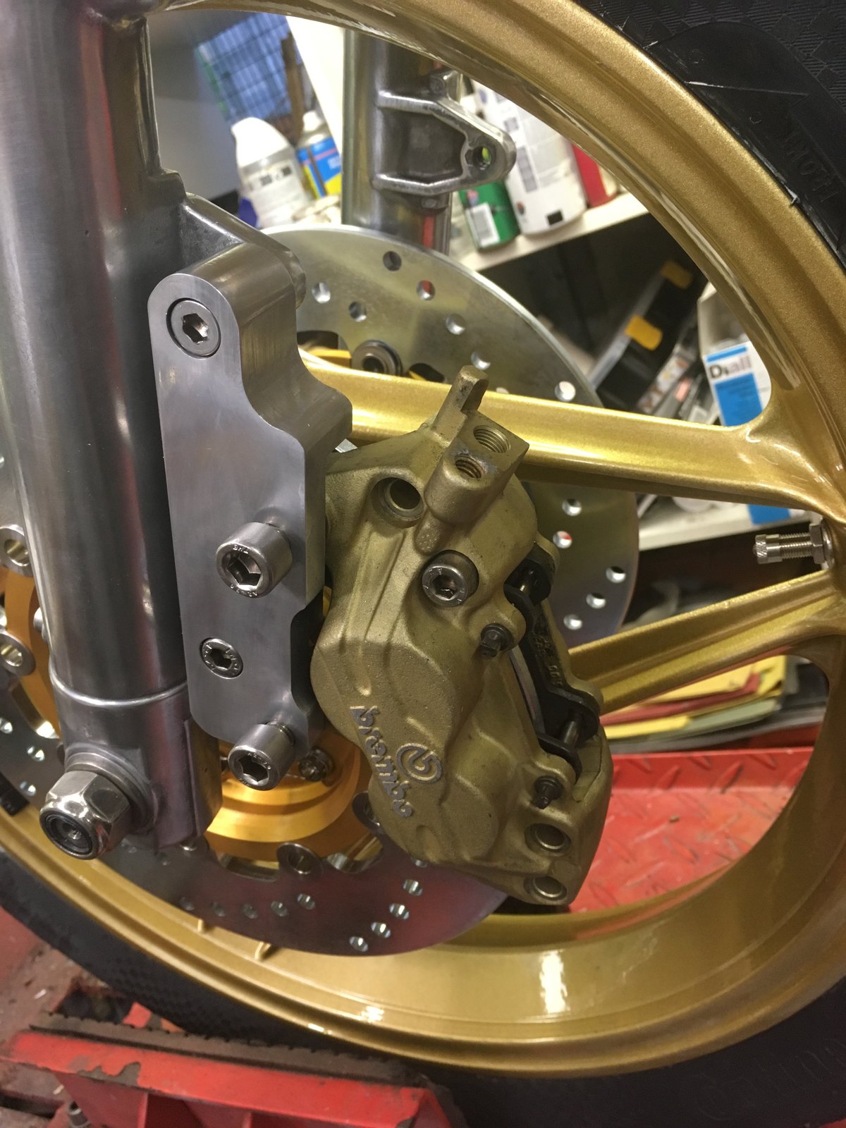

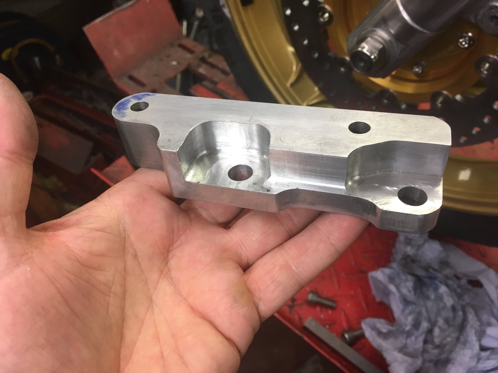

  10. image.jpeg image.jpeg Needed brackets to fit the later 4 pot brembos. A bit of a fiddle measuring up and making but hoping the LHS will be more of a breeze. Those bolts are temporary- final version will be titanium.
  11. image.jpeg image.jpeg Needed brackets to fit the later 4 pot brembos. A bit of a fiddle measuring up and making but hoping the LHS will be more of a breeze. Those bolts are temporary- final version will be titanium.
  12. Bravo , sir
    Are you making your own titanium bolts?
  13. LOL! I wish! Stainless is a battle enough for me. Titanium is a material too far. Happy to knock things up in stainless and aluminium but the pain gaining the skills to machine titanium is a step too far.
