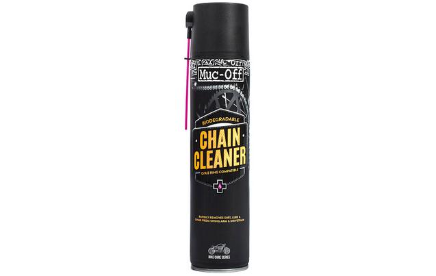

  1. Me too. A quick spray, wait 5 minutes, wipe off with a rag and lube with Muc-Off chain lube
