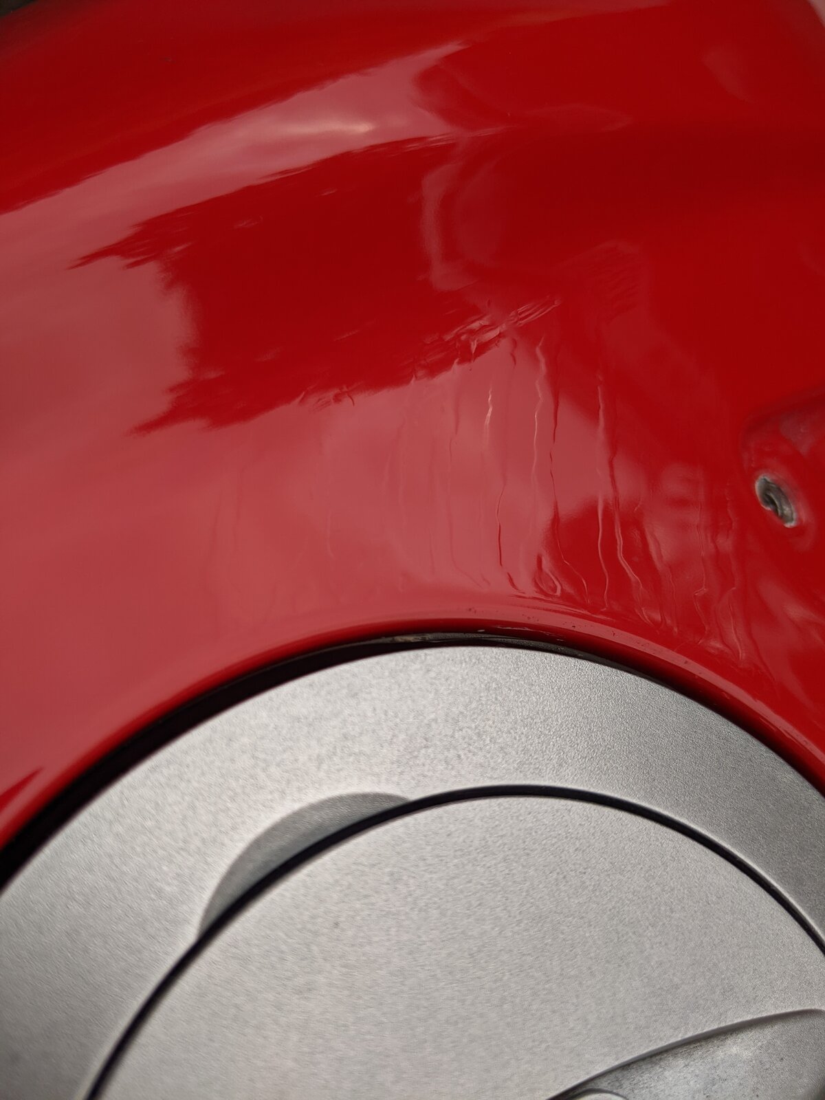

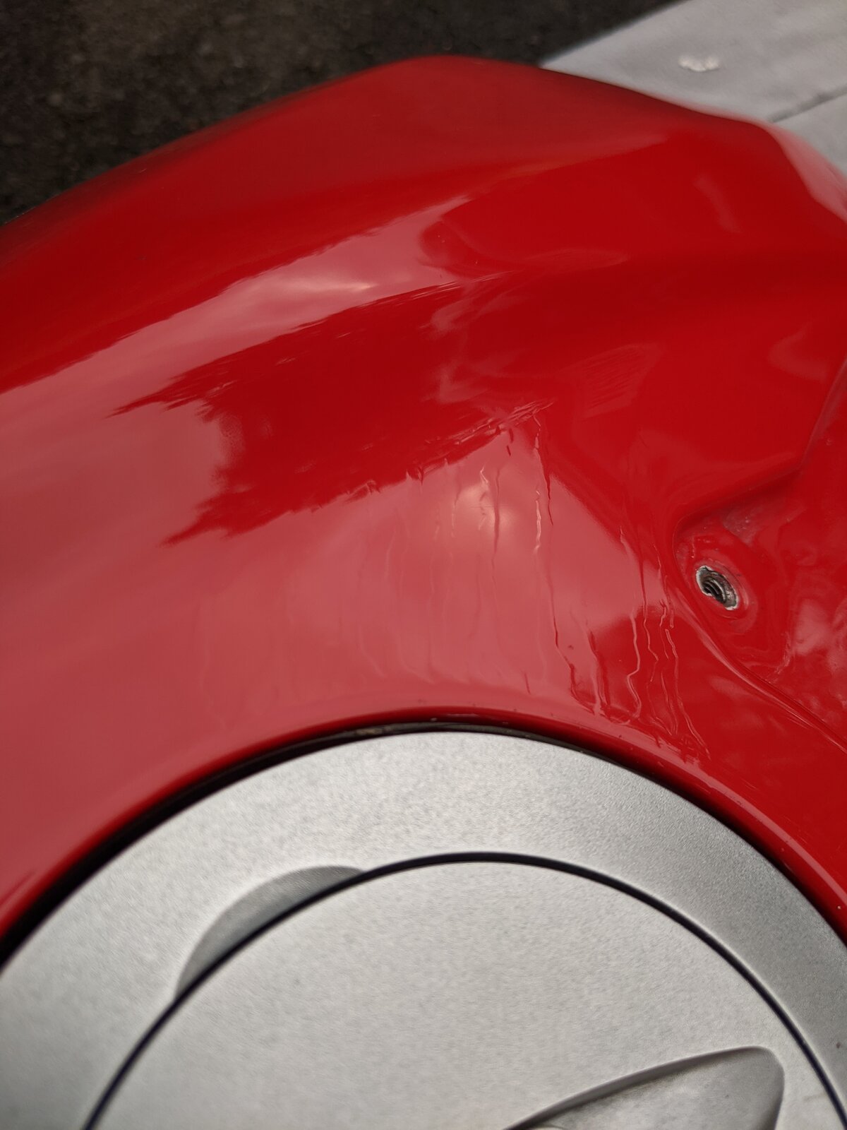

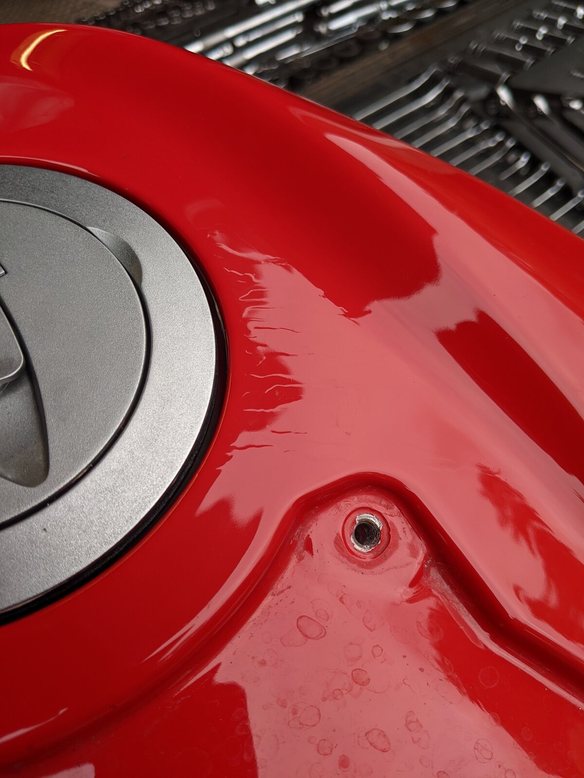

  1. Long story but I have ended up with petrol stains on my tank. It's a plastic tank.
    Do you think it's possible to remove them or is it a respray job?
    Any advice welcome,
    Thanks.
  2. Perhaps professional cutting compound paste on a mop head with the petrol cap removed.:thinkingface:
  3. Might get away with a polish as ^^^ but the clearcoat looks to have reacted there.
  4. Thanks all. I suspect the tank is faulty, it's been leaking out the overflow pipe near the exhaust. It leaks even when the tank is empty. I went on holiday and got nervous about the leak so bunged the overflow. This caused some kind of overpressure event and forced fuel out the top. :(
    I took the tank off last night and noticed that there is something wrong with the overflow nipple. It's loose, like its not attached to anything inside the tank. Reading the part fiches suggests that the internal pipes are part of the tank and not replaceable. Its £1755 for a new tank!
