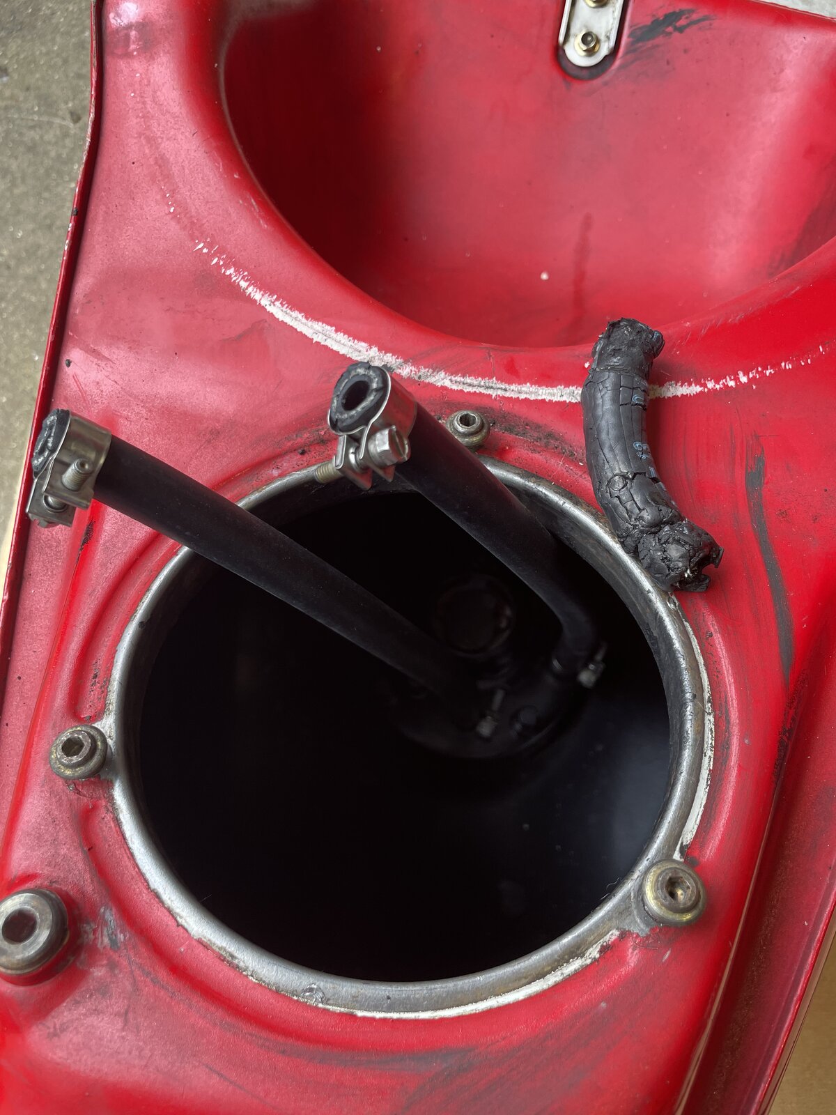

  11. My 916 has some kind of black lining/coating inside the tank.
    Not leaked yet and the last time I looked in there it all seemed intact.
  12. thanks - does it look factory/original?
  13. Well, I bought it new and that's how it was so yes I assume it is as it was made.
  14. Inside of a 1995 748 tank showing original factory finish (plus 11 year old petrol damaged fuel hose!!).
