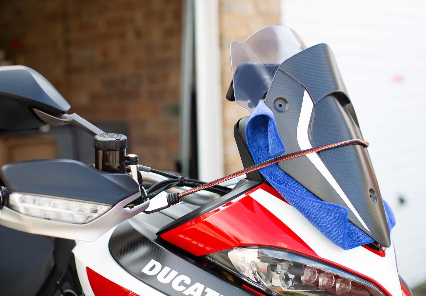

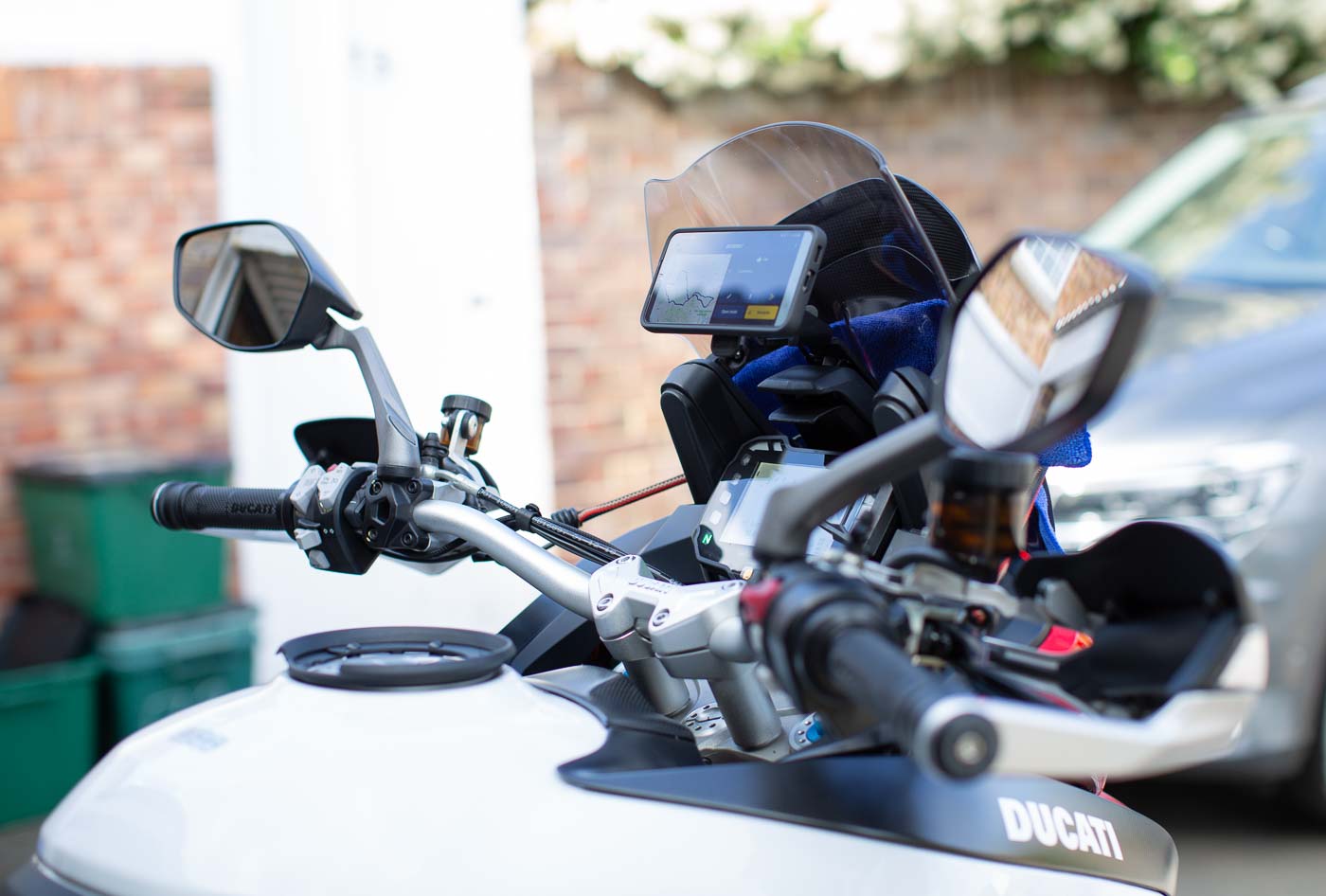

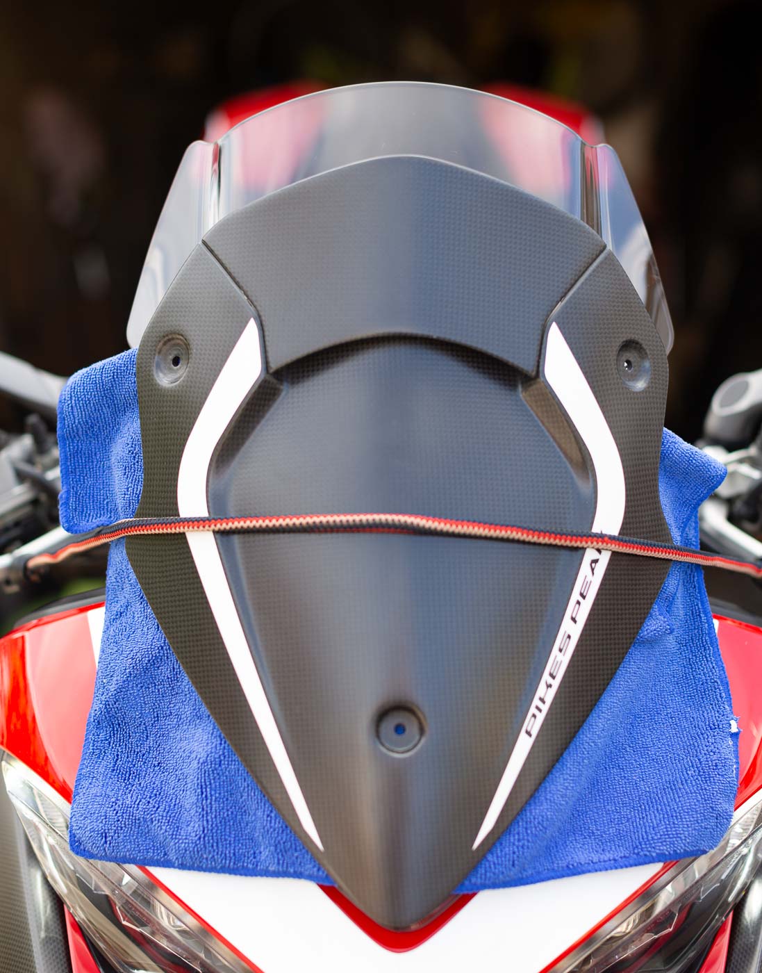

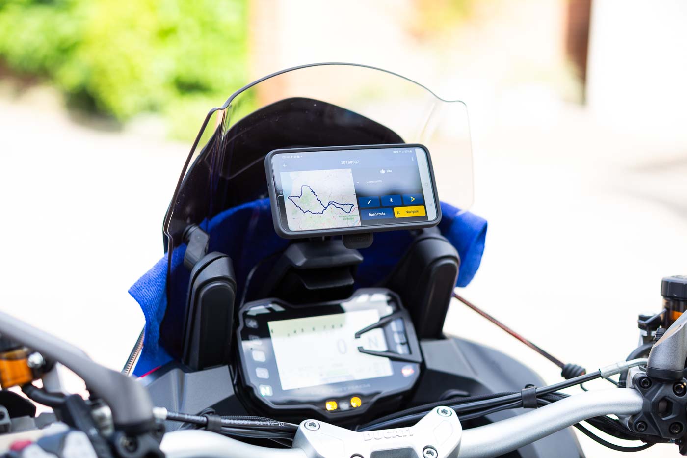

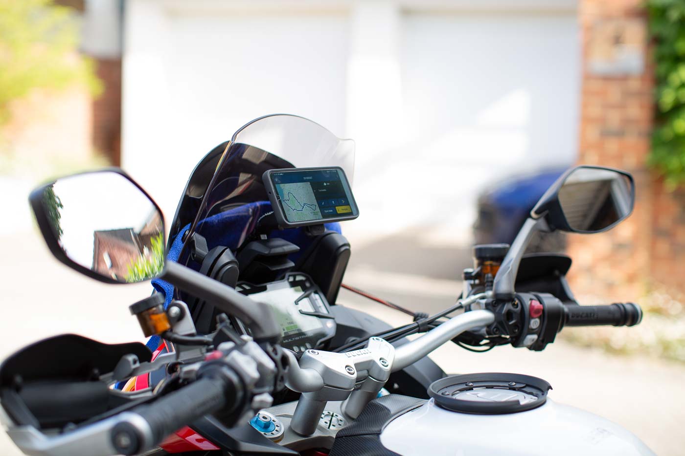

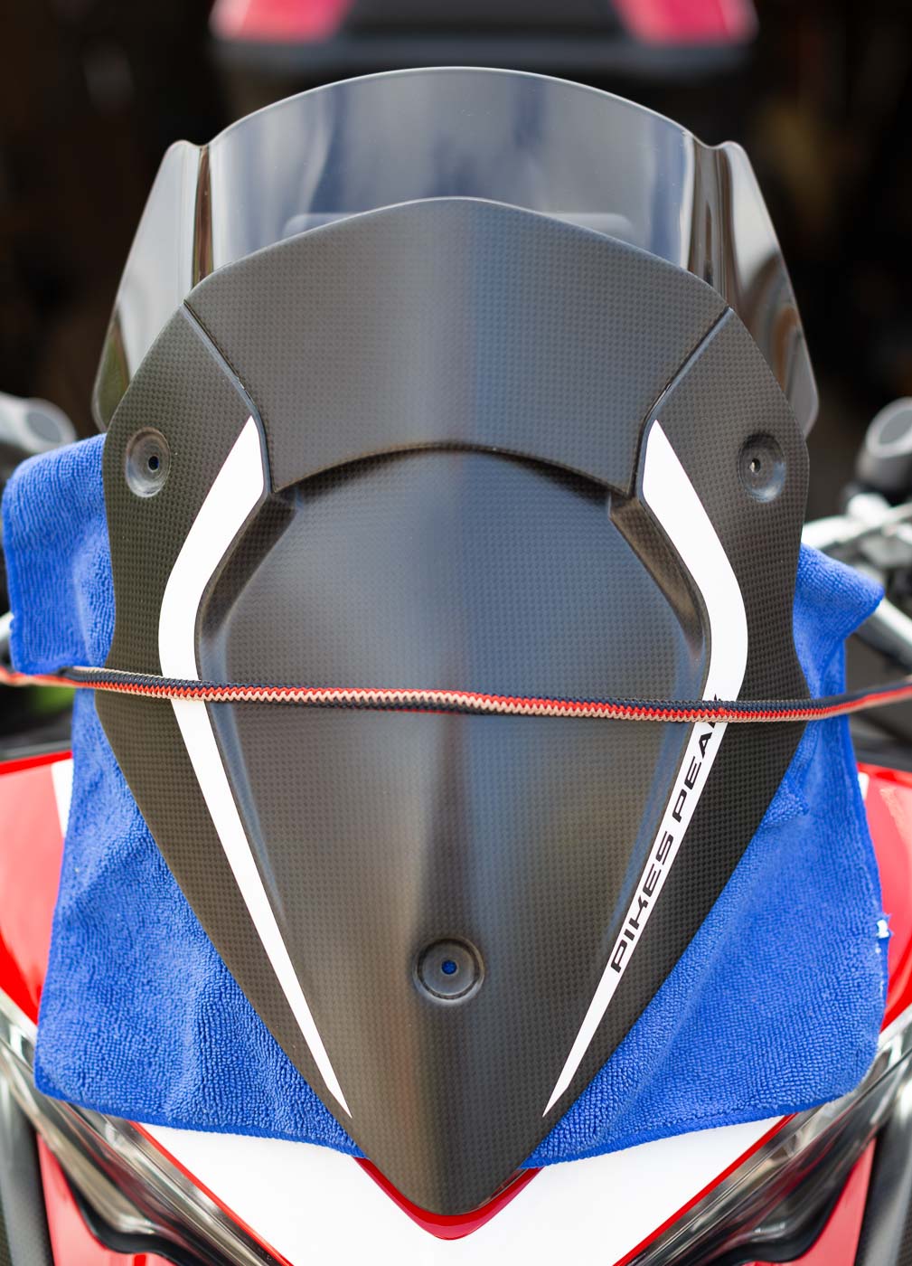

  8. Further to my message above here are some pics of my Samsung Galaxy S22 (approx 3"x6" in Quadlock case) on the Evotech mount. You will note that I have bungied the PP screen to the outside of the Puig Sport screen with a rag in between for protection. The screen is aligned with the screw holes as best I could. The Puig screen is on Iconic screen spacers, so as well as being further forward it's more upright than if you just had the PP screen mounted. Not sure how close the phone would be to just the PP screen but I reckon it would be an OK fit. The trunnion of the Evotech mount can be easily inverted to adjust the height a little if required whist still maintaining the same angle of presentation of the phone.
    The two head-on shots are: one level with the ground, the other standing, shot from head height, 4 or so feet in front of the bike. In the former you can see that the phone is behind the screen, the latter you can see the tops of the corners of the case.
    HTH
