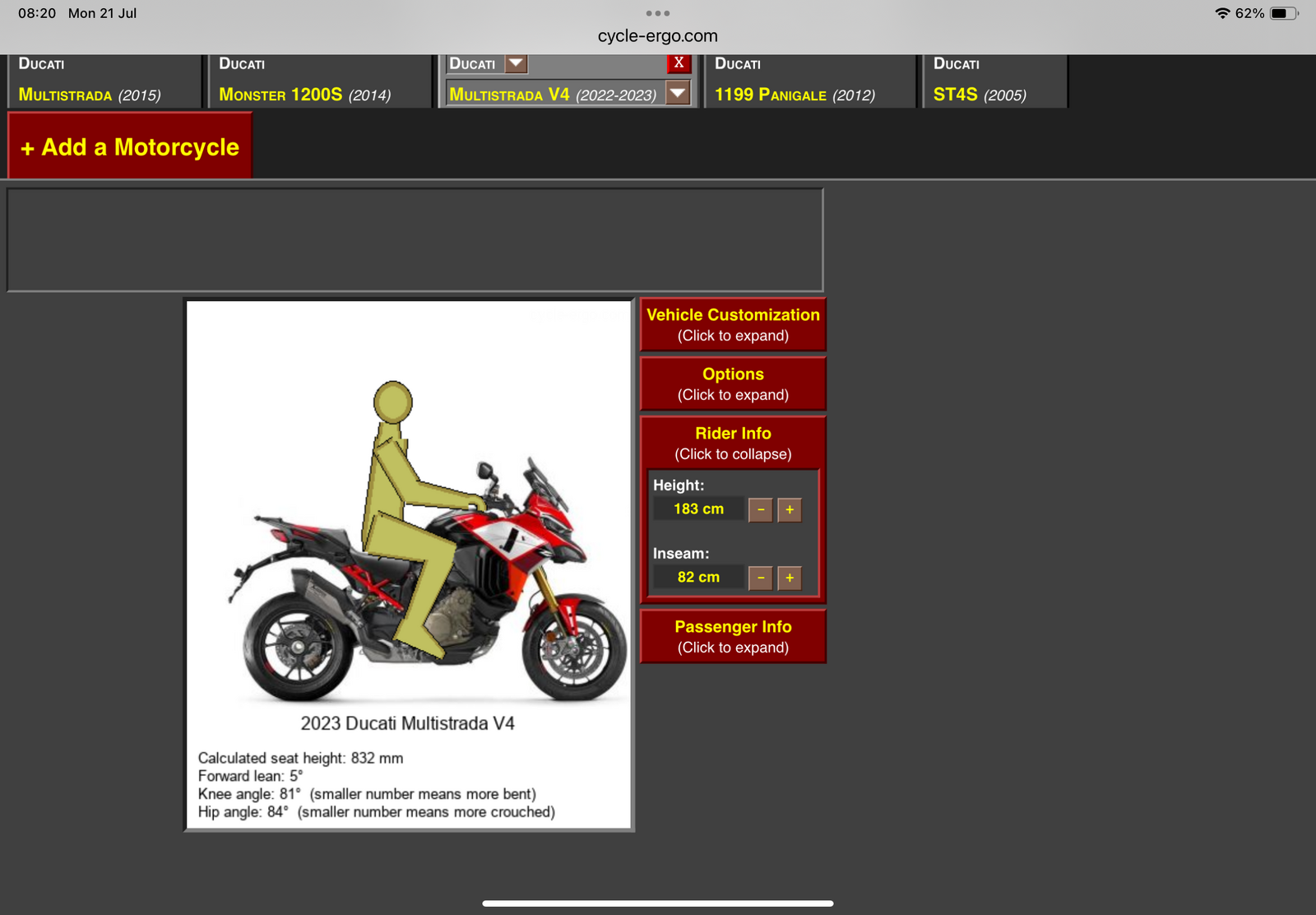

    I think you’ll find the Dunlops are a huge improvement but as you are well aware the GT’s are for heavier bikes so that may mean even stiffer carcasses. You’ll need to experiment with lower tyre pressures.
    Also, you’re probably sitting bolt upright on a V4, (normal) which will transfer pretty much all of your weight to the rear tyre, hence lighter steering.
    You can put your height etc in and it’ll confirm what you must already know about your sitting position. Although you’re slightly more prone with the PP compared to the standard V4. Why not input details of the older Multi you had and compare positions. No prizes for guessing the results.

  9. Oddly, according to the figures, I’m leaning further forward on the Pikes Peak than I was on the 1200, go figure. Andy
