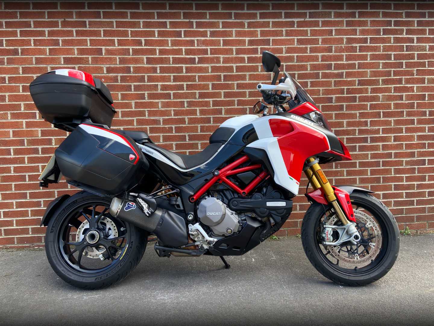

  4. Having owned a 1260s for the last 6 years, but having written it off in France at the end of June, I've indulged my lust for a 1260 Pikes Peak that I couldn't quite justify at new prices back in 2018. Out of the replacement options I considered there were only two contenders; the Pikes Peak and the Grand Tour, in the end the PP won the day.
    I wasn't too sure regarding the colour scheme compared to the GT, traditionally preferring more understated livery. However, 'in the flesh' I'm rather smitten. More of interest are the Ohlins suspension and those wheels.
    The bike I'm buying comes with touring pack, top case as well as evotech rad and head guard. All parts I would have fitted myself. I also have a raft of useful parts from my old bike that I've cleaned and, in a couple of places, repaired where necessary to be fitted over the next month or two.
    I was meant to collect this on Saturday but given the forecast, which implied rain of biblical proportions, I put that off until this week. As it turned out Saturday would have been fine... grrr! Aside from a test ride I'm not really qualified to give an opinion on the differences but will report back when I have. She does need new tyres which I have here waiting to fit, as a result the ride home won't be a definitive first impression.

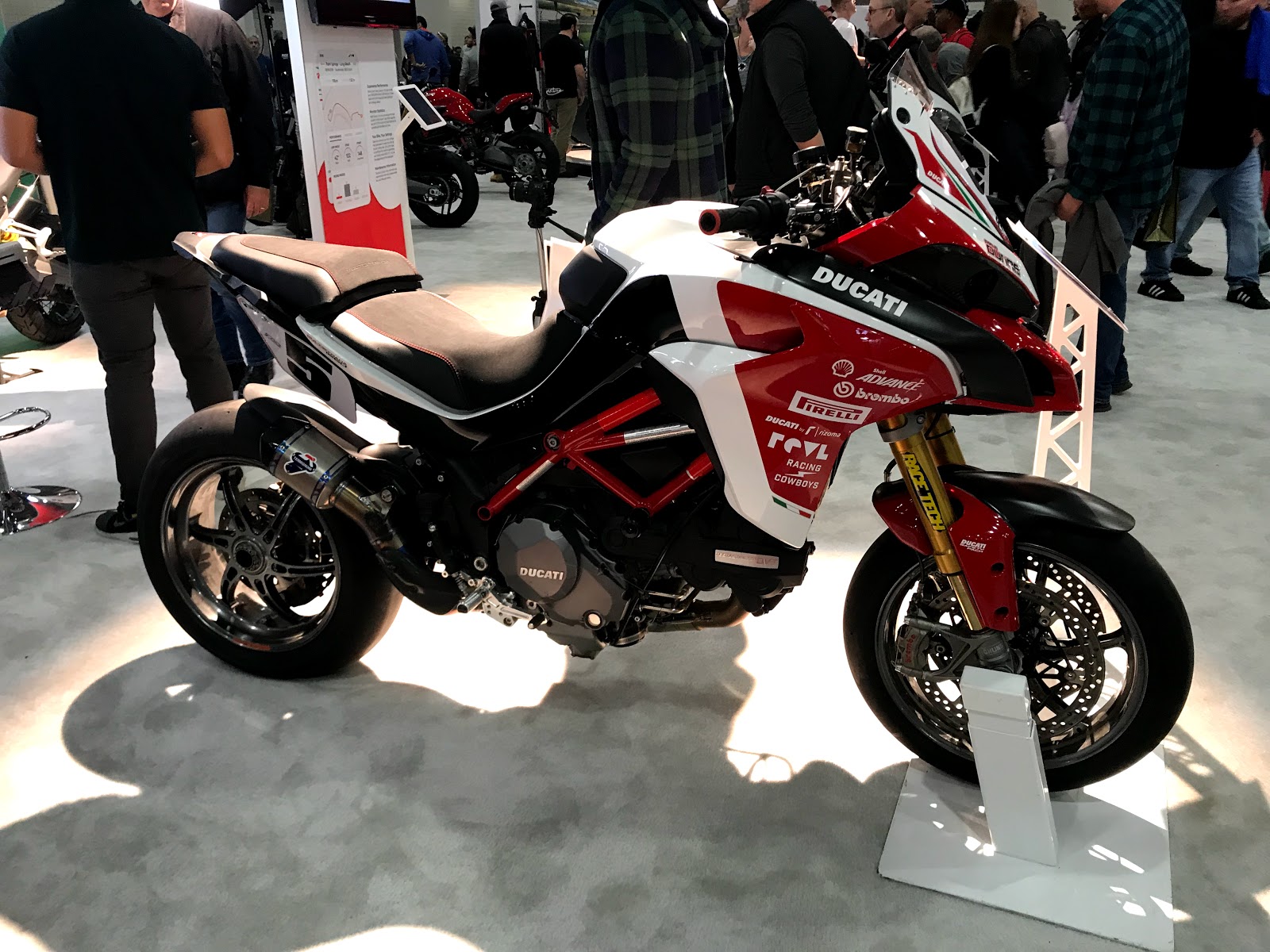

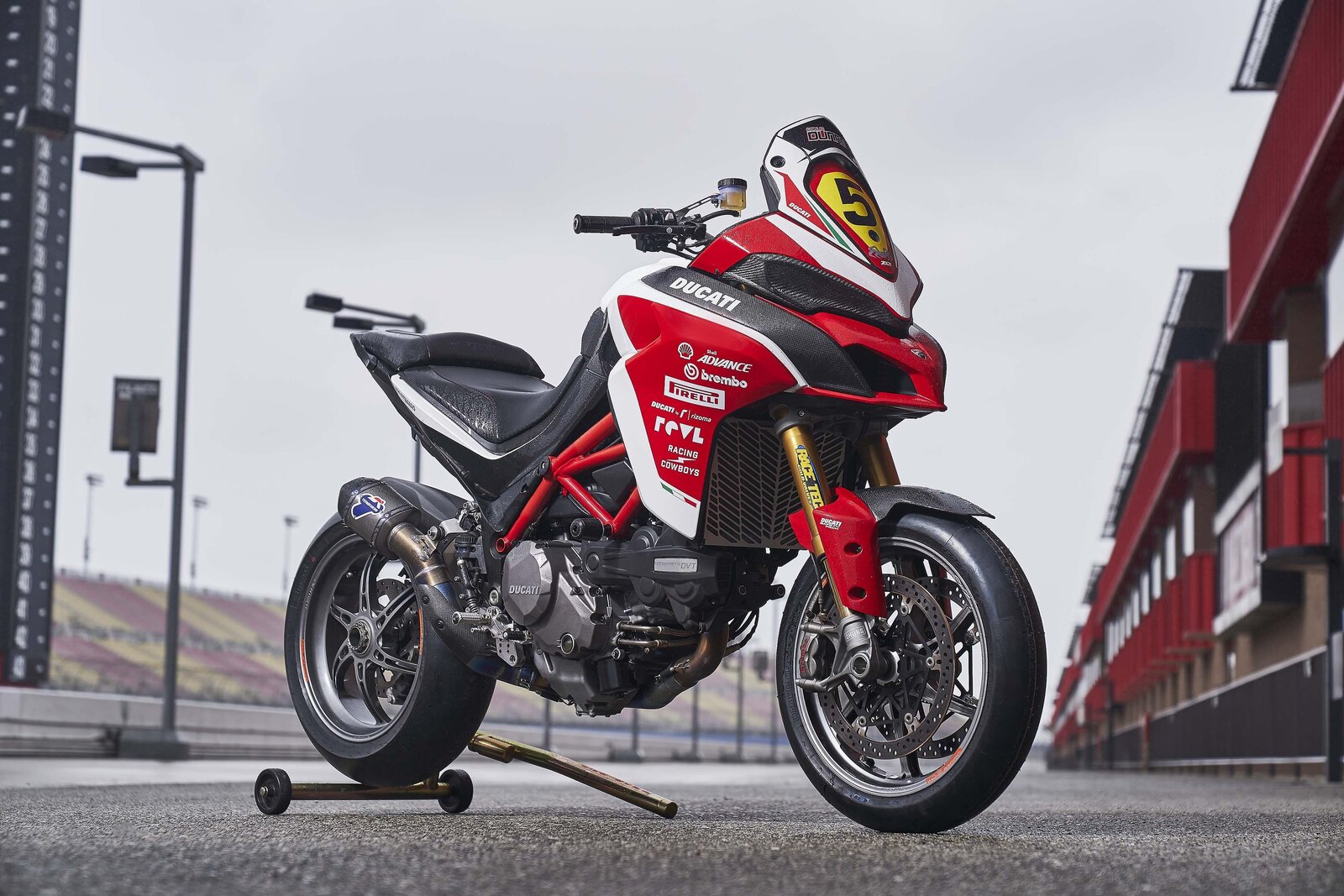

  12. Both are really nice and yes, super expensive.
    Carlin Dunne had those Oz Gass wheels on his winning race bike.
    Notice the rear-sets too.
  13. I've stared at that photo for hours, he also has the Rizomo rearsets I think? One of a kind as far as I've seen (well, 2 sets for both race bikes).
    I still can't decide on the wheel colour...
  14. I've read somewhere that they're Rizoma's also.
    Long shot but have you reached-out to Rizoma for a price?
  15. A while back, but I never got a response, @DarR
