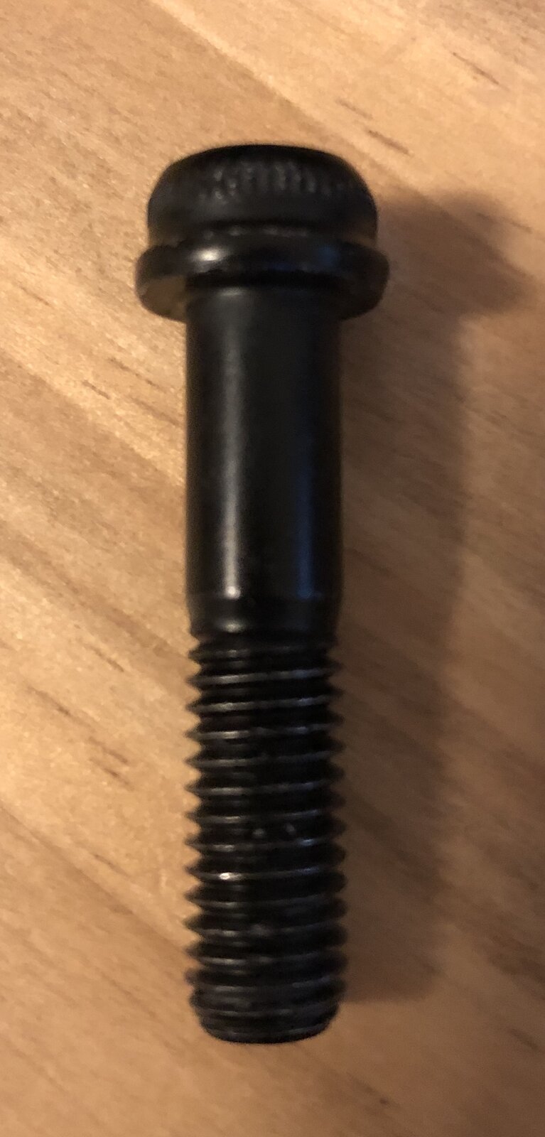

    This is the actual bolt that came out, ideally need a bolt half the length & full thread

  5. Number plate bolts are 6mm, footrest bolts are 8mm.

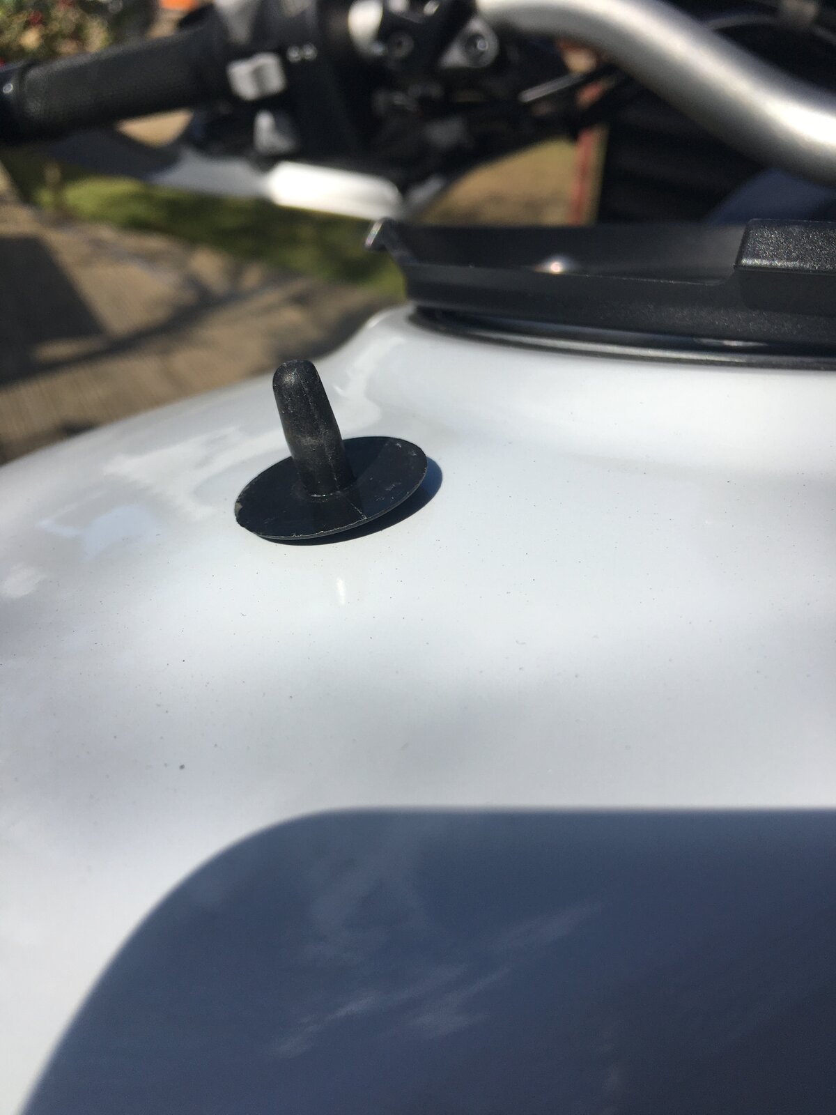

    I used plastic blanking caps, from Halfords. Pack of 8 for £5 or thereabouts. look great and cheap to replace if lost.
    Similar to the pic but actually have a threaded stud on the reverse and are almost perfectly flat.

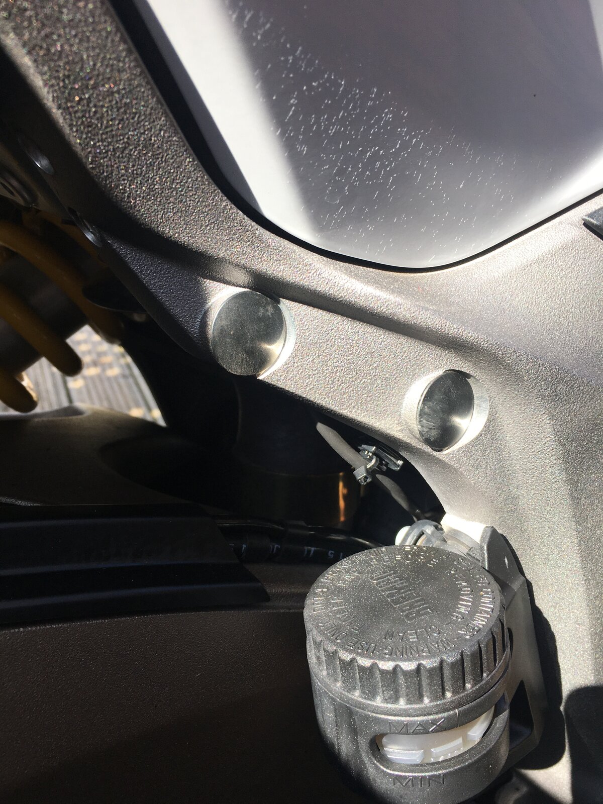

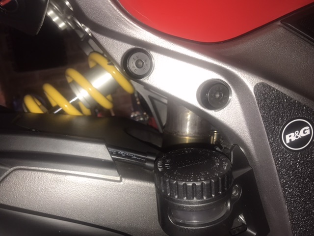

  6. Two pics of actual plugs
  7. very neat, I found some 20mm M8 dome head bolts I’m going to try

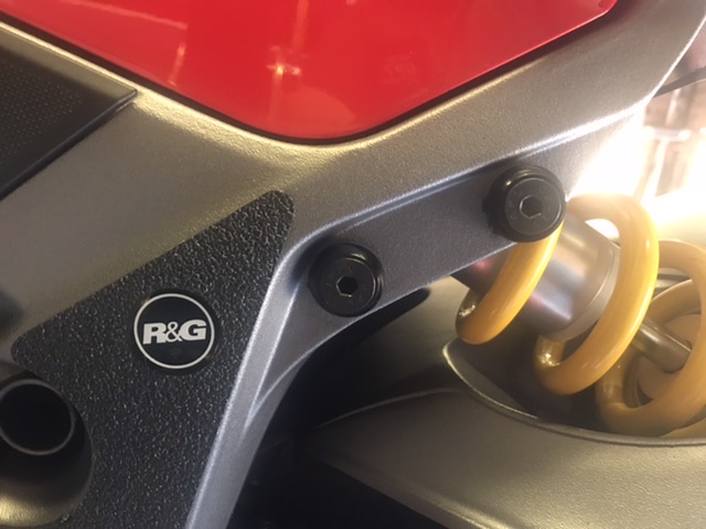

  11. F2D81EF0-5D9C-4189-A129-5A0A7C5003DB.jpeg C661B6A6-7E36-44F1-8622-613B2D709E76.jpeg
    Baby D
    My solution, bought in pack quantities, have two sets left in the for sale section
