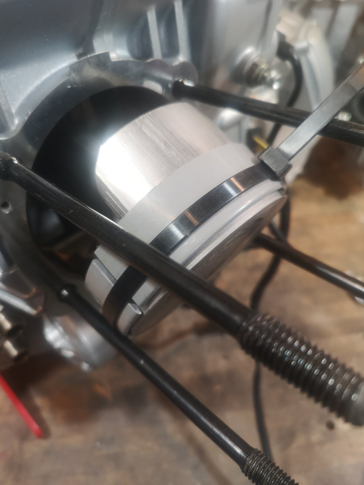

  3. I've always used a piece of grey plastic drainpipe tube... it's a really good solution in place of a piston ring compressor... a plastic PVC drainpipe cut down, with a large ziptie (that you then release with a very small screwdriver)...the fact that it is flexible means it's super easy to remove once the pistons are in the cylinder. :upyeah:
    (Barrel offered up just after photo - option B).

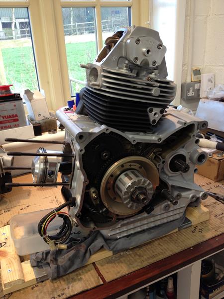

  10. I'm always looking at learning new ways of doing things. On these engines you have put the piston and rod in from the top as mentioned by @Robert Colliver earlier then tightened the bottom ends up?
  11. You can only remove conrods by splitting the crankcases. Unlike a car engine (or a Moto Guzzi*) where you can remove the sump to get at the rods and have to do that to remove/refit the pistons.
    M900 engine before fitting front cylinder:
