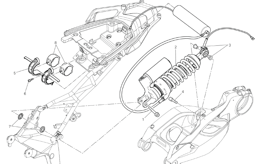

  1. Adjusting my chain the other day noticed a small amount of movement in the swingarm ( up and down ) after looking into it it seems the top shocker mount has an amount of free play in it ? For me that's an mot fail but according to ducati it's ok ? Looked at a brand new bike there's a small amount a second hand bike with 4K on it and it's the same as mine ! Anyone else noticed this because I don't fancy a bill for a new rear shock when warrentys up and it's not time ..

  12. There is no bush at the top mount. It has a fork which is bolted directly to the frame with 2 plastic spacers.
    Last year I replaced the the bottom spherical bearing in the shock from my (now sold) 2010. The fitting is exactly the same and there was no play at the top mount. If there is play either the bolt isn't fully tightened or there is wear in the plastic spacers (7).
  13. that's handy I might just strip it myself for my own piece of mind .. ducati did say there's nothing wrong and it seems some have play and some don't ? Thanks for the exploded view though !

  18. Of course there is a ball joint in the frame, look at nr 2 in the frame drawing
    http://shop.oemducati.com/en/products/multistrada/2012-1/multistrada-1200-s/frame-213
