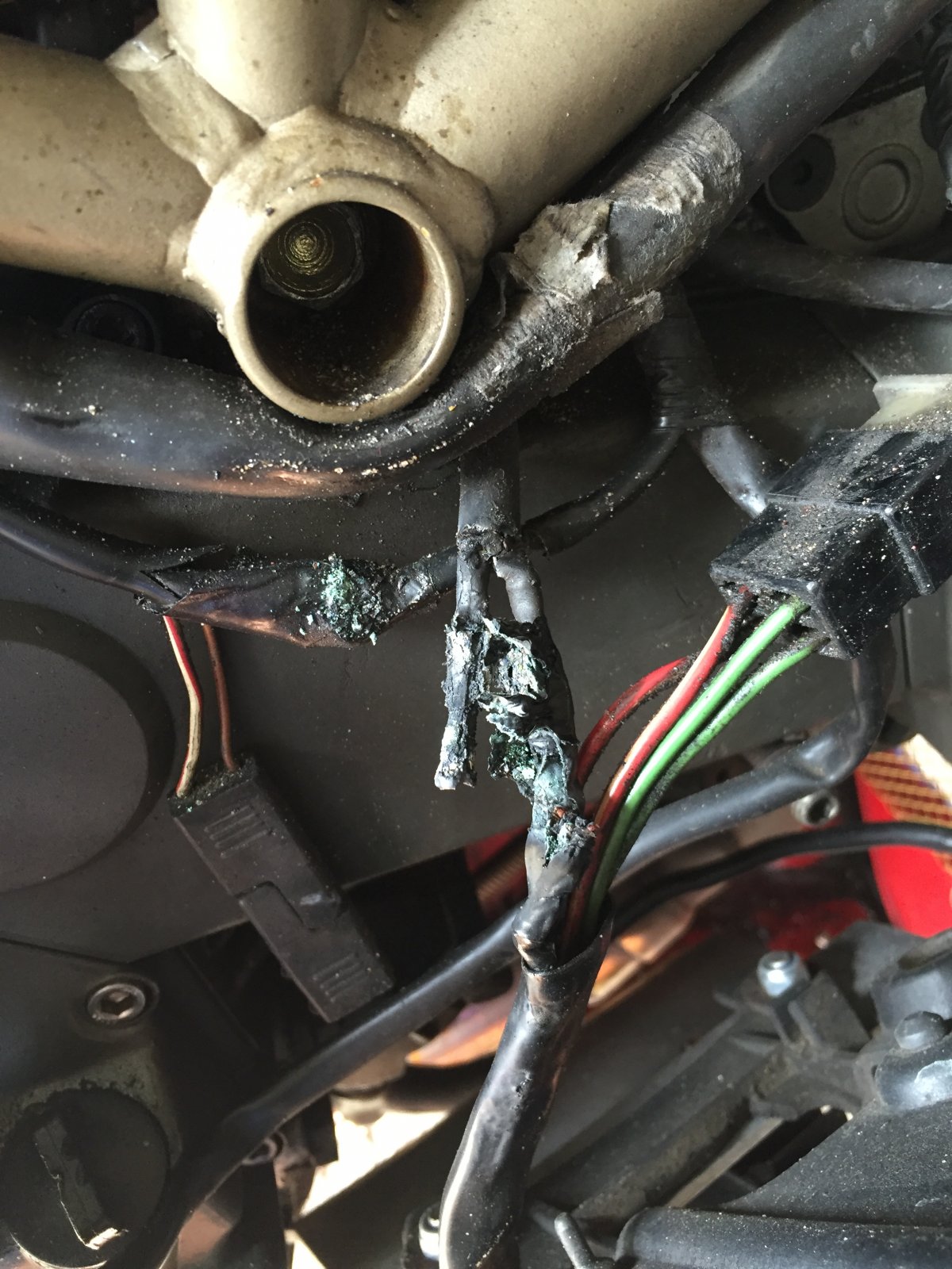

  9. Ok so finally got around to having a poke around the 748. Stripped off the battery box and found that the two wires from the Reg/Rec had disintegrated. (Picture posted below)
    Thought great, quick cheap fix and soldered some new wire in. Recharged the battery and put it all back in today. Went for a ride and she ran beautifully during general driving. Whenever I came to a crawl behind traffic or approaching junctions and the revs dropped off she just died! Started ok and got her home after a few times of it doing it.
    Played around with it and found that at idle if I blipped the throttle to only about 2000rpm she would die when she came back down to idle.
    Is this problem linked or is it totally seperate? Could the Reg/rec have failed spiking the voltage and melting the wires and still need replacing?
  10. Rec/reg fkd. Get digi multimeter across terminals when running to confirm. Anything less than 13V is no go.
  11. Yeh you were right, voltage didn't change at all when the revs were increased. So will change the reg/rec.

  13. Tans, you are buying a replacement regulator rectifier which is probably the least reliable part of your bike and most likely means to cause a breakdown. Get the correct regulator (with two yellow wires not three) and make sure the connections are very tight and very clean otherwise you will be replacing it within a few months. They can melt holes in your battery if they fail over voltage or simply stop producing dc if they fail to low/nil voltage.

    Ok replaced the reg/rec with the correct one for its age. It wasn't OE and considerably cheaper but it was the right one nevertheless. Changed it and went for a ride, managed 40 mins of it running fine then and put it away. Got up next day and rode it to work, pulled into the petrol station with it running nicely. Went to start it and nothing, battery was dead as anything.
    Got a local garage to recover it but they are now baffled. They can't find the fault, they are getting a reading of 22v coming off the reg/rec and don't know why? To be fair to them they don't usually deal with Ducati's but a bikes a bike right? They are speaking to a specialist Monday but it's starting to get expensive so any clues guys? Could it be that I just need an OE reg/rec?
  15. Hi Trans,
    22v from the reg rec is way too high. where did you source the part from?
  16. Looks like you still have reg/rec problems, as yours is a single phase bike it should be charging the battery at around 13.5 anything over 14.5 to 15 is overcharging on the single phase bikes. It looks like you may have cooked your battery as well if it is now dead unless you have burnt a connector somewhere.
    Steve
