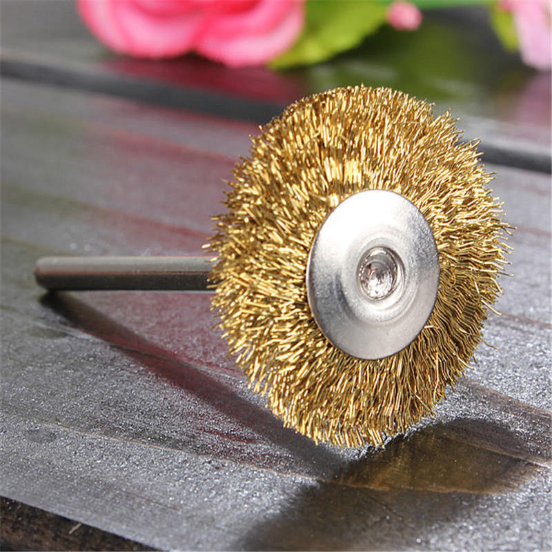

  5. please make sure you use glasses with that wire wheel as it throws bits off:upyeah:
  6. Agree XH, but no where near as much as the steel ones, they are shite, the brass ones are softer so flex rather than snap and fling into your face :upyeah:

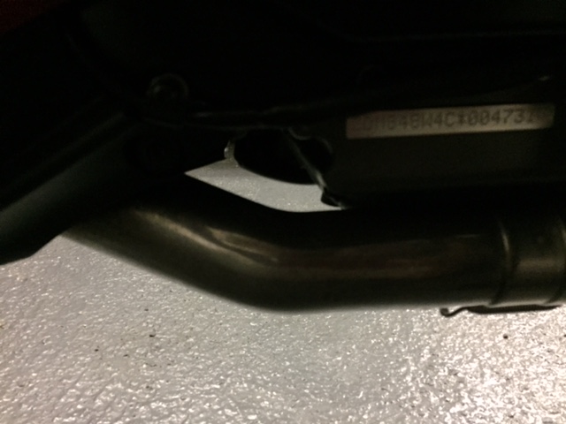

  8. Evening All, saw this post and raided the missus's cupboard cos she had some! a typical shite pic from me but having spent all day jetwashing in the rain the patio etc I needed some light relief so headed out to the garage and tried the stuff, my Austin exhaust is titanium but butts to original downpipes, so grabbed a brush put some on and left for 10, then with metal autoglym polish not solvol and a well worn Scottish pad I rubbed it off, it works well and removed the stains and browny colour on parts, so pretty simple and a decent result, for those tough downpipes without removing to polish you can get with little effort a better look.
    If it doesnt stop raining soon I am going to go nuts...

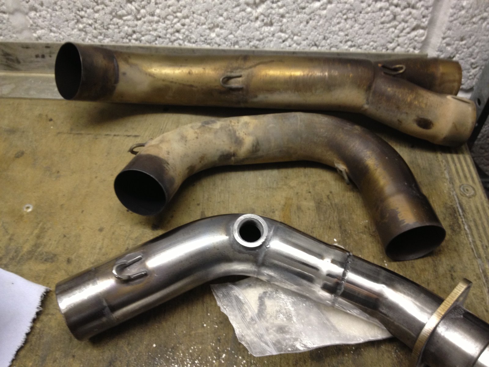

  12. 409BDF95-770C-46A4-82CF-DB34DFAD60B9.jpeg My last attempt, a bench grinder and polishing wheel

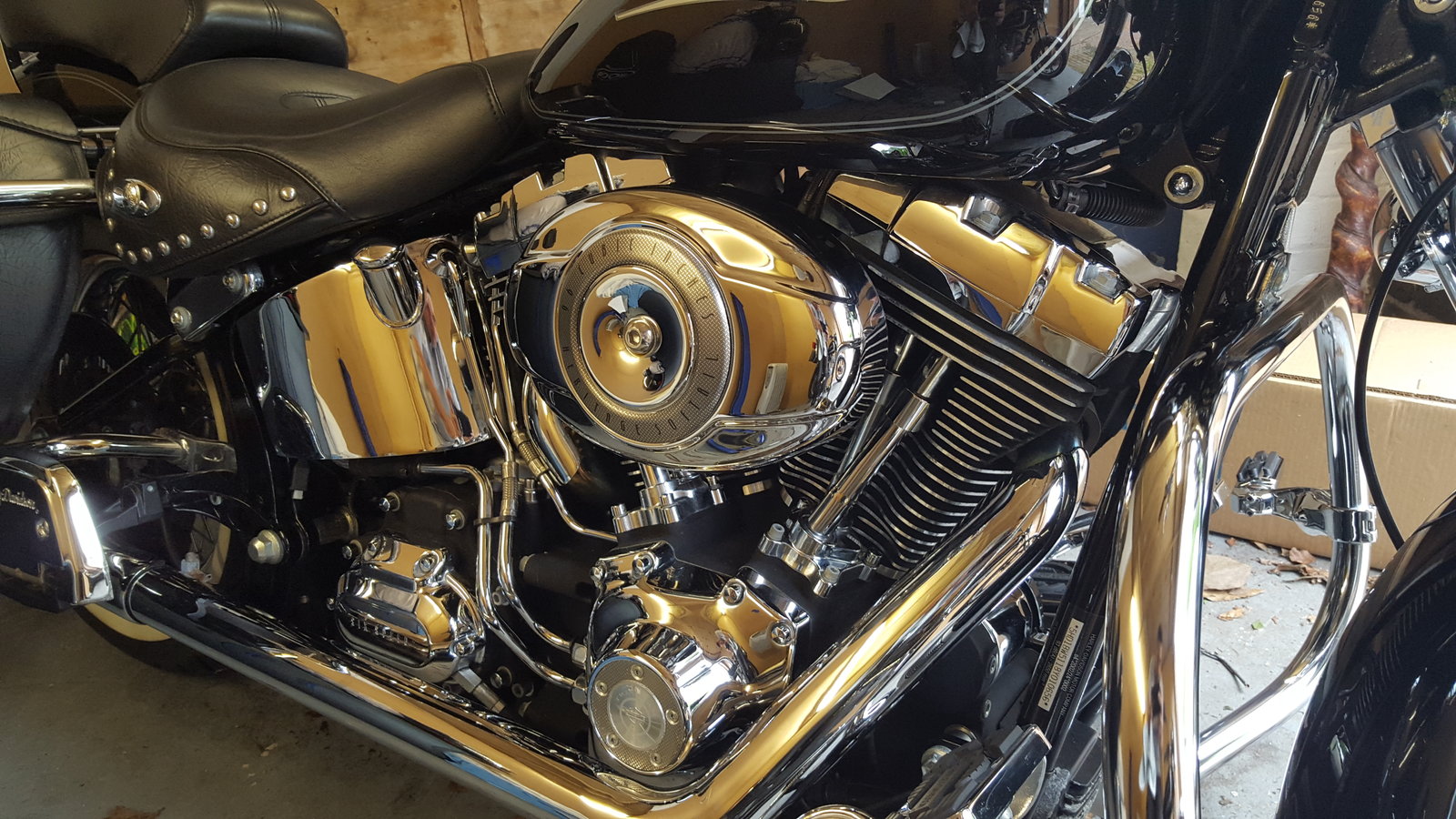

  19. On really rusty / heavily stained steel headers and downpipes using Harpic really will make your job far easier and quicker, be warned though it contains Hydrochloric Acid, making sure you wear gloves and goggles goes without saying, but also make sure you cover any other parts of the bike you wouldn't want it touching etc. Doing it once is fine but I wouldnt recommend using it regularly.

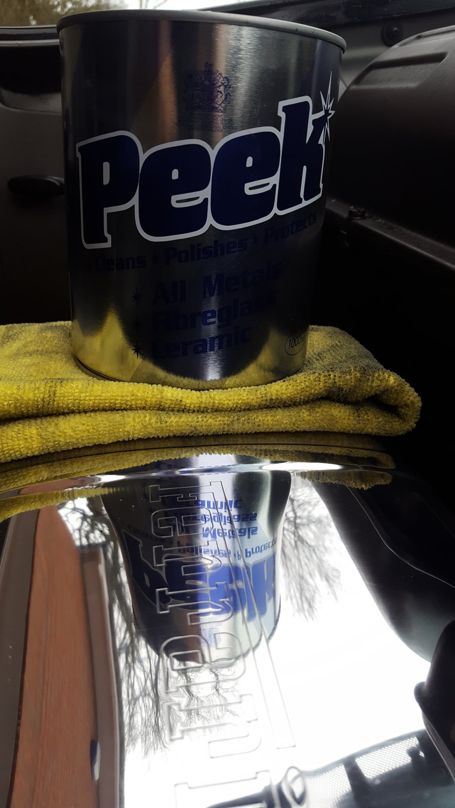

    Once done then polishing them to a stunning shine using the usual Autosol (which I also use regularly) or I also use a couple of other metal polishes that yeild superb results but aren't as aggressive and great to help protect and maintain the finish..
    Peek metal polish is awesome, Sometimes available at Costco around £13 for a huge pot applied by hand or by machine gives awesome results...
    Another highly recommended metal polishes are known as the Britemax Metal Twins,
    These are liquid polishes and once you've used the more aggressive polish the fine finishing polish is also a sealant so helps protect your hard work, it's a great alternative product especially for maintaining the finish..Ive used this a lot on 100s of engines..
    These polishes are also great on other types of metals and finishes..
    Just my 2pence worth on a few other alternatives that are great to have, Once you've achieved the finish you want then maintenance is a doddle with the above metal polishes.

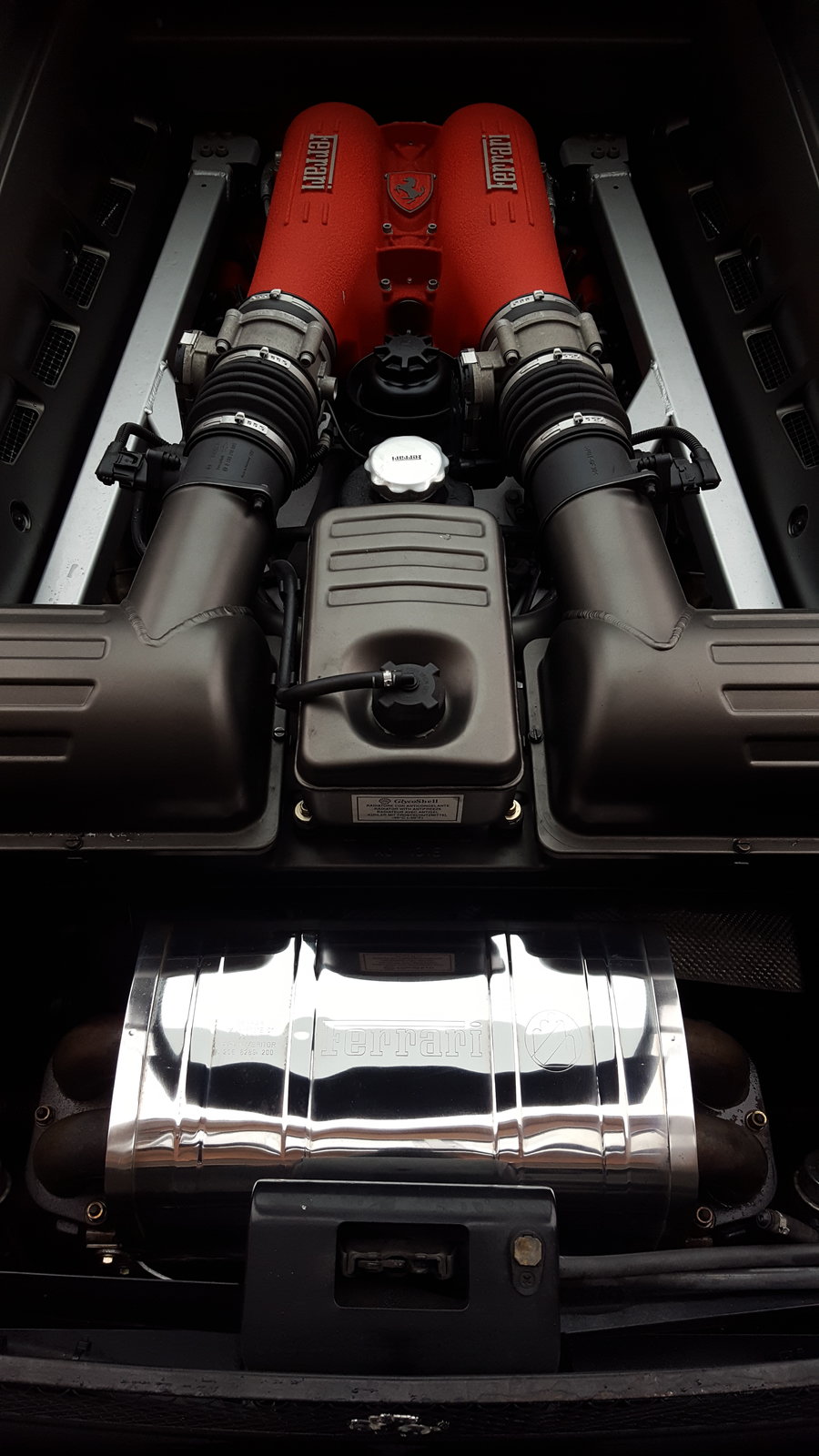

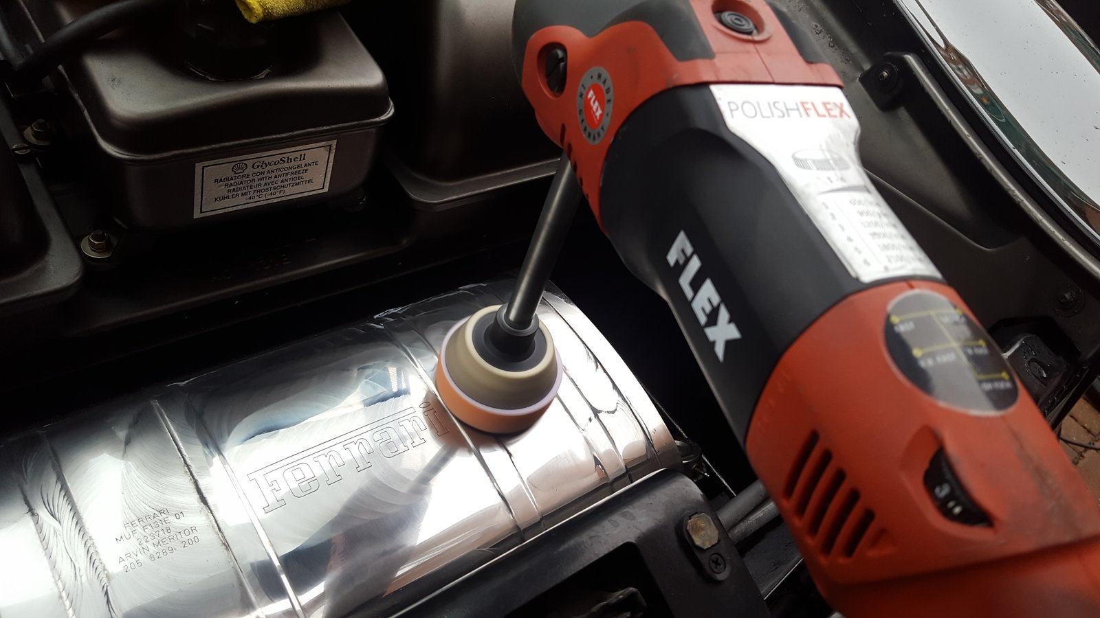

  20. @Hishine thanks for that - I just ordered some Peeks - I have never heard of it but your pics look fantastic. Only problem is I can't remember where I've parked the Ferrari
