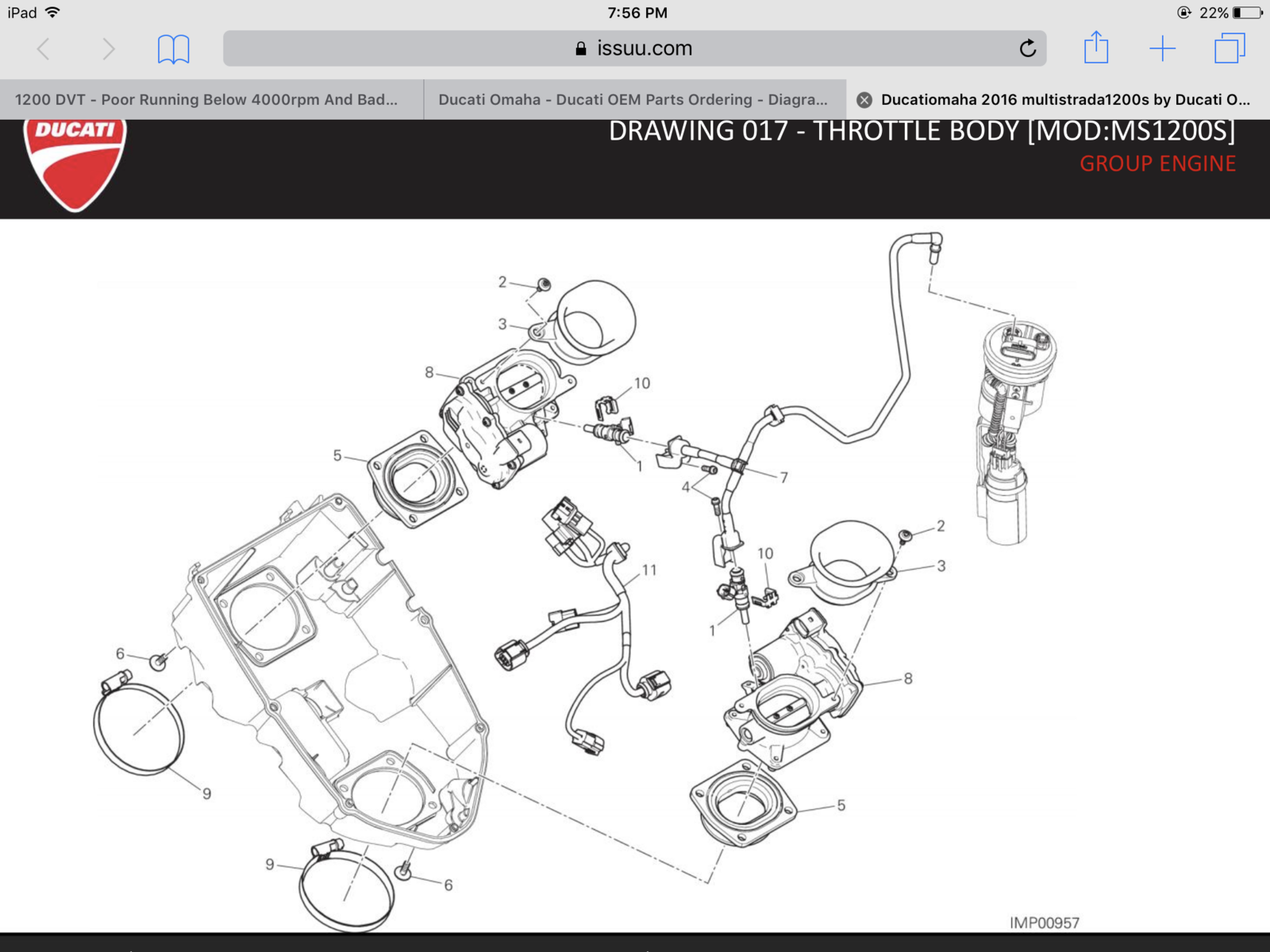

  17. MAP sensors are not in the airbox, both are easy to remove and check, my thoughts are still one of those.
  18. DVT is VERY different from what you are showing. Throttle bodies as well as map sensors are in the airbox which needs to be removed from the bike before they can be replaced.
    That loom, part 11, plugs into 2x tps and 2x injectors within the airbox. The two map sensors are screwwed into the bottom of the airbox and then connected by hose to the manifolds. It is extremely fiddly trying to do anything relating to them and cannot imagine how they could be detached without removing the airbox. The airbox cannot be opened without removing from bike.
