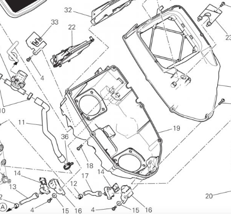

  1. Gotcha just looked, although only the airbox cover needs to be removed to access them, so a pain but not impossible.
  2. Sorry I was abit slow editing, but no, can't remove lid with airbox in bike. The workshop manual goes into detail about how to assemble prior to fitting or/disassemble after removing the airbox.
    I was shitting myself that I may need to replace throttle bodies, cos I priced them! It is not even a good financial descision!

  4. VALVE AISS???
  5. yes, I had a problem with a valve that takes in the exit of the cylinder that is called AIIS ¿¿??, which is used to inject cold air into the smoke outlet to lower the CO2, to me it stayed closed, they thought that it could be the valve of the exhaust then the cylinder sensors and after two months, it was one of the two AISS ¿¿?? valves, the failure that reproduced, was the erratic relenti sometimes, and at certain moments of the acceleration, it seemed that no current came to the spark plug and it was like drowned, then after a few seconds, accelerate normally again. It was very difficult to find the fault, because it is not constant
  6. Ok thanks Chuki, I will research but I have a feeling this is only for north american models...
