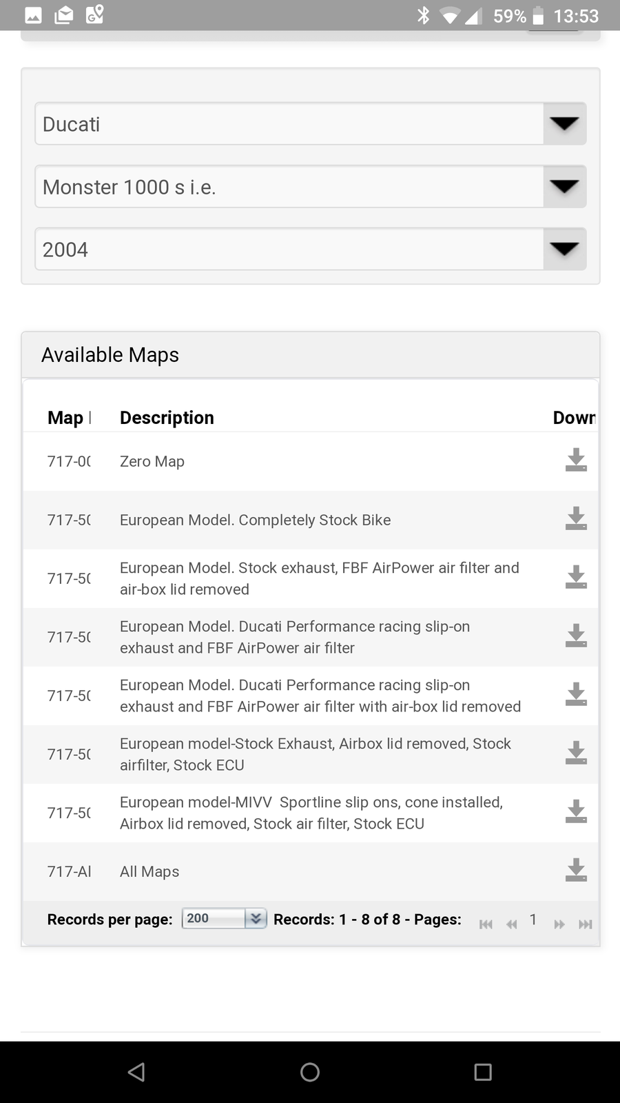

  3. All sorted and running well now. We downloaded the 717-503 map from Dynojet, loaded into the PC III and it seems to be suited well to my BOS slipons and free flow panel filter, retaining the air box lid. Throttle response and mid range improved, really pulls hard through the gears. Now going to try removing the db killers and change the map. Screenshot_20190824-135314.png
  4. Thanks for the info, could probably do with a bit of time on the dyno to fine tune the map, need to find someone a bit closer to me in South Wales! The range of maps from Dynojet is a good starting point.
