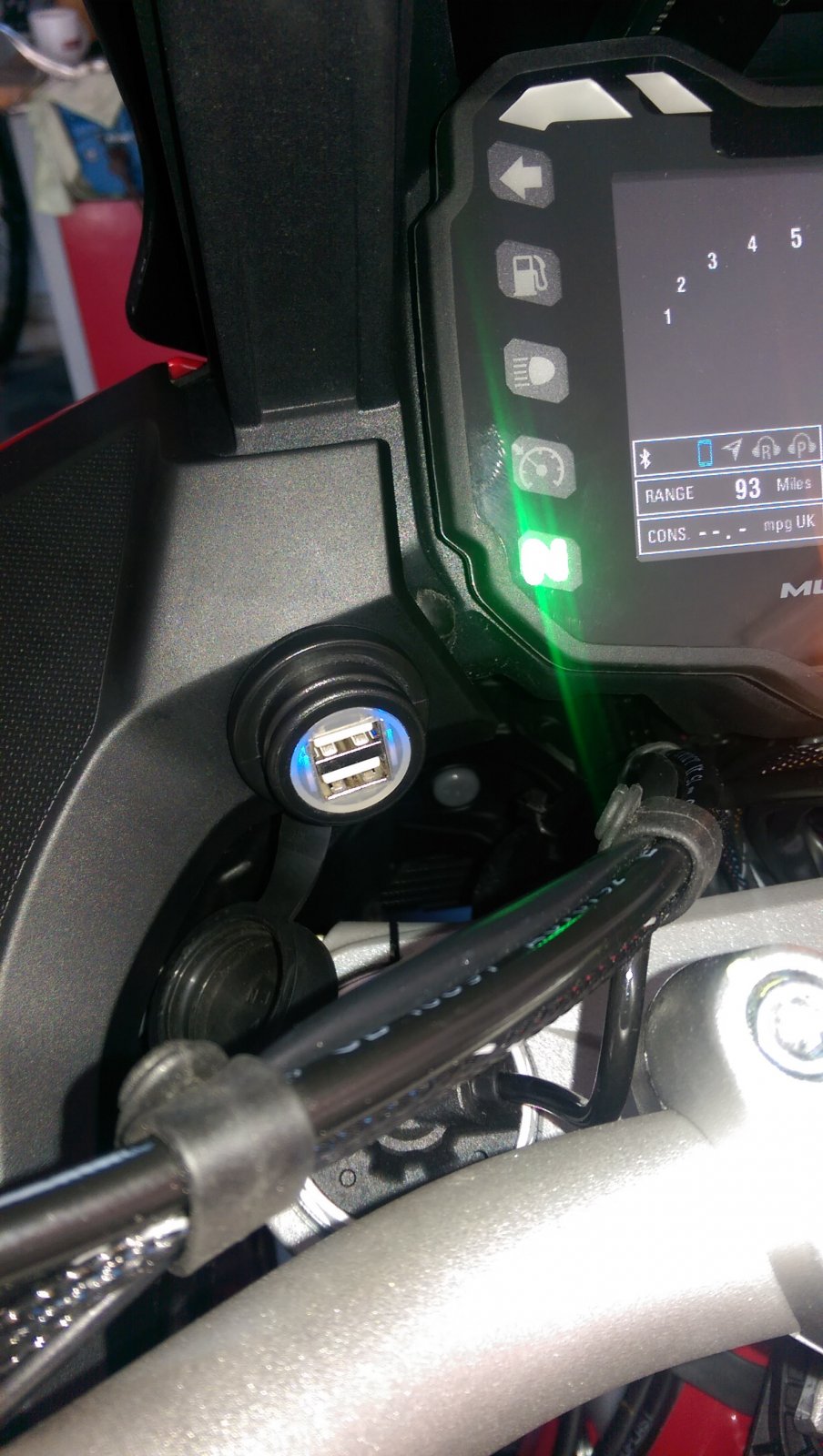

  1. If like me you don't like the din socket with adapters needed for usb etc connection of sat nav wired direct to the battery (a no no for me ) or just want a usb socket up front to power sat nav, charge phone etc...read on.

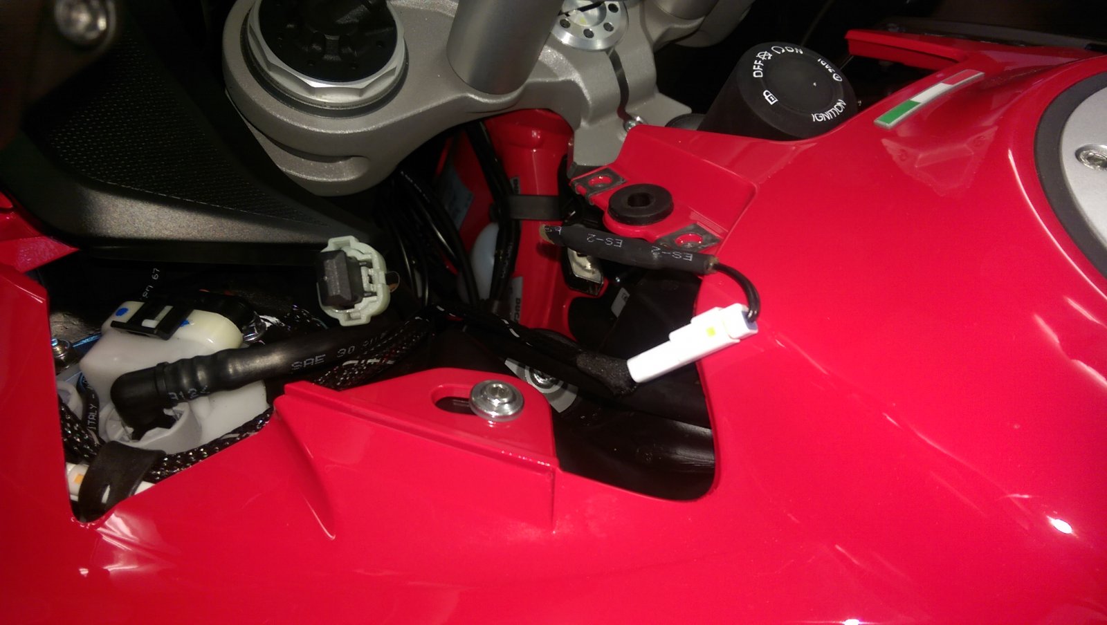

    The same spare power lead I found on the 2015 model as previous models only in a more hidden place!

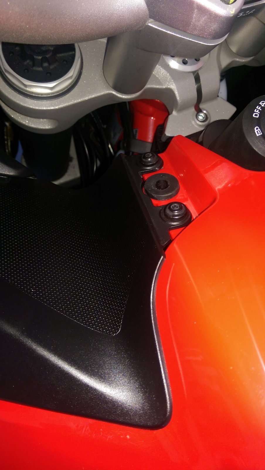

    First remove the Unlock Recovery System Cover located on the tank, by simply pulling off in a upwards direction.
    Once removed you'll see two allen key screws, remove the two screws from the plastic "Ducati Logo" strip and simply push this strip forward away from you towards the front end. IMAG0320.jpg

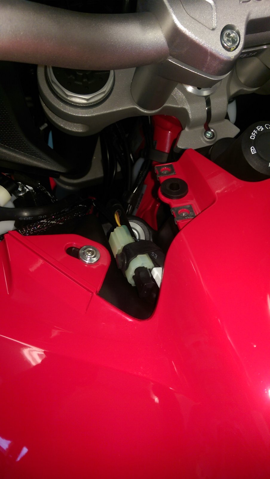

    Once removed you'll discover a set of wires with blank plugs..its the small white one you want.
    Jobs a good un.

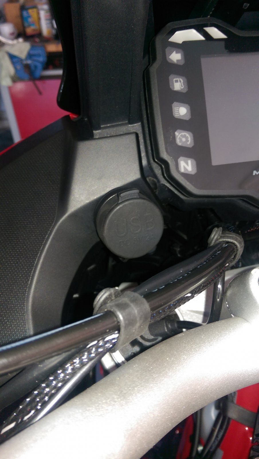

  3. Either or I'm using the white plug as power to usb socket from which I can use a usb cable direct to sat nav without the need for all that loom that Zumo give you plus I can charge other things from there if need be.,however yeah if using the Zumo wiring loom you can connect it straight there too. I'm just going for a different mounting option for my Sat Nav than handle bar affair.
